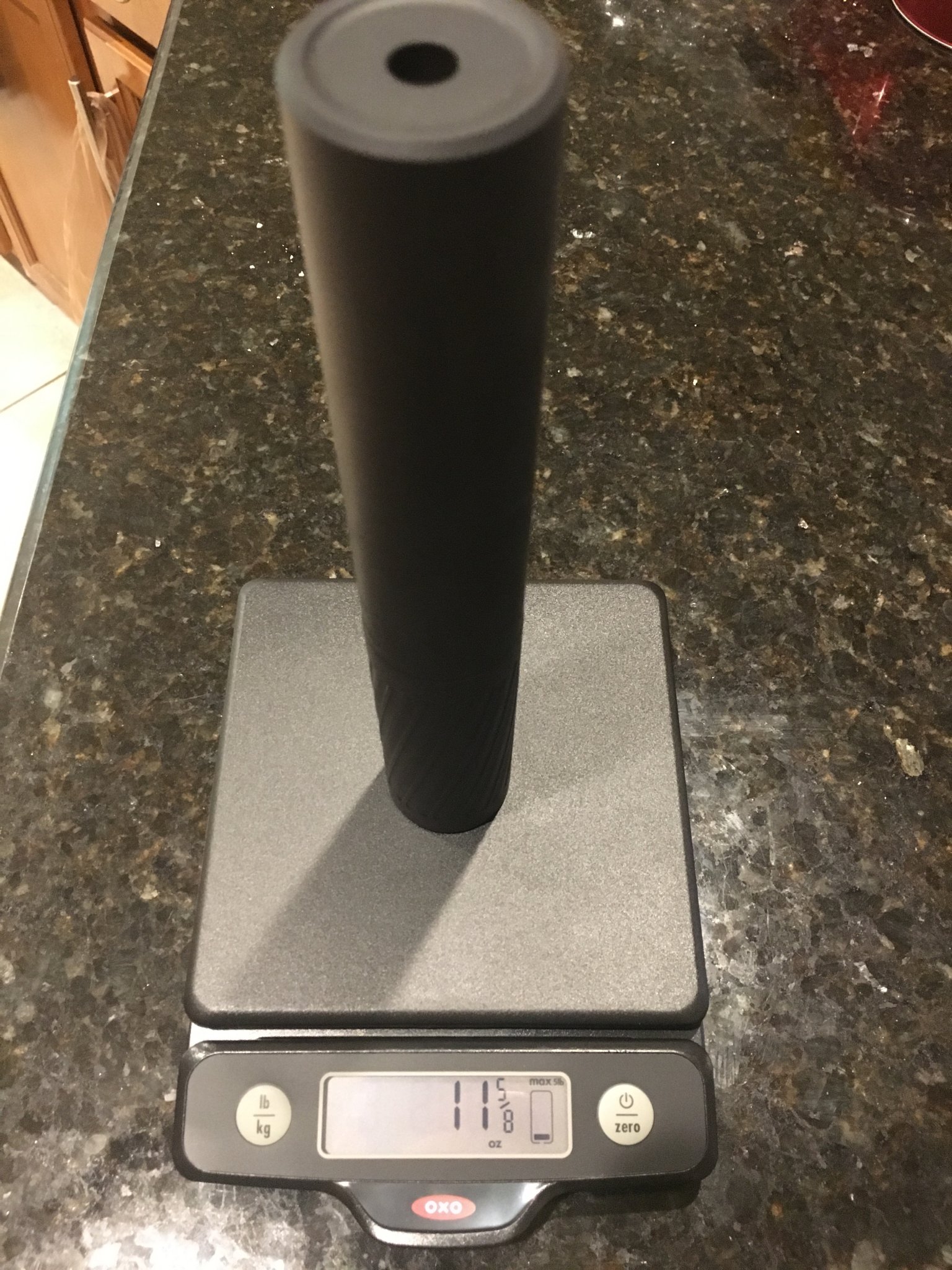

New unfired Ultra 9 weight 11 5/8 oz

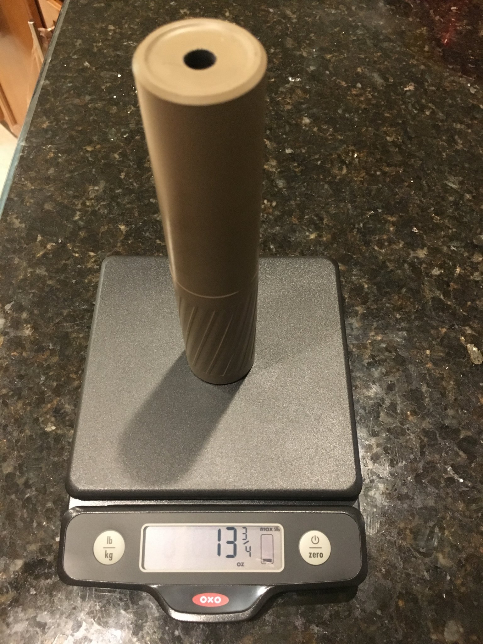

Ultra 7 after approximately 5000 rounds of 308, weight 13 3/4 oz.
Weighed on 5lb food scale. Totally unscientific method.

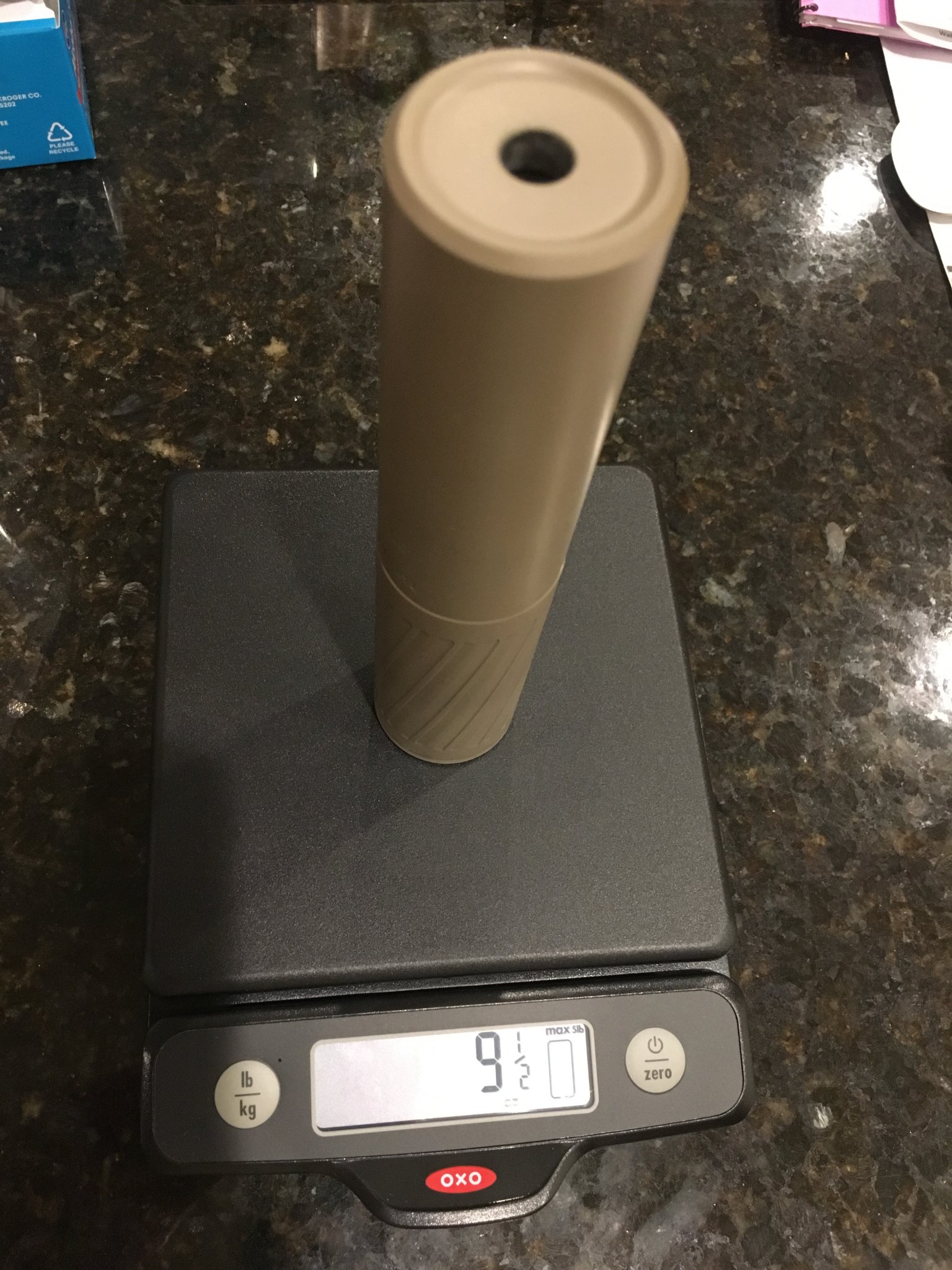

After months of soaking its finally back to new weight specs. (my previous post shows the weight of the Ultra 7 after 5000 rounds and new Ultra 9 for comparison)

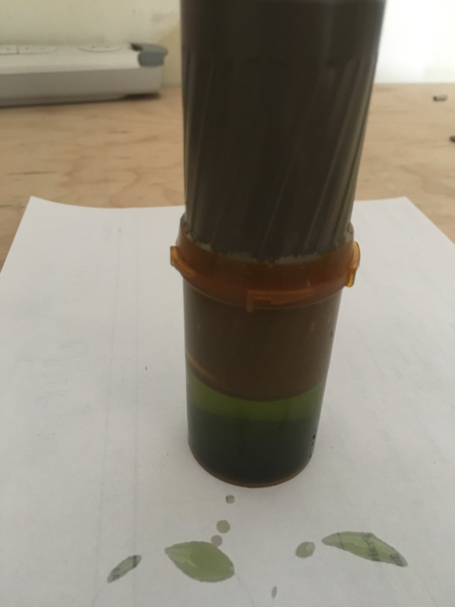

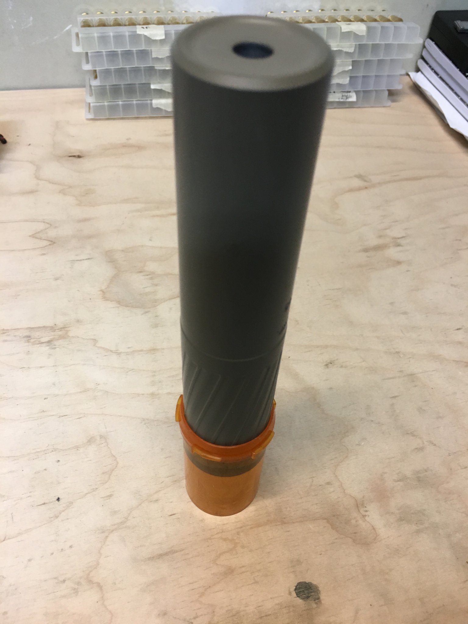

Soaked with CLR and CVS pill container
Soak until CLR in pill container gets a good amount of carbon, rinse with water, weigh and repeat process.
The lesson I learned from this is don’t shoot 5000 rounds of 308 before cleaning, weigh often to check if cleaning is needed, and when its time to clean just send it to TBAC.
