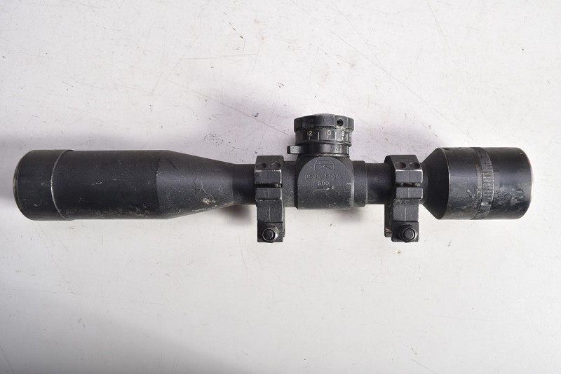

Hi Everyone,
I have gathered a lot of information about precision shooting over the years from this site, and finally joined today. I was an enlisted US Marine from 2002-2007, and used the GI Bill to attend college. I now work in the biotech industry in Souther California, and enjoy regularly going to the range with my wife where we shoot everything from handguns and carbines to my long range rifles up to 338 Lapua (Desert Tech).
Although I was not a sniper, I always found their equipment and operations interesting, I think it was my interest in precision equipment and shooting. Every since I read Marine Sniper in middle school, I was fascinated by the Unertl scopes. I actually called Unertl Optics to see if I could buy one, this must have been late 90's and I believe it was his John Unertl's wife who said they didn't sell them to the public (not that I could have afforded one if they did). Whoever I spoke with was kind enough to mail me some catalogs which were just paper copies of their available scopes. I always thought part of the allure of the scope was the fact that you couldn't purchase them.
I've been keeping an eye on the CMP Unertl Scopes for a long time now, and had decided I wanted an original (non US Optics Modification) 50 Caliber Scope. They have not come up recently at the auctions, but when I saw SN 5001, I went for it. Besides the modified 30 Caliber to 50 Caliber conversions, I believe this would be the first scope in the series, since the 30 Cal Scopes started at 1001, can we assume 50 cal started at 5001. Can anyone confirm?

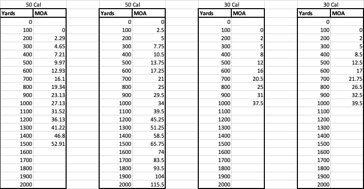

After some searching, I was able to find some information about the BDC. I found two tables for 50 cal, and two tables for the 30 Cal scopes as well. What Is really cool is that I believe if I were to zero this at 300 years, you could use the BDC and fine adjustments to be on target from 100-500 yards based on the numbers I saw and calculations I ran. I'm not sure if I will build a clone M40A1, hold off for a Barrett (416 for CA) or put it on something else, but for not I have it on our mantle.
I hope I get to know some of the members here, and can both contribute and learn from one another for years to come.

Congratulations on being high bidder on that scope! I say that as the 2nd place bidder. I already had sn 5003, so didn't want to be greedy, ha! Glad to hear it went to someone who appreciates it.
Your understanding is correct, I believe that the scopes originally manufactured for .50 cal started at sn 5001 and ran through about sn 5150 (the highest number the CMP has sold). The CMP has listed 87 of those ~150 scopes to this date.
To date they have also listed 57 - .50 cal scopes that were modified from .30 cal.
I understand that first 5 - .30 cal scopes were considered prototypes, with production starting at sn 1006. The lowest the CMP has sold to date is sn 1011 and the highest .30 cal sold by the CMP to date is sn 1913.
Don’t remove the paint! It’s part of the history.
Yes sir! That is my preference too. It looks like 5001 has been repainted black over other camo paint. A lot of these have several layers of paint.
I also have one with camo tape making a slot over the lens, I plan to leave that too.
5003 never had been painted although it has other signs of being issued. I guess wherever it was issued didn't need camo.

Wow, thanks for the compliment ODCMP. Crazy to know we were both bidding on this. I guess I’ll know who I’m bidding against if 5002 shows up, haha!
5003 is a beauty! It’s very clean.
I’ve decided that I will not be doing any kind of restoration work to this scope. I will have any work it needs done to remain serviceable, but I wont remove the paint or do anything to make it look nicer.
Cheers,
Matt

I am not clear on how you can use the 50 cal scopes for other calibers ie 7mm Mag , 338 lapau etc….
I see the two charts for each cal. Noted above. What does the two for each caliber represent?

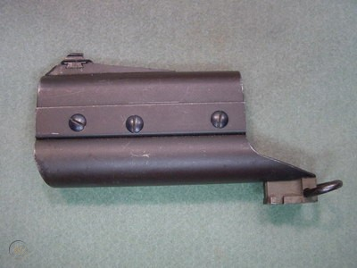

I recently won the scope described below, It is the first time I have put my hands on a scope like this, I have a copy of the original USG manual but could use some help.
US Marine Corps Issue 10x Unertl Sniper Telescope serial number 1324. This scope is in good condition with signs of use. It has tan and greencamo paint. The optics are clear. Knobs crisp movements. It DOES NOT have the USO modification. Scope does come with Badger Ordnance mounts - 0524.
1. The main elevation and windage adjustments work fine, the elevation fine-tuning ring does not budge, nor does the eyepiece focus ring turn with a good grip.
2. I plan to mount on an M1A or a Polytech M1s. Do you have any suggestions for a good mount? The scope does come with a set of Badger mounts.
Thanks
