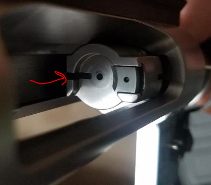

The rem700 wrench will work if it 1) has a clearance cut for the mechanical ejector that sticks out inside the action or 2) you remove the ejector first.
You can see how the bighorn bolt has the clearance cut into it, the action wrench would need something similar.
