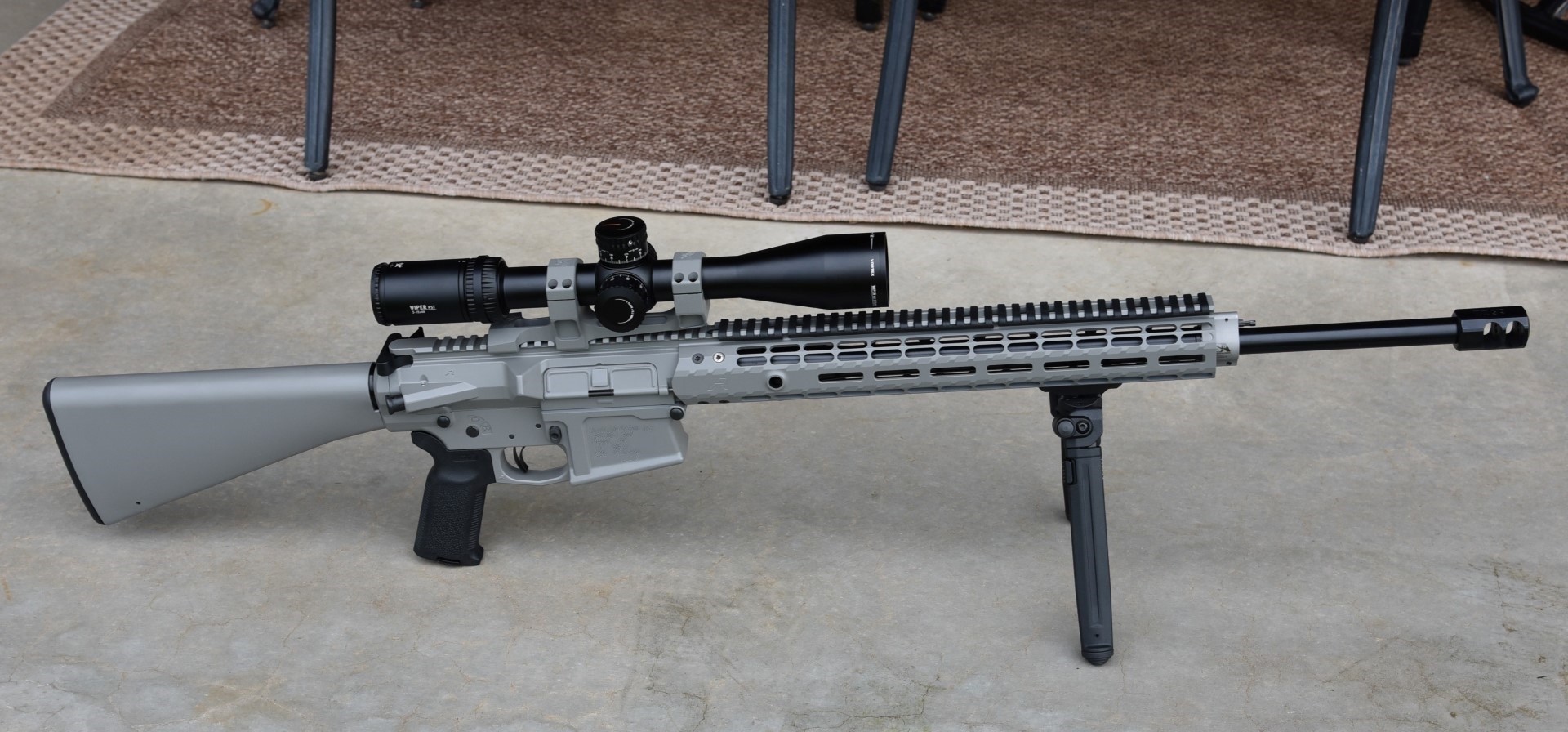

Ok guys, I’ve got it assembled. The scope is a viper PST II 3-15. Range report to follow someday...
Reactions: Billiam1211

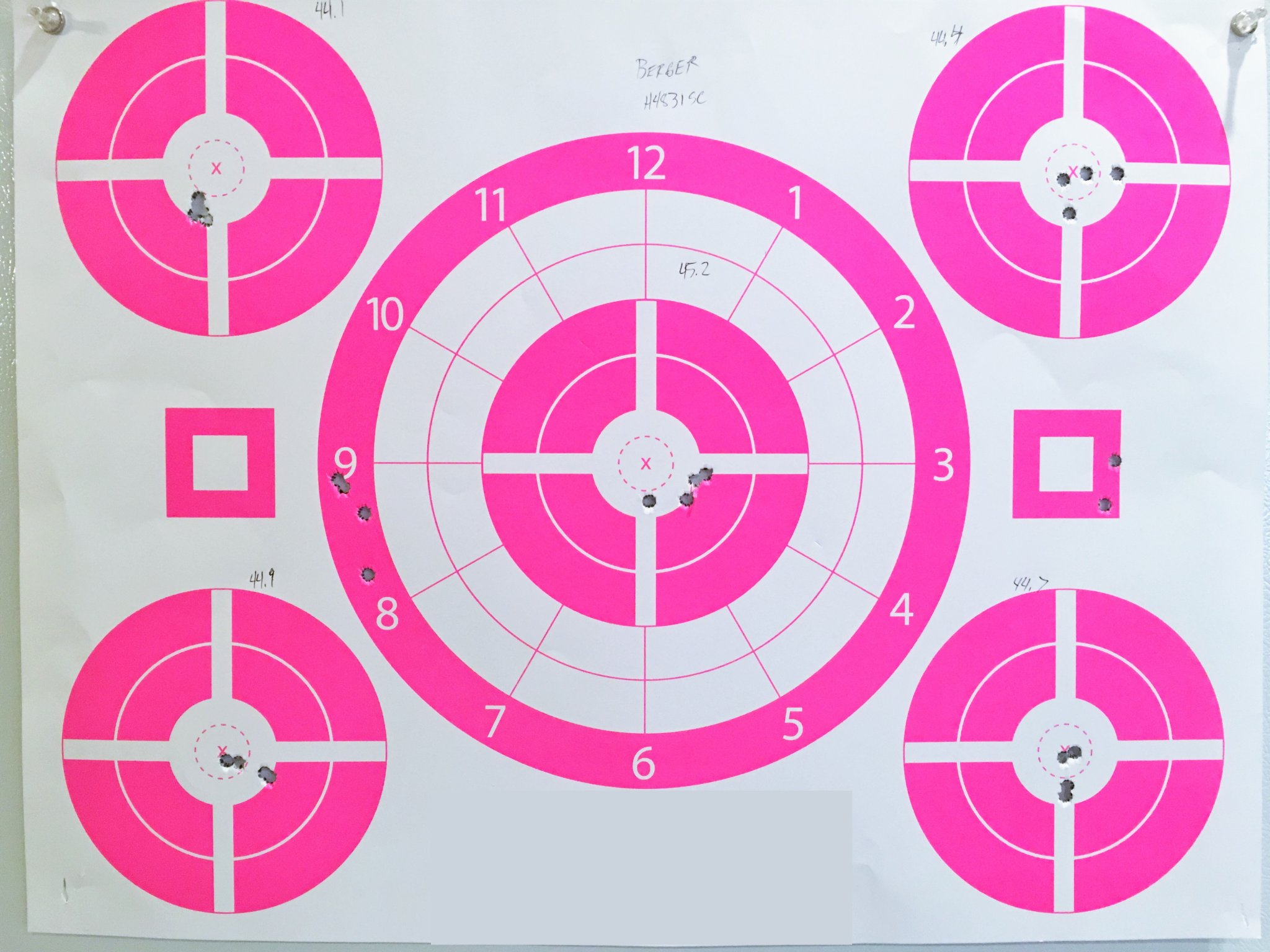

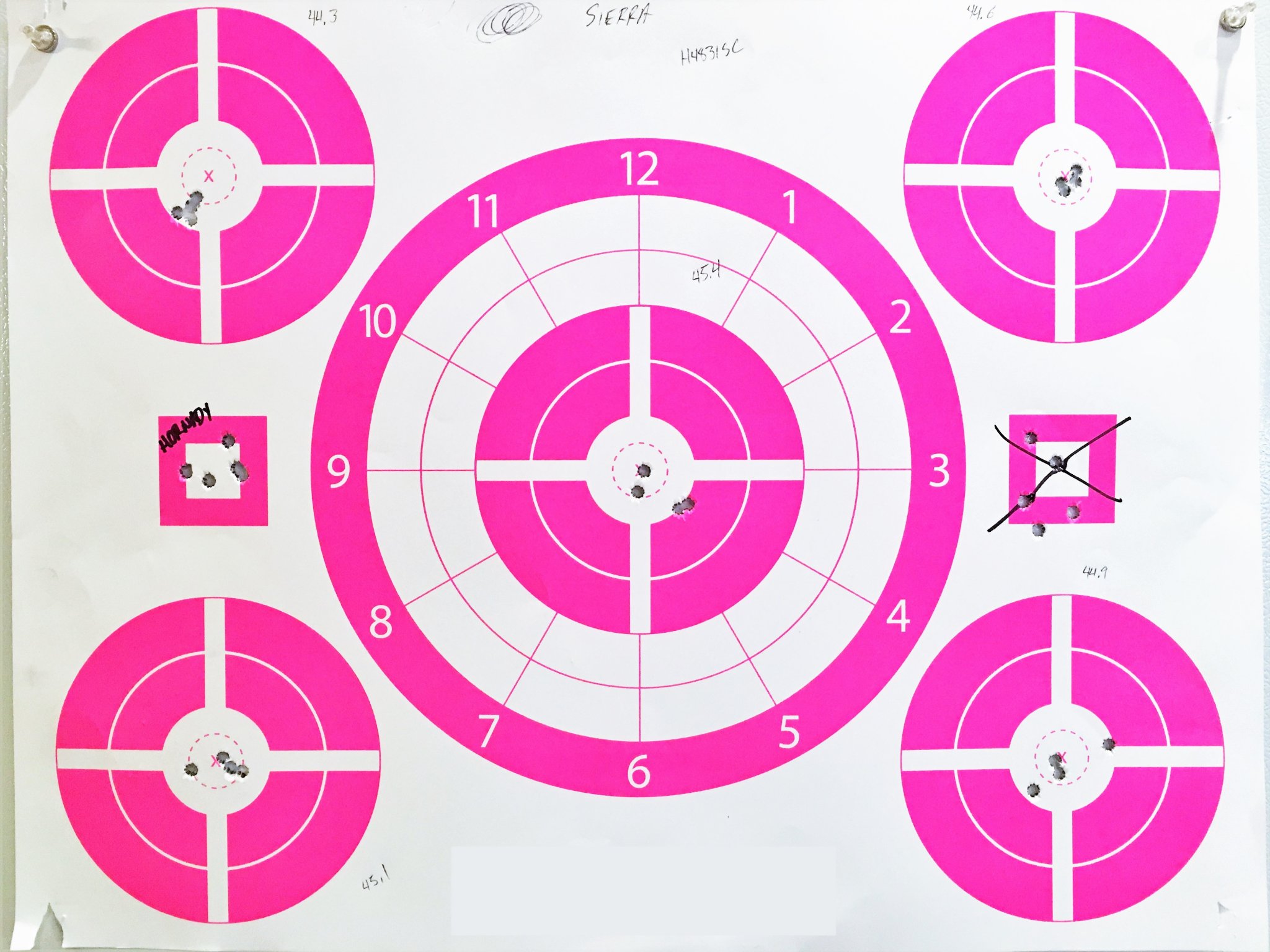

I've finally had some time to do a little bit of load development but I can tell I still have a ways to go, both with load development and shooting skills.
Bullets were Berger 130gr. Match/Target AR Hybrid and Sierra 130gr. TGK. Powder was H4831SC. Targets were shot round robin at 100 yds. The group marked "Hornady" is the Hornady 130 ELD factory ammo.
