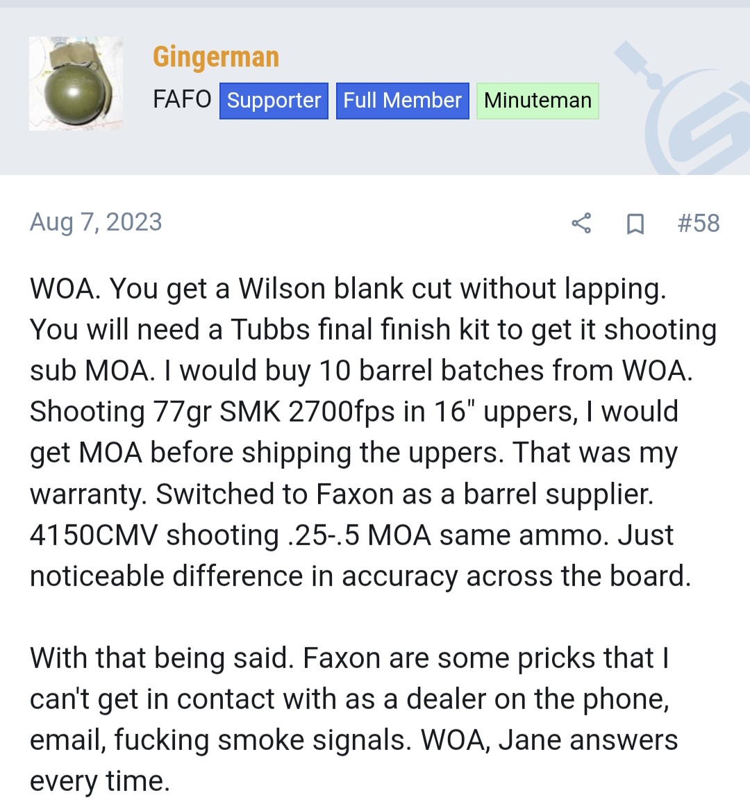

    @Gingerman You stated that you have a business of building complete Upper Receiver groups. I would be most interested in hearing about your assembly process.
    Yes, American precision arms Gen3 is what you seek, I run them on just about every custom Job I do. I've also used the Cortina adjustable MB as well but the jury is still out on that one.
    you can also use the APA MB as a tuner as well by backing the MB off one full turn from the bottom position with the ports at 12 o'clock and lock the jam nut coller, this will move the weight of the MB further forward changing the harmonics.
    APA MB screwed down to its furthest most position and then timed at 12:00
    APA MB backed out one full Rev and Jam nut locked in place.

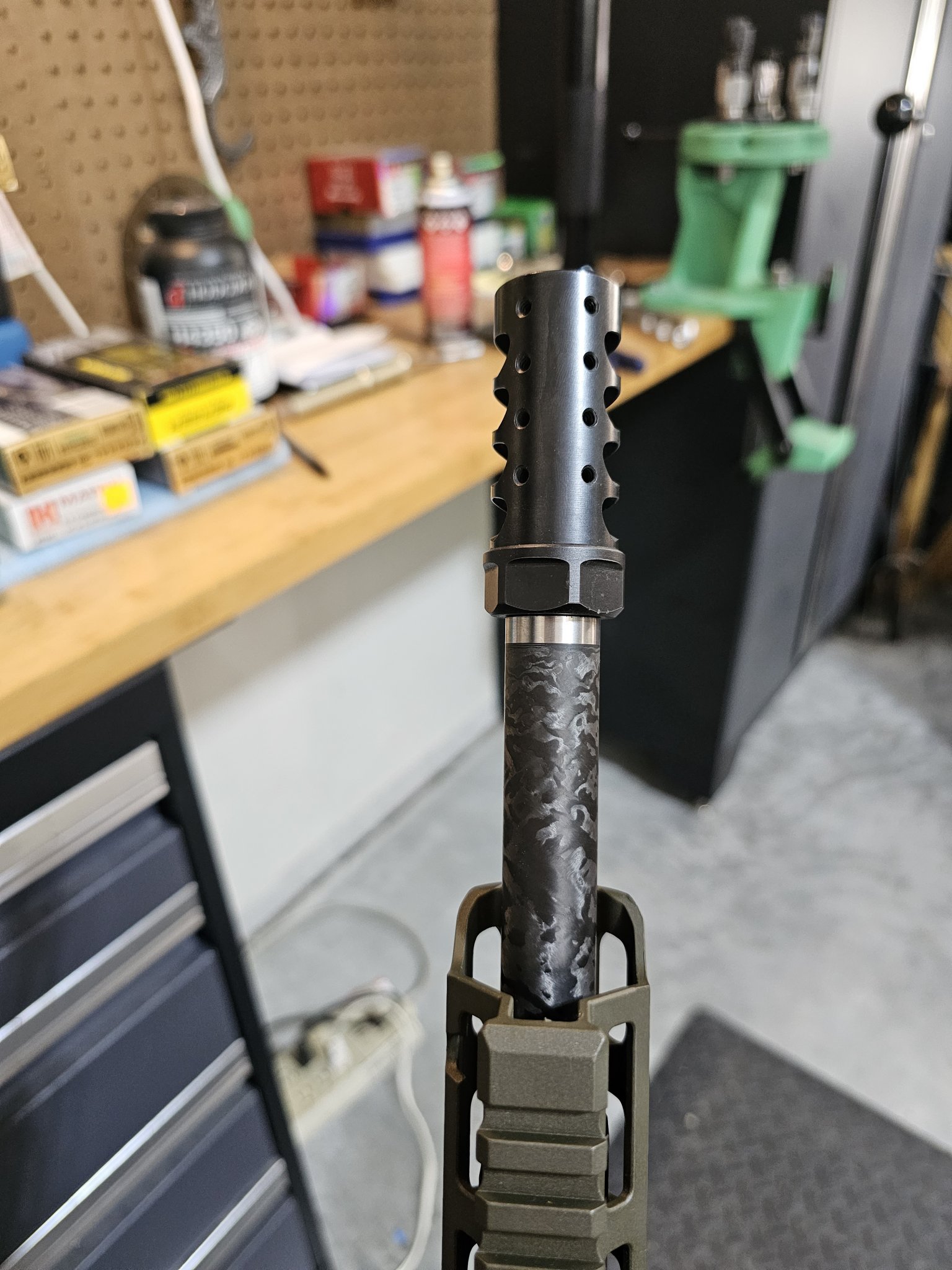

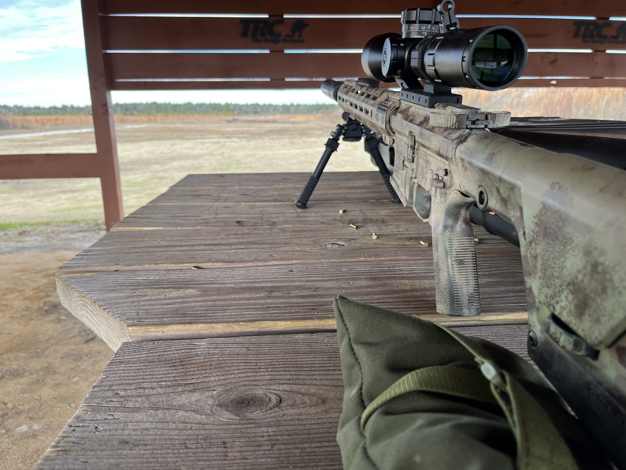

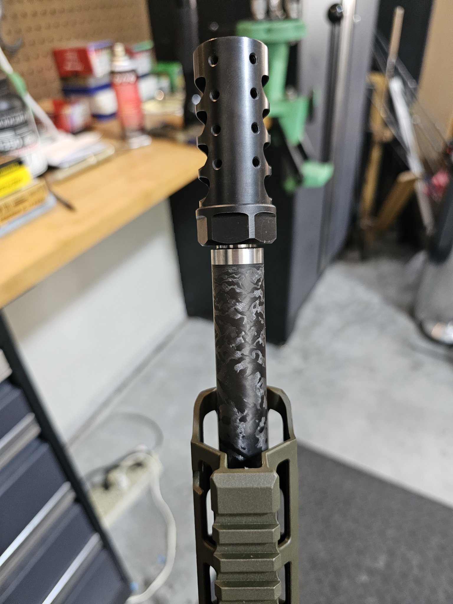

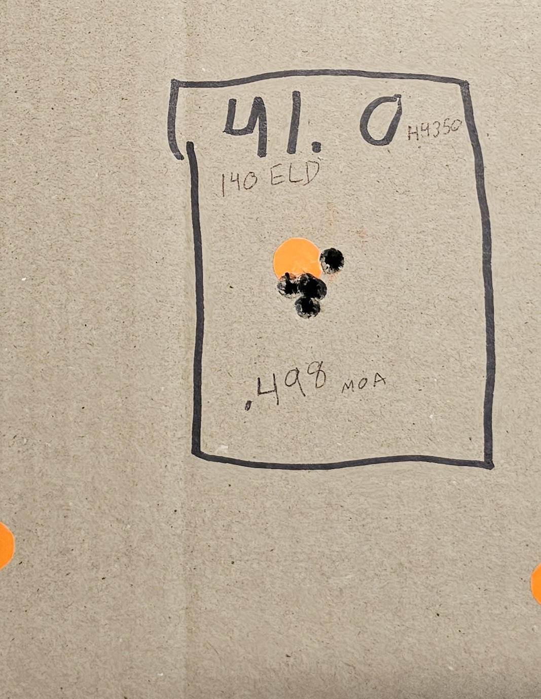

    I've just finished Load Development on a Custom JP LRI-20, the barrel has fully settled in and is consistently performing at Sub 1/2 MOA
    These two loads performed the best but 41.0 provided the lowest SD and ES, SD was 6. with 40.8 and 4. with 41.0 with 140 ELD's and now that the barrel has completely settled in its consistently averaging .3 -.4 so I will give it a try next time I take her out and post the results for better or worse.

    Jake…. Do you shim or loctite your barrels into your uppers? How about truing up the receiver face?
    No I don't use shim stock and hardly ever use Loctite, all of my builds come with custom barrels from Krieger, Bartlein Douglas..and so on.
    Whatever the receiver set of choice is I measure the inner diameter of the upper receiver where the barrel extension slides into and order the barrel extension oversized making the upper receiver a mandatory thermofit.
    And yes I always check to make sure the receiver face is concentric to the center of the bore line.
    Are you ordering specific sizes or providing the barrel extensions?
    I shim mine currently with no complaints on target. I dig ordering the extension oversized tho. How much do you order over the receiver id?
    When I spoke with Jake before making my order with CLE, he suggested the WOA extension. CLE pulled an extension for me but they did mention that WOA is not replacing them anytime soon, so supplies are limited - in CLE's house. A quick search shows that WOA is still making them, but I'm not sure if the "competition" (not sold by name) extension is now just called the "M4 extension". There are no details listed on the M4 extension page.

    I had a barrel built with one of the competition extensions a couple years ago. Barrel is a 18 inch Bartlein 1-7:7 that started life as a 20 inch blank in heavy service contour. Had one of the guys at a well known shop change the contour just a smudge, and chamber/thread it in 223 wylde. Build is below
    Mega ambi upper/lower
    Triggertech two stage
    Magpul Gen 3 PRS
    Tubbs flatwire spring/ standard a2 buffer
    Superlative Arms adj gas block
    Strike Industries Gridlock handguard
    JP flattop mount
    HDMR II 3.5-21 scope
    Reactions: xsn10s
