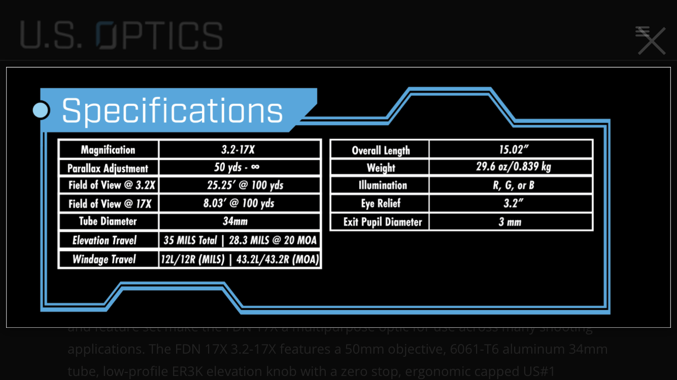

Given the unusual 3.2-17x magnification range, I suspect this is the same optical design as the USO SN3 3.2-17x was as well as the ER17 etc. After looking at them, do you think that is the case? I still have a few of the SN3's around since by brother and dad both use one and still use them as comparison scopes. I like the design and always have. I was actually surprised this past year to prefer the USO SN3 to an S&B PMII 3-20x50 that I had in as a comparison scope. The S&B was better in a number of areas such as resolution but it's CA was quite poor and so the overall experience with the USO was preferable. I suspect the S&B PMII 3-20x50mm model was not one of those done by the Optronika guys before they left. I expect this year I will run the old USO SN3 beside some of the ~$2k scopes I will be looking at to see where they stack up.
How is the FDN 17x performing optically when it is well off center? I see these are now listed with 35 mils of travel when the SN3 iteration was not even close to that so on the examples I have you cannot go anywhere near that far off of optical center.

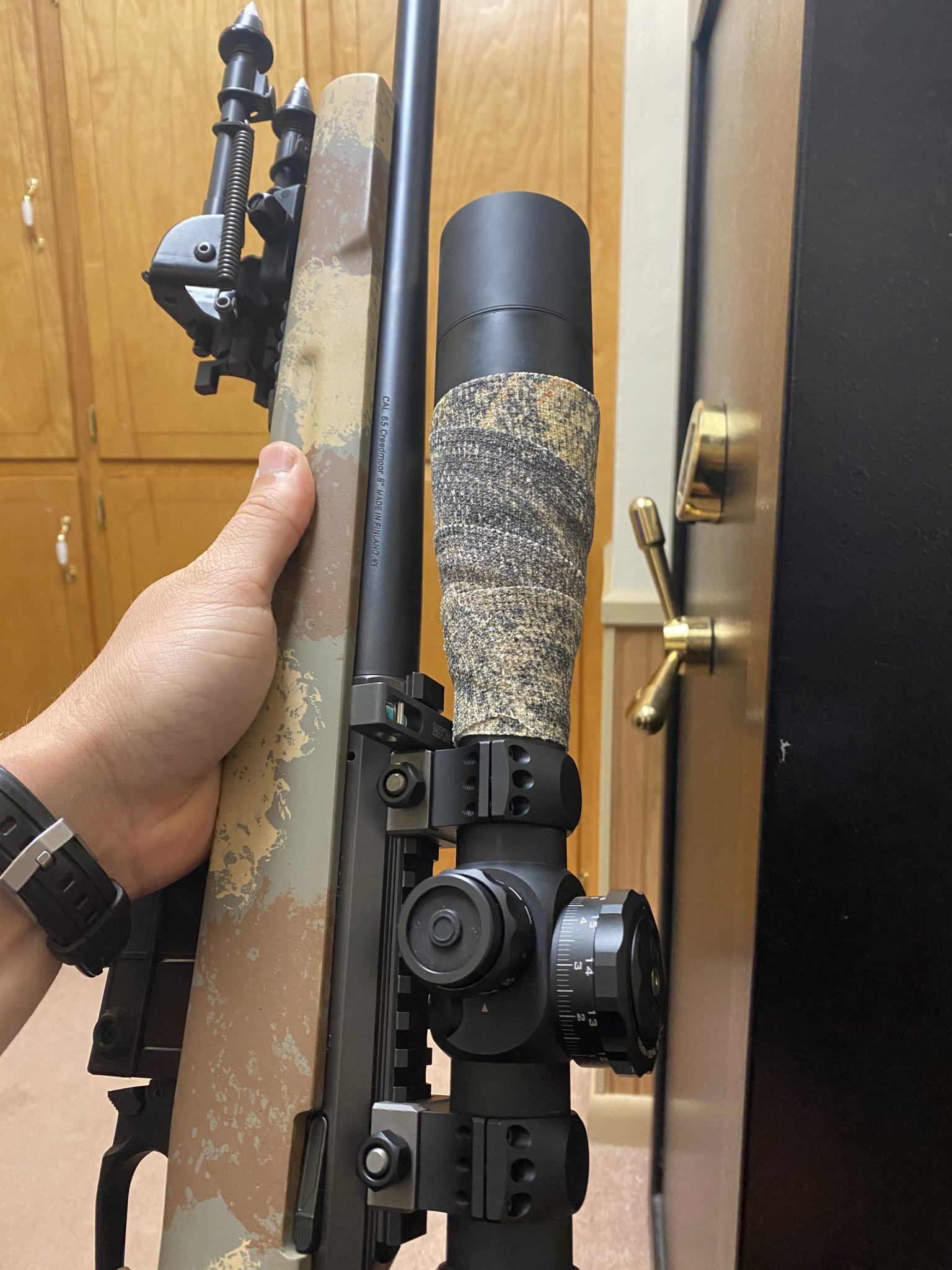

Annnnnnnnd....two days later from when we spoke, a custom FDN sunshade from USO
Best CS in the business in my own experience.

Anyone know what the minimum parallax on the 17x model is? I've got the 525, and the parallax doesn't go down to NRL22 distances. I'm wondering if the 17x does. I'll probably end up parting with my 525 for that reason, but I'd still like to run a USO if I can.
