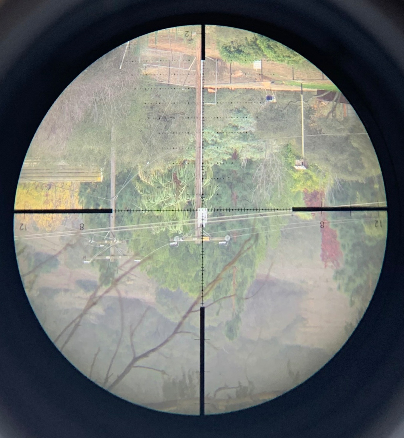

    Probably shows something like this
    On a more serious note, I'm interested to see if the Aussie version has the same FOV as US models. If it does, then we don't know if it's just the design of the scope or if tangent may be limiting the AFOV of all the 7-35 models for patent compliance and possibly not having to make 2 different models depending if they're US or non-US models like S&B does.

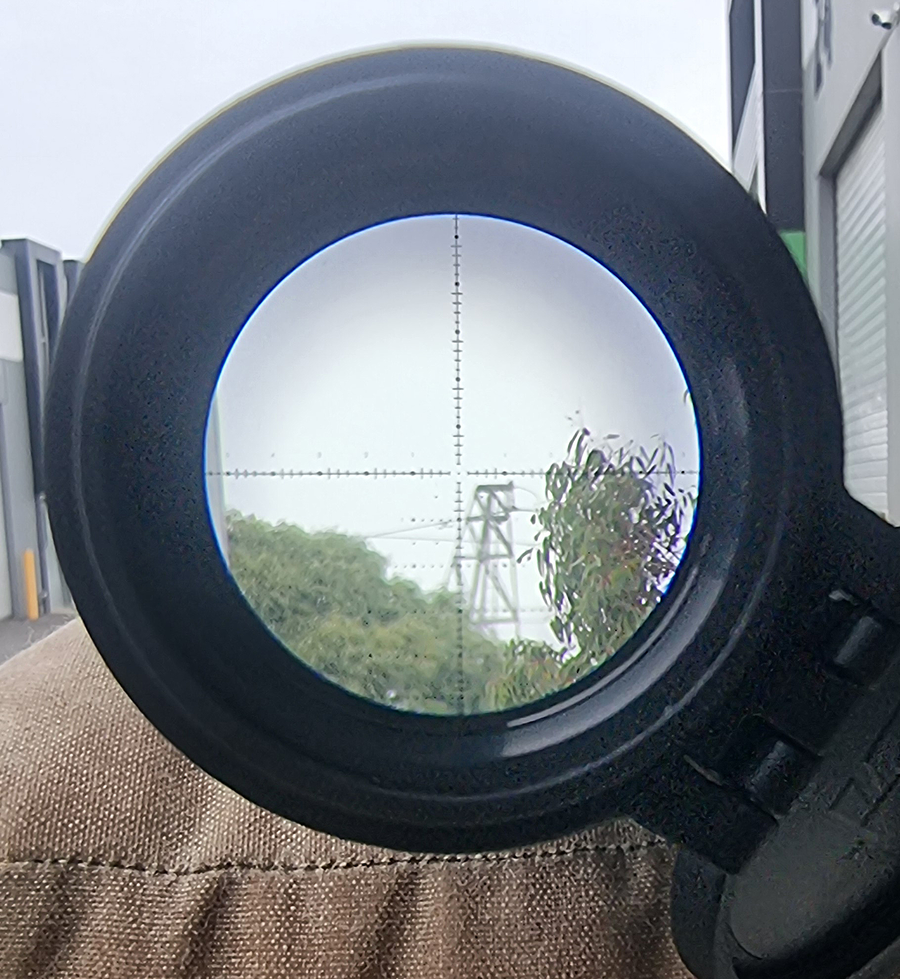

    Just on 5.6 mils
    A friend / Dealer just got some samples, he is bringing them up to me for a shoot and we will be comparing against the S&B 6-36 in field conditions ( ie shooting ) :)
    Pic is blurred ( my friend took this) but you can make out the reticle divisions.

    Just on 5.6 mils
    Pretty much same here.
    What does the Schmidt 6-36x give you?
    All 7-35x56 Tangent scopes, regardless of where they are purchased, are supposed to have the same FOV.
