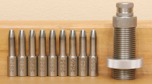

Or get a ~.262 mandrel and open just the necks a couple thou.
