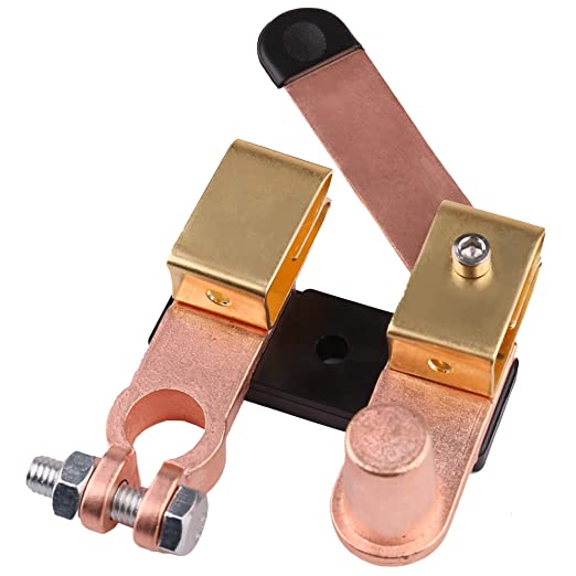

Don't use that on most modern cars, or all kinds of things go wonky, including your entertainment system bricking itself and such.
Many modern vehicles have computers running that never actually go to sleep and when they actually lose power completely it can take some time for them to come back up & sometimes require codes to be typed in.

The battery disconnect.
Just fucking no.
Disconnect 1 battery cable, use 12v test light, connect between battery cable end and battery terminal.
If there is a drain the test light will be lit.
Pull 1 fuse at a time till the light goes out....obviously it will tell you which circuit the drain is on.
Should cut way down on the time it takes to FIX YOUR SHIT instead of bandaids and geritol.
