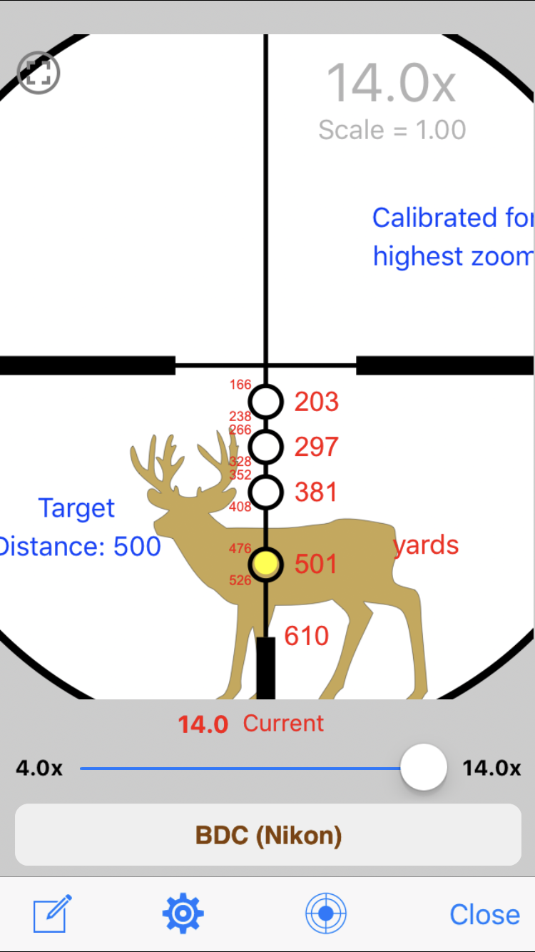

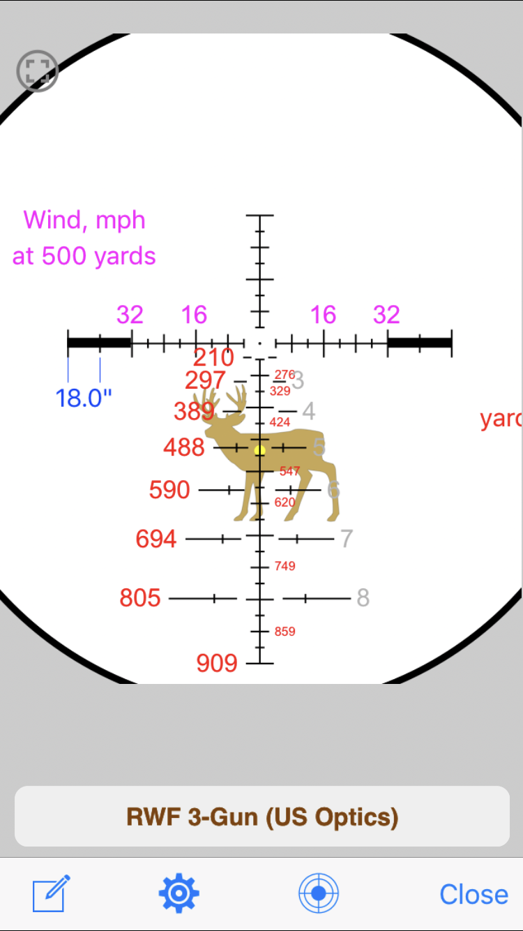

My 16” 308 shooting 165BTSP’s at 2625 matches my US Optics 1-8’s RWF-77 reticle which was designed for 77gr SMK’s by a 3-gunner our to 600.
I’ve got a Nikon BDC on my Savage 6.5CM that matches old 140 Amax’s at 2750 as well.
Tell an old 8541 that BDC’s don’t work in different conditions-that’s what the +\- lever is on the old MST-100’s is for.

The OP asked about a 223 BDC’s ability to be utilized on a 308 SCAR inside 300yds. The resulting conversation showed him it can be highly effective with a little application of knowledge.
The Nikon whose reticle I posted came in on a trade and is reliable, repeatable and tracks well. It will serve fine on my current budget on my hunting gun.
The USO RWF 3 Gun I posted was a custom build while I shot for USO built on a 1-8 to showcase the tech on my 308 for hunting thick areas that also may include longer medium range shots.
Neither is my choice for precision, but both are deadly when game appears and only presents a quick educated estimate of range before the shot is lost.
