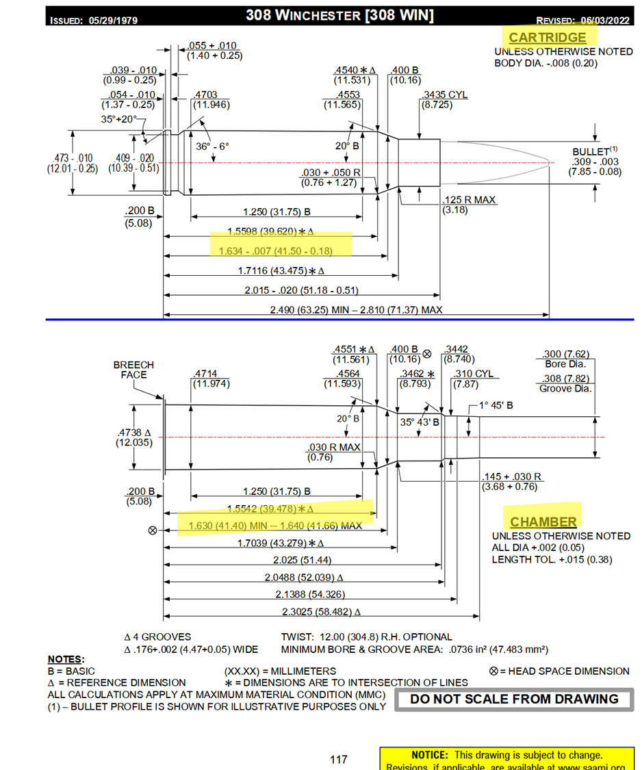

Largest SAAMI cartridge would still fit in the smallest SAAMI chamber for any given factory OEM stamp.
Smallest SAAMI cartridge would still fit and fire in the largest SAAMI chamber for any given factory OEM stamp.
Obviously this is not reality though.
Isn't SAAMI spec on .308 Winchester cartridges 1.634" max base to datum and the chamber 1.630" minimum? I believe that .223 Remington is another cartridge/chamber spec anomaly.
Wow...it appears you are right. Never noticed this before but this seems to say that a chamber to the datum line can be .004" shorter than a cartridge to the datum line and still be in spec. Weird

Yes you can have a max cartridge length be in print and a min chamber and both be in print ....but it will not chamber.
A chamber that is plus .003" will chamber that cartridge.
So a plus .004" to .005" chamber will be fine for a minimum working combat type rifle. Even a plus .008" is definitely kept in the field, but it can be a plus .010" before it needs serious attention.
I had a long 308 factory chamber about .007" but it was accurate so after the first firing, adjust your FL die, and it's no issue the Lapua brass would go 40 firings with minimal sizing.
One should not go minimum chamber in a working rifle with factory ammo.

I started using a Wilson Case 308 gauge years ago because a smith told me about them. I dropped my ammo for use in them to see if it was in spec before dinging out the hard way.
That was for 308 because that was my duty round
Since I shoot so many different calibers these days I just go to safe place and make sure my ammo will, freely move in magazines and chamber in intended weapon plus visual inspection for obvious defects.
It has gotten bad lately with at least one student a class with ammo that did not go off, won’t chamber or just sucks. This is all
match ammo from reputable manufacturers
