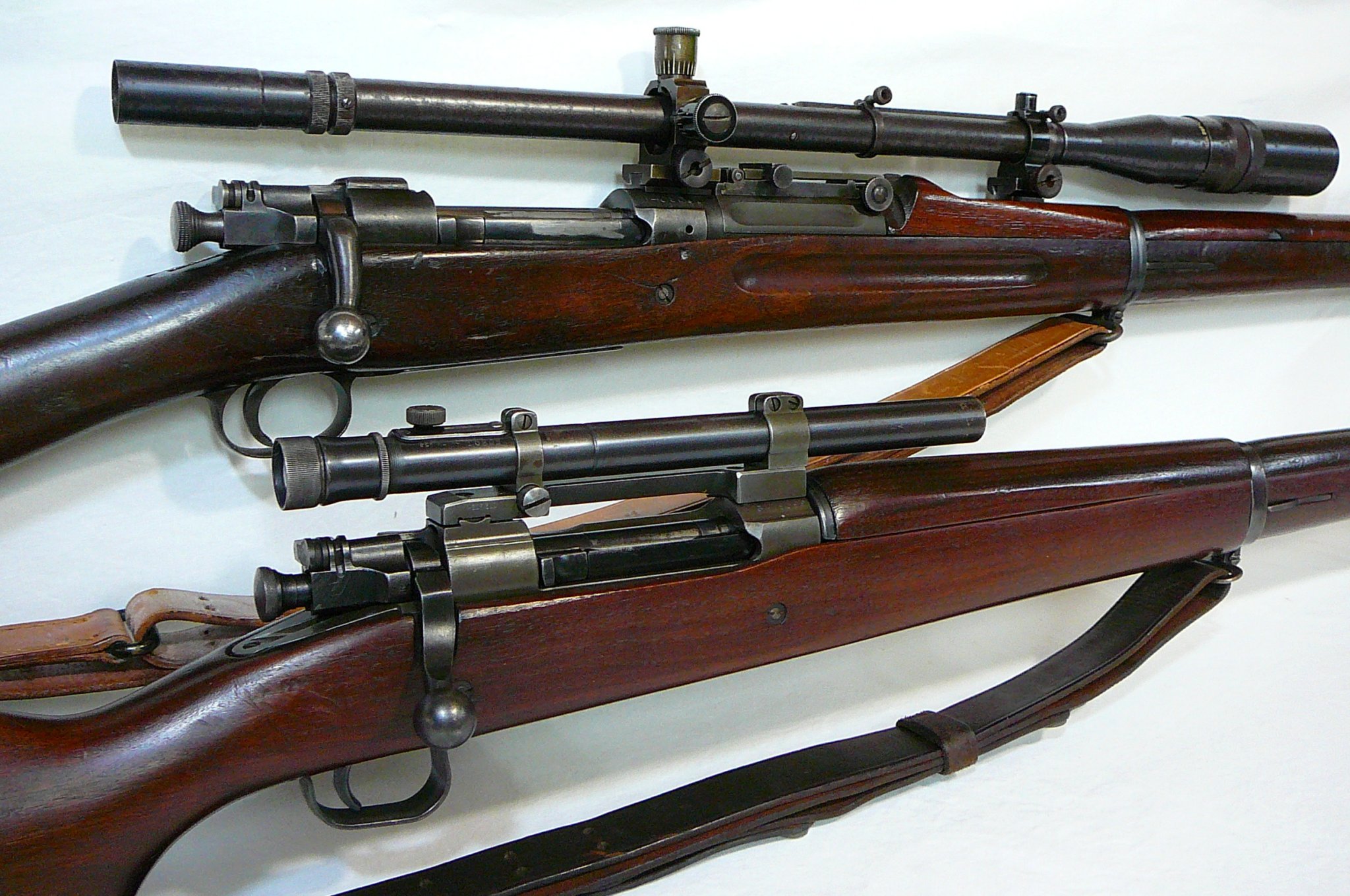

The top rifle is an Original USMC Unertl sniper.
