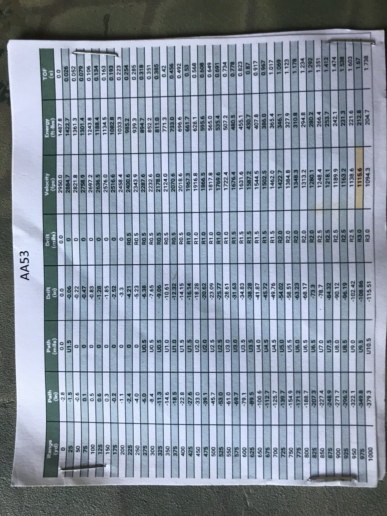

Hey guys new to dialing in since I got issued this rifle, I feel like my data is off, I’m using the StrelokPro app.
So the scope is a Mark 4 MR/T 2.5-8x SFP. 1/4 MOA clicks. Using a 62 g M855 5.56x45 LC.
My data on the app is as follows
100 yard zero MOA clicks
200- 1.2
300-3.6
400-6.8
500-10.9
Idk I’m no expert I’ve been doing a lot of studying and I feel like somethings off. Also it’s coming out of a 16” barrel w/ a 5” suppressor
There you go man, the designation at the top is the DODIC, one goes to MK262 and one goes to M855, I can’t recall which is which off the top of my head. Hope that helps.
@Franchey correct me if I'm wrong, but I'm 99.9% sure the turrets on that Leupold Mark 4 are for the AA53 (77 grain) "Match" bullet and not the A059. A few years ago we had a hell of a time developing data. I recommend asking to attend a range session with your local Sniper Platoon so you can hook it up to a magneto-speed and plug everything into Strelok from there.
Also, remember the reticle is a Tactical Milling Reticle (TMR) expressed in milliradens and the turrets are MOA. You'll need to do the conversion in order to do any hold overs.
1 milliraden = 3.44 MOA to flip it around 1 MOA = .30 mils...confusing stuff. I'm aware that whoever blessed off on the system needs to see a doctor.....
Like others have said before, just because you have a DOPE card created you still need to true that data up with impacts to know really how that weapon reacts.

How about shoot that dope and true it up? Usually works better than internet advice.
