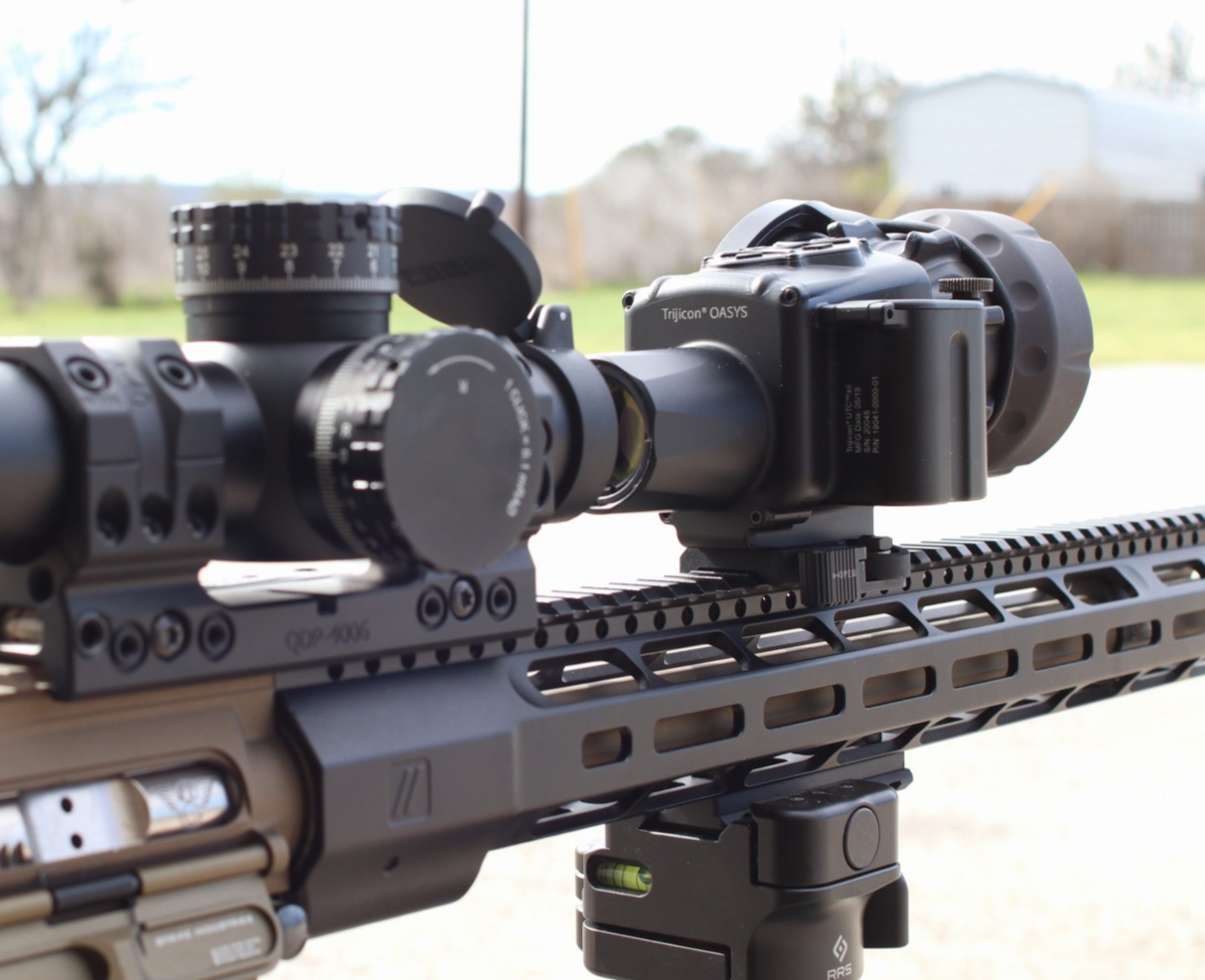

Initial Impressions: Holy crap this thing is tiny!

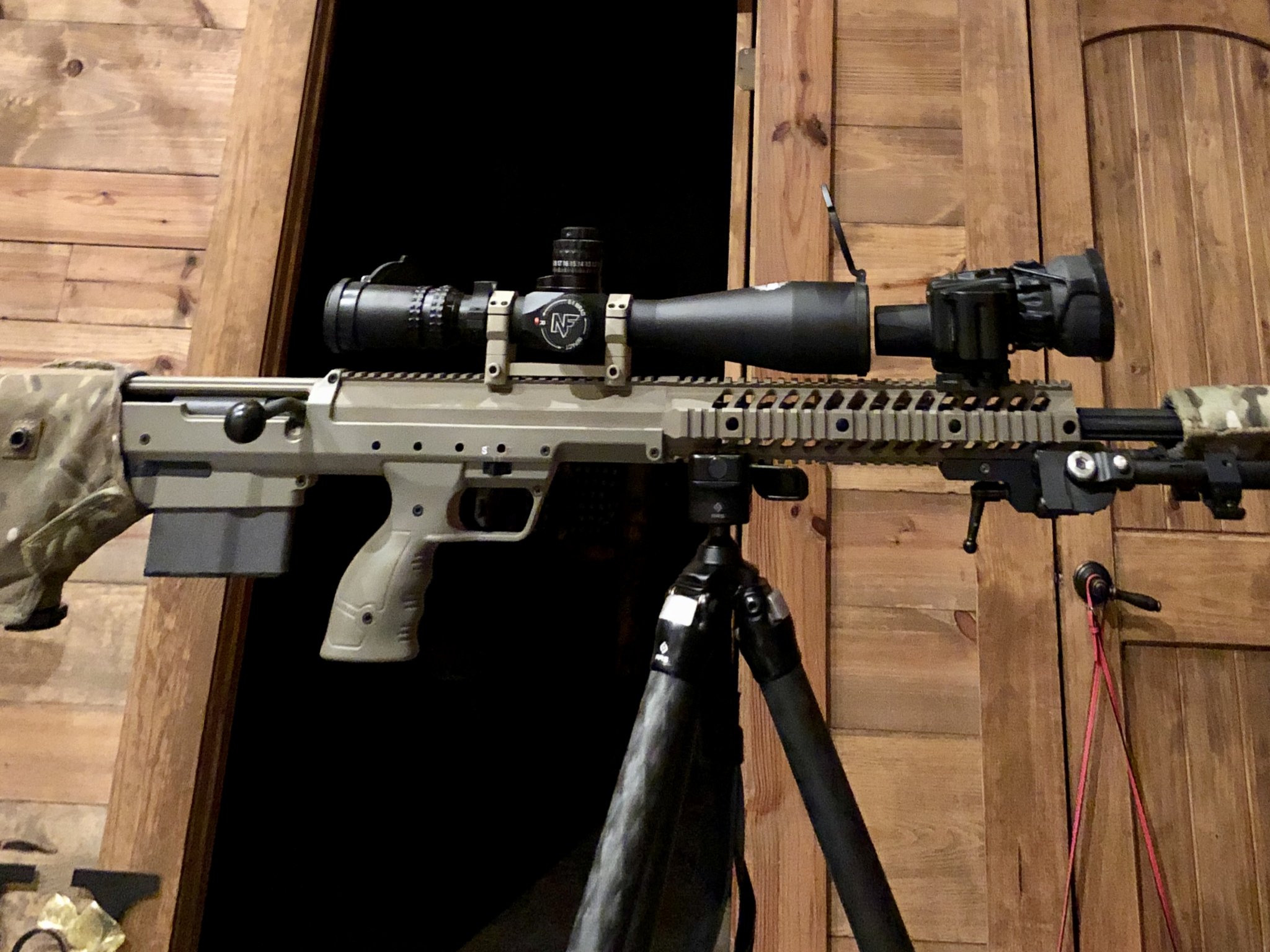

I've got several pieces of NV kit and I was blown away how compact and lightweight the UTC-xii is. I put it on my Q-Fix and the combined weight is below some of my everyday carry hunting rigs. It's really got me (re)thinking my night hunting approach.
More to come...

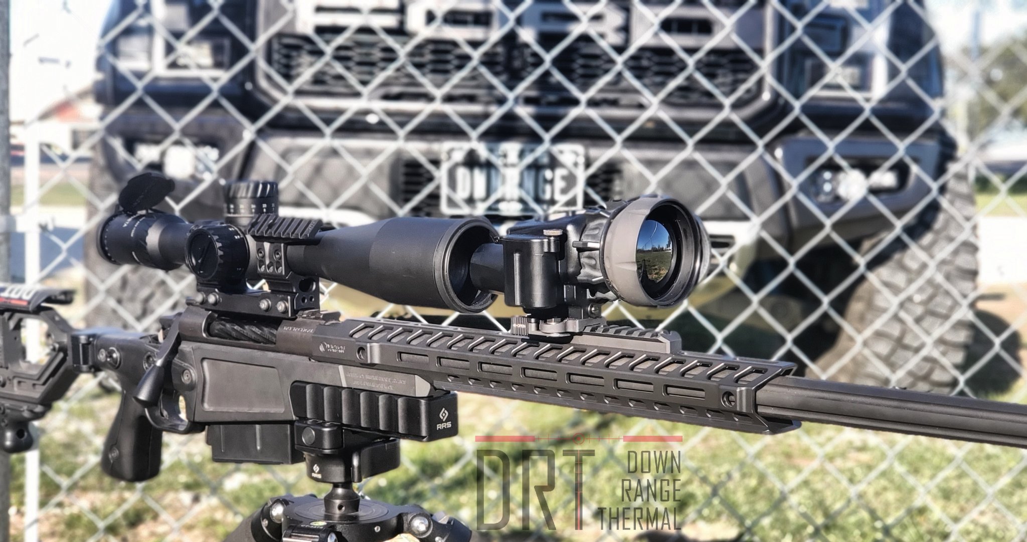

Similar initial impressions and host rifle.

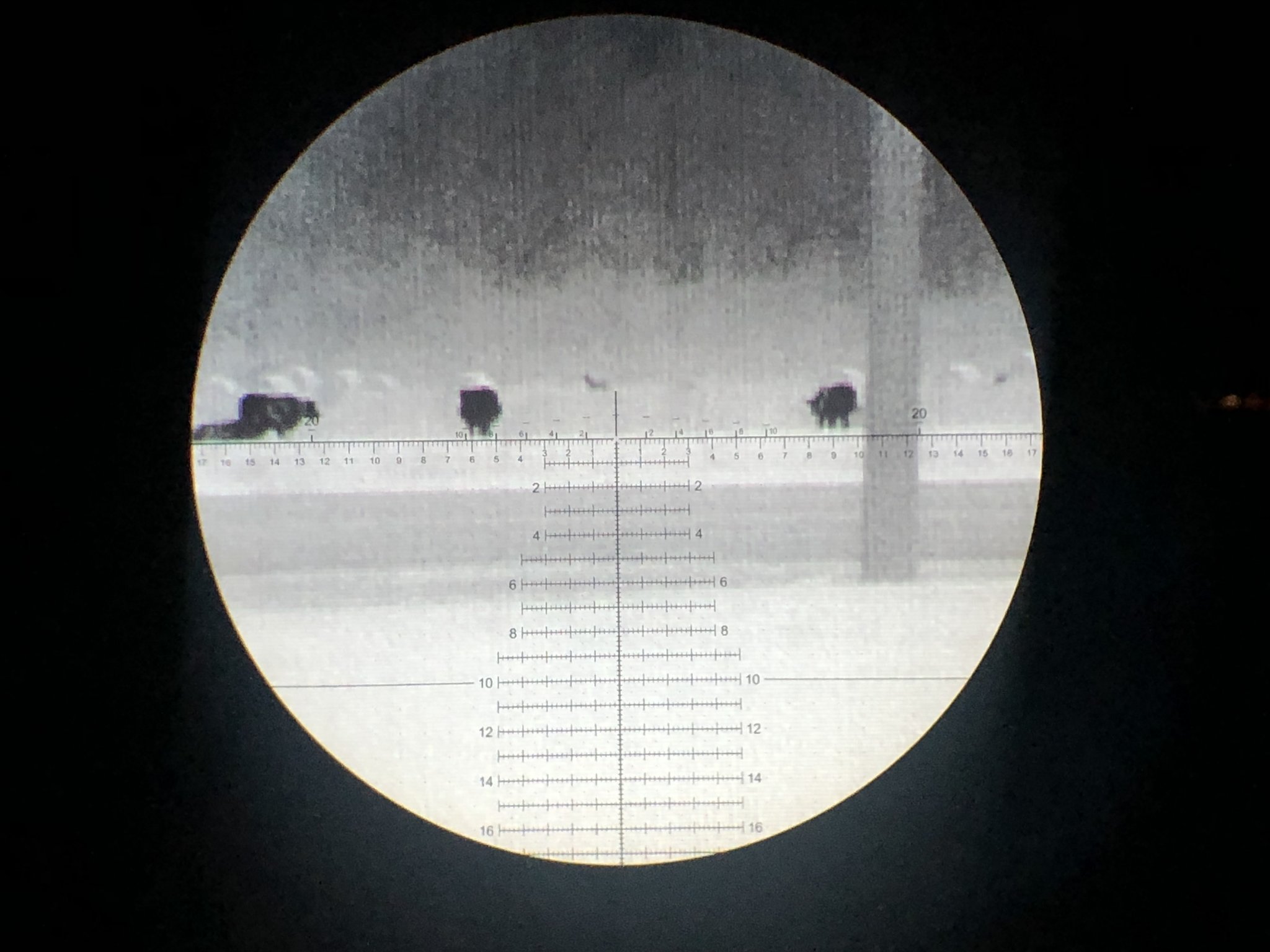

Vudu 5-25
Cows at 600ish
Deer at 1k-1100?
Didn't have the radius on. Gulf coast 150% humidity so it's probably even better for most.

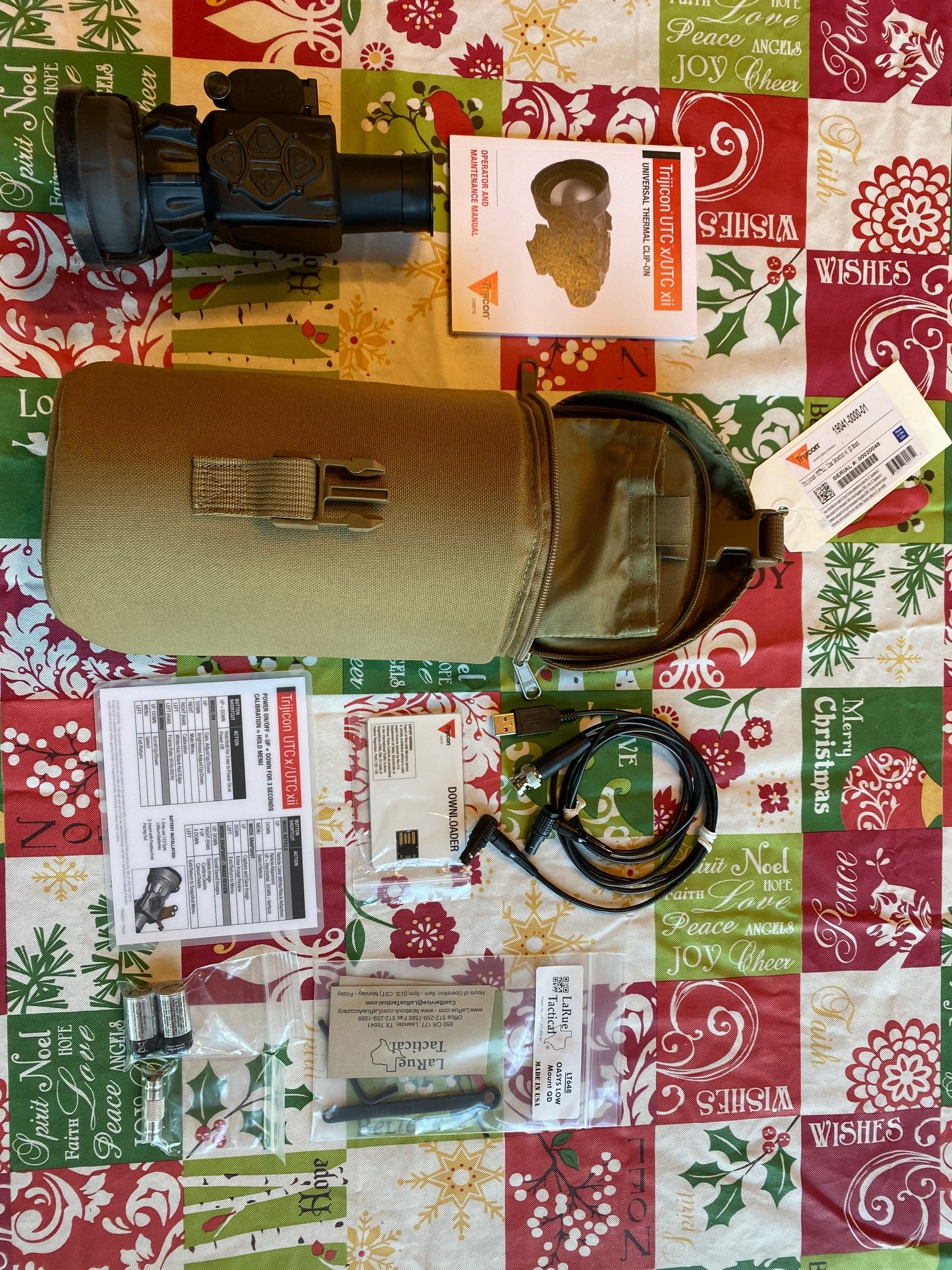

That new sticker smell!

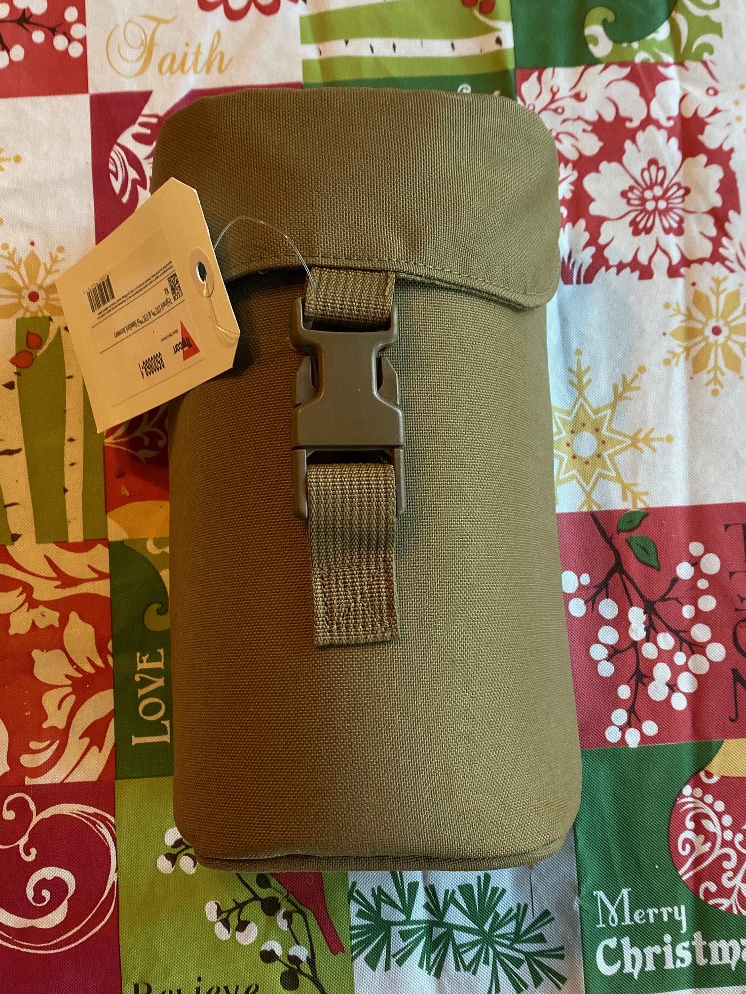

Photo of the UTC-Xii with and included accessories.
a) UTC-Xii Clip-On Device
b) Operation and Maintenance Manual
c) Soft carry bag
d) USB Cable
e) BNC Video Cable
f) Install Software
g) Laminated Quick Start Guide
h) Mount Adjustment Wrench
i) Energizer CR123 batteries

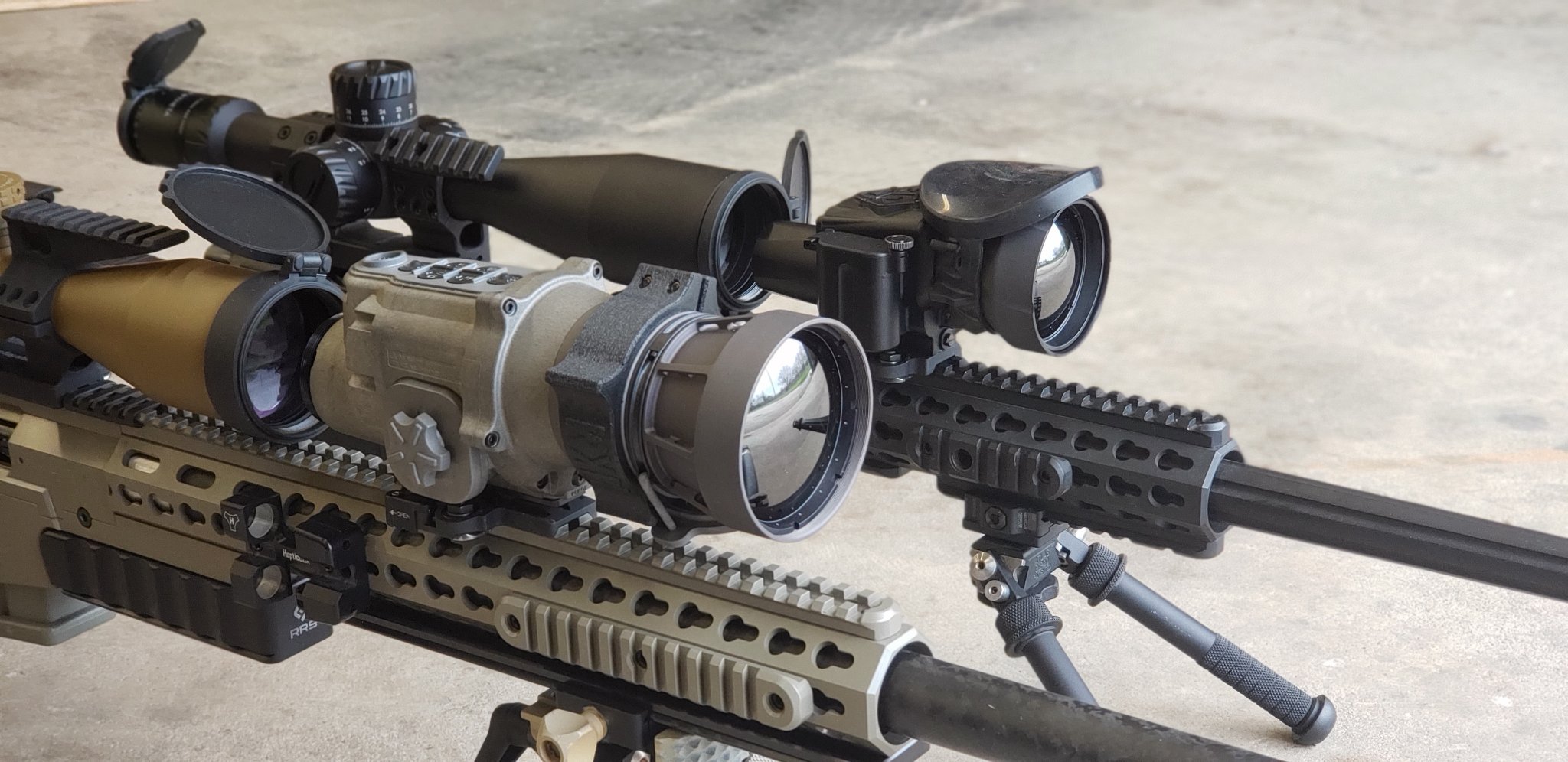

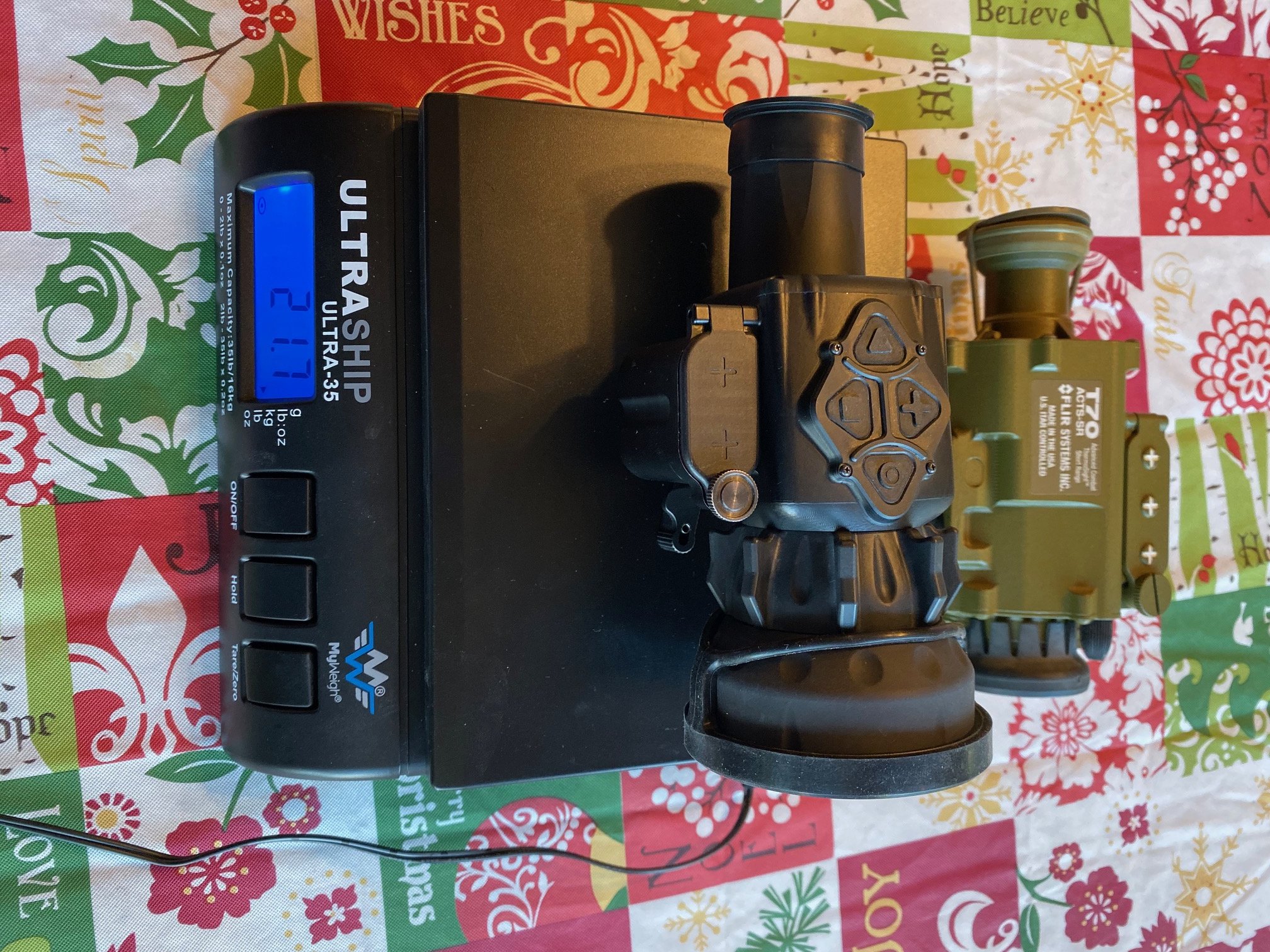

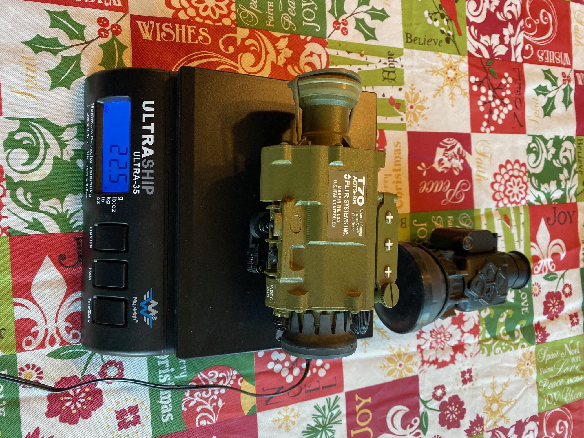

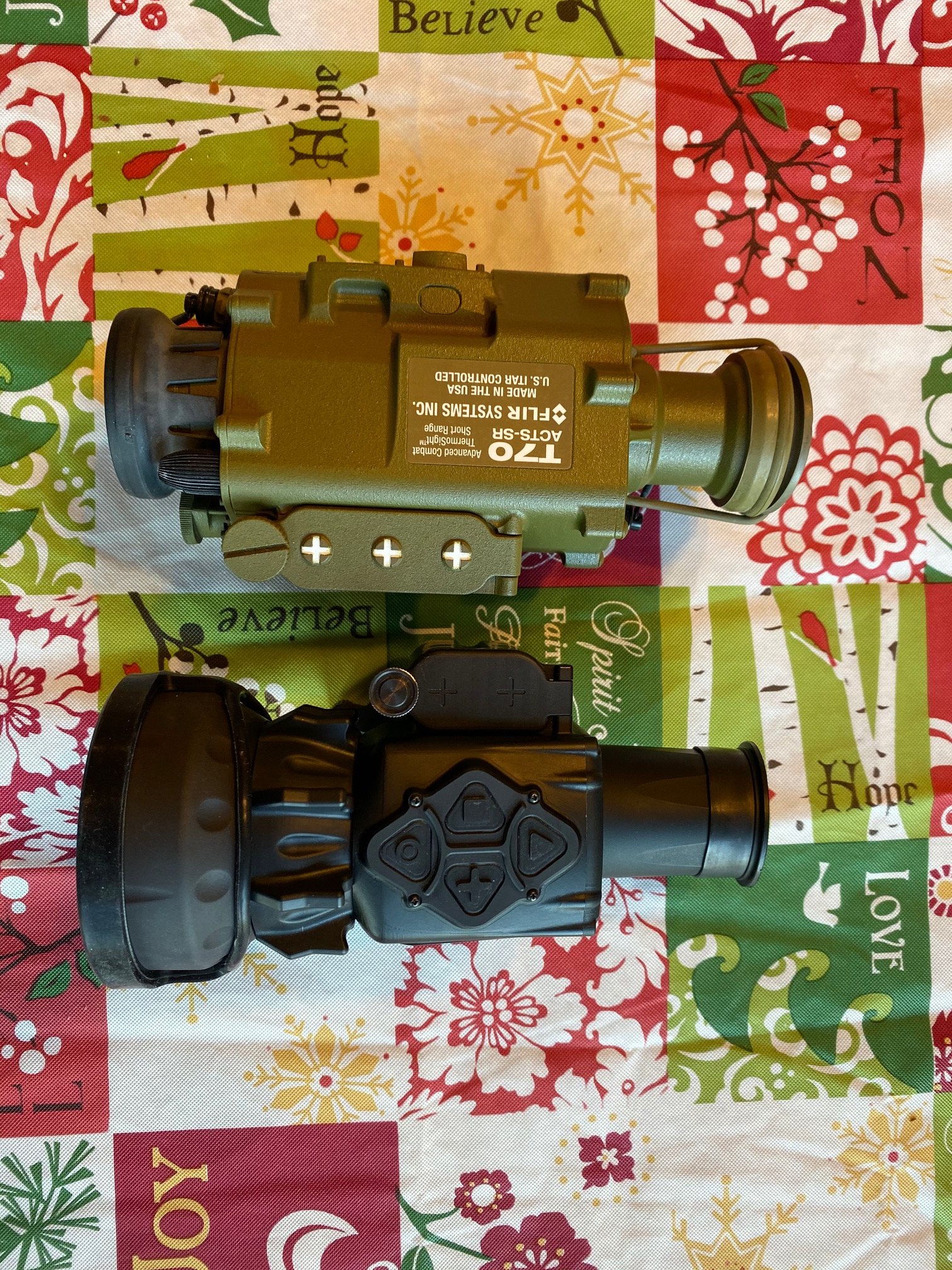

A quick weigh-in on the scale:
Even though the UTC-Xii is only ~1 oz lighter than the FLIR T-70, the UTC has a significantly larger lens on it. So, this is a bit of an apples to oranges comparison. The class equivalent FLIR T-75 weighs almost a pound more to get the "long-range" designation that the UTC-Xii has.
I will give the FLIR T-70 credit, as it feels durable enough for me to unclip it, grab it like a brick, and use it as a weapon if there was ever a need. The UTC-Xii has a very "petite" feel to it, but thats more my impression than anything to do with its actual durability. They are both mil-spec rated.

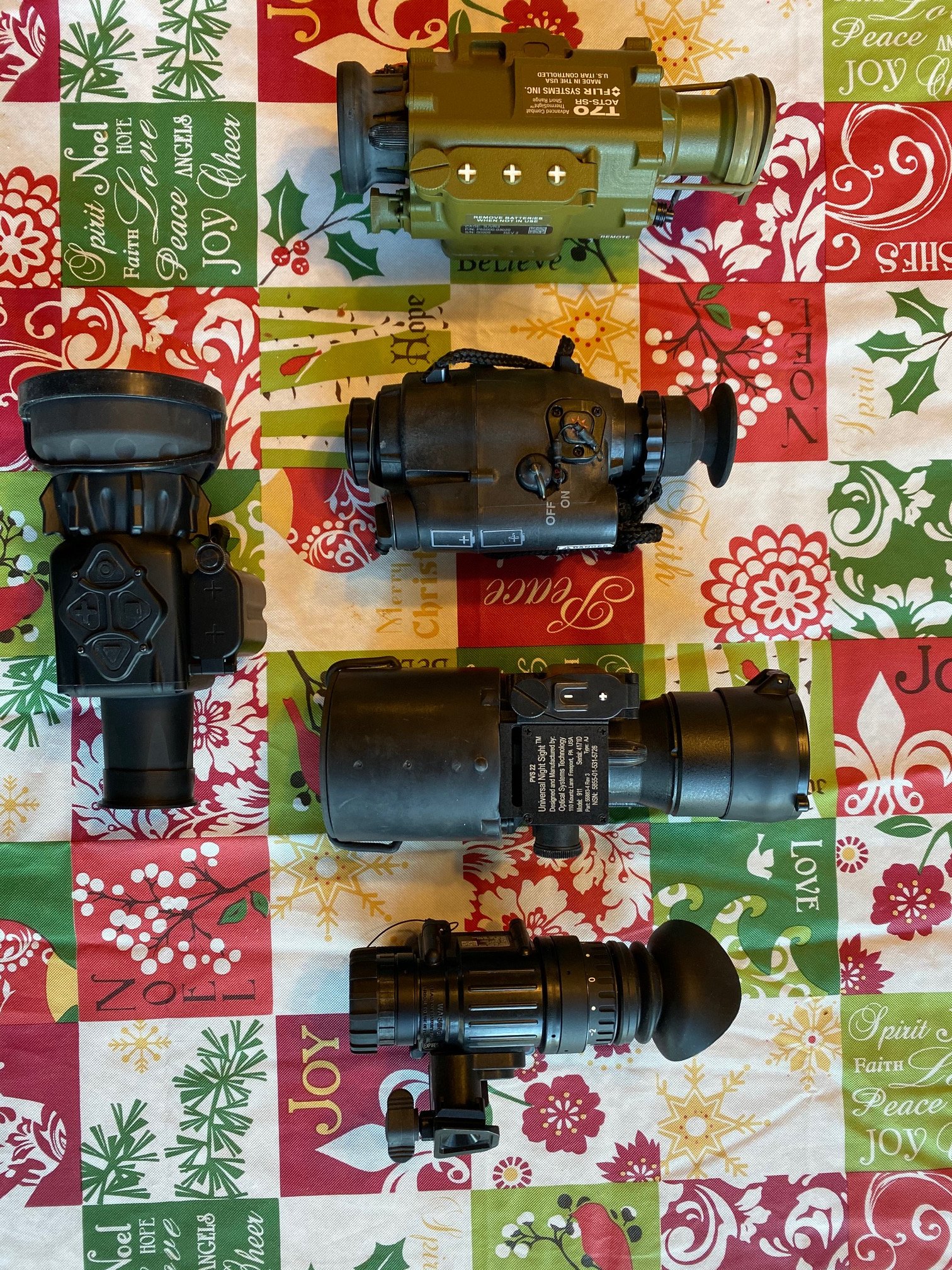

Last but not least, here is how the UTC-Xii sits with some of the other NV gear that I could easily grab for a photo and not have to yank off a weapon.

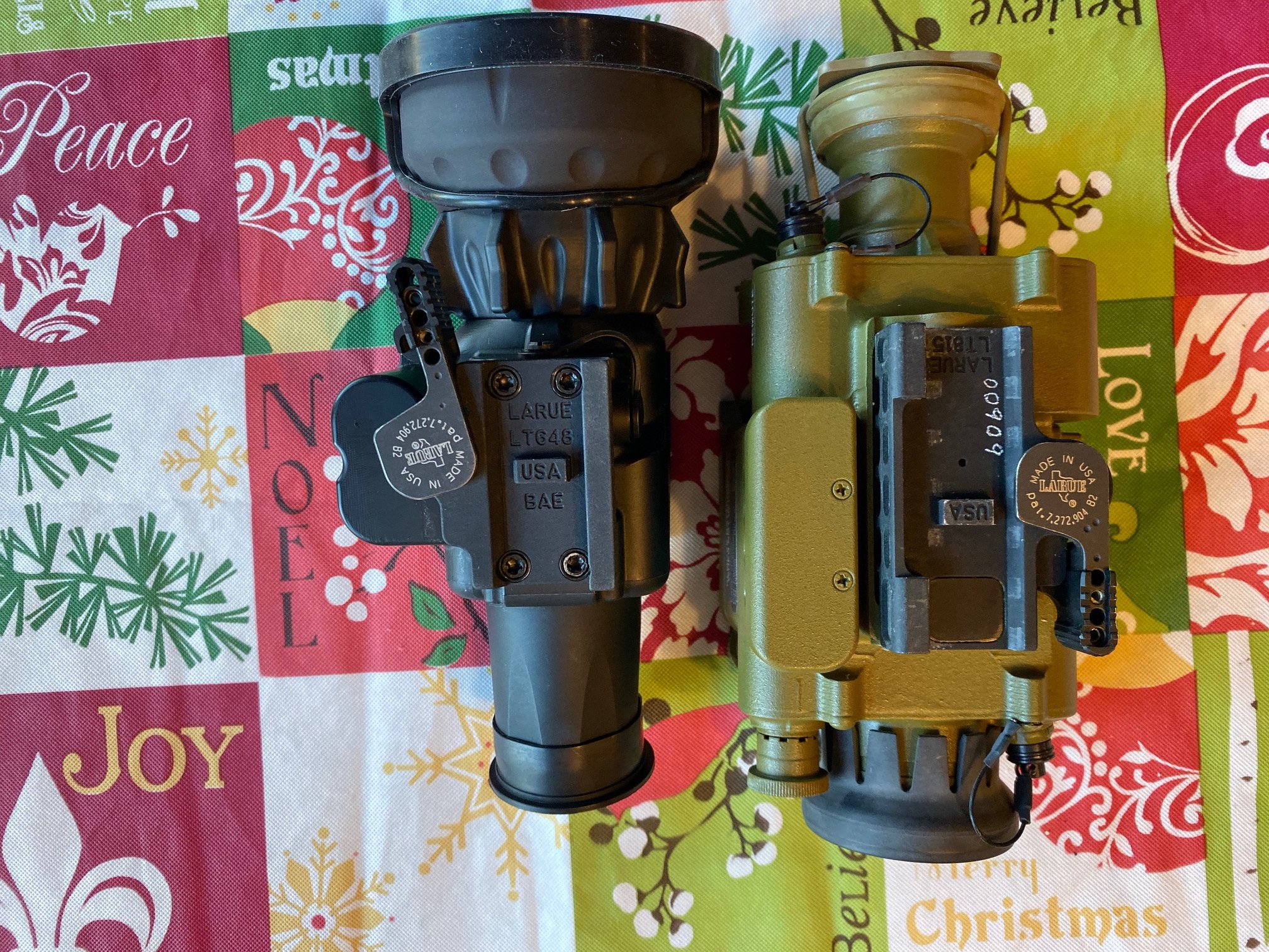

Both the UTC-x and UTC-xii are 1.31 optical center. That's pretty unusual in the NV/Thermal clipon world, with 1.5-ish being the defacto standard. Right now, I've converted all five of my rifles to Spuhr ISMS 34mm (1.338) optical center. And that works fine with PVS-30 as well. Also made some spacers for the UTC-x Larue mount to get the optical center of the UTC-x up to 38mm (1.496) if I ever get something like a PVS-24 that is more sensitive on colimation. The hard part of the spacer project, believe it or not, was getting the screws to fit the threads. But the PRC came thru, and I finally got some.
I did try an ADM 1.525 mount and was hitting low with that, but it sounds like you are saying 1.5 mount works.

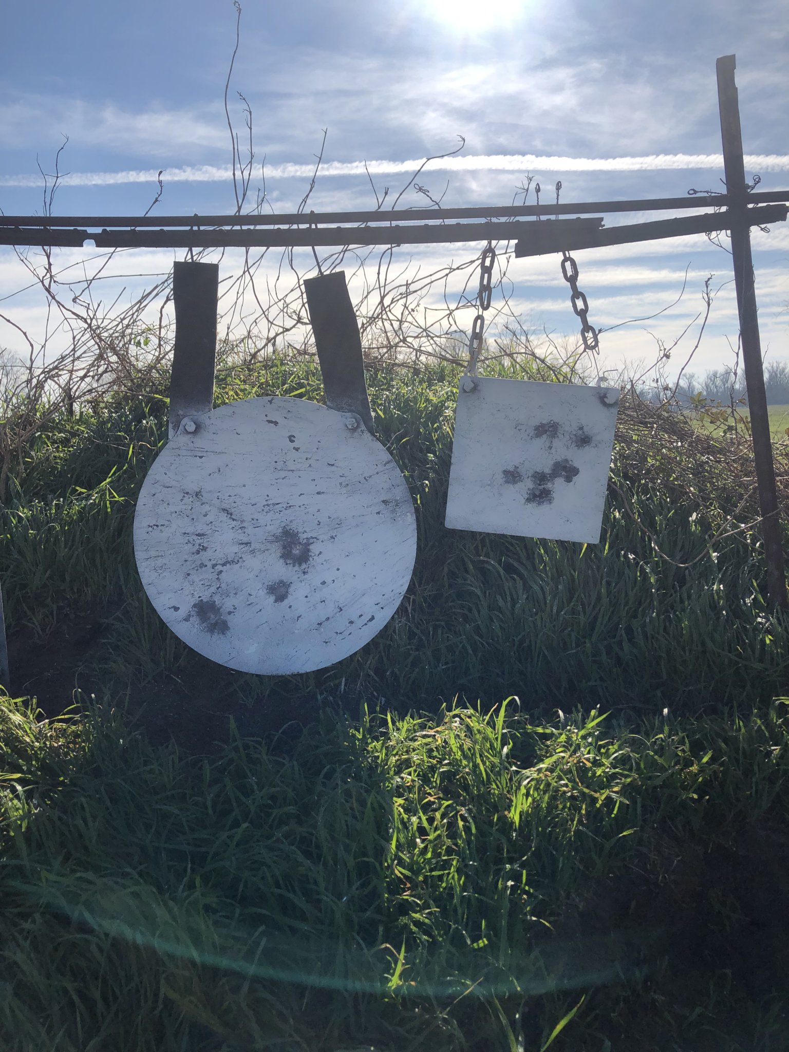

Checked poi shift with my srs with 6.5cm barrel installed. 4.5-27 razor in a 44moa 1.46" spuhr mount. I was kinda expecting a shift with this setup but it doesn't seem to be the case. Idk if it was me shooting shitty because I haven't had this one out in a while or the barrel needs cleaning. I don't normally get fliers with this gun/barrel/load
It was about 9am and the sun was heating the back of the steel but the berm was shaded so decent contrast. The sun being so low did make it difficult to see as well as I'd like.
550yds Shot 12" square then shot 22" circle with UTC. Disregard bottom left hit on 22".

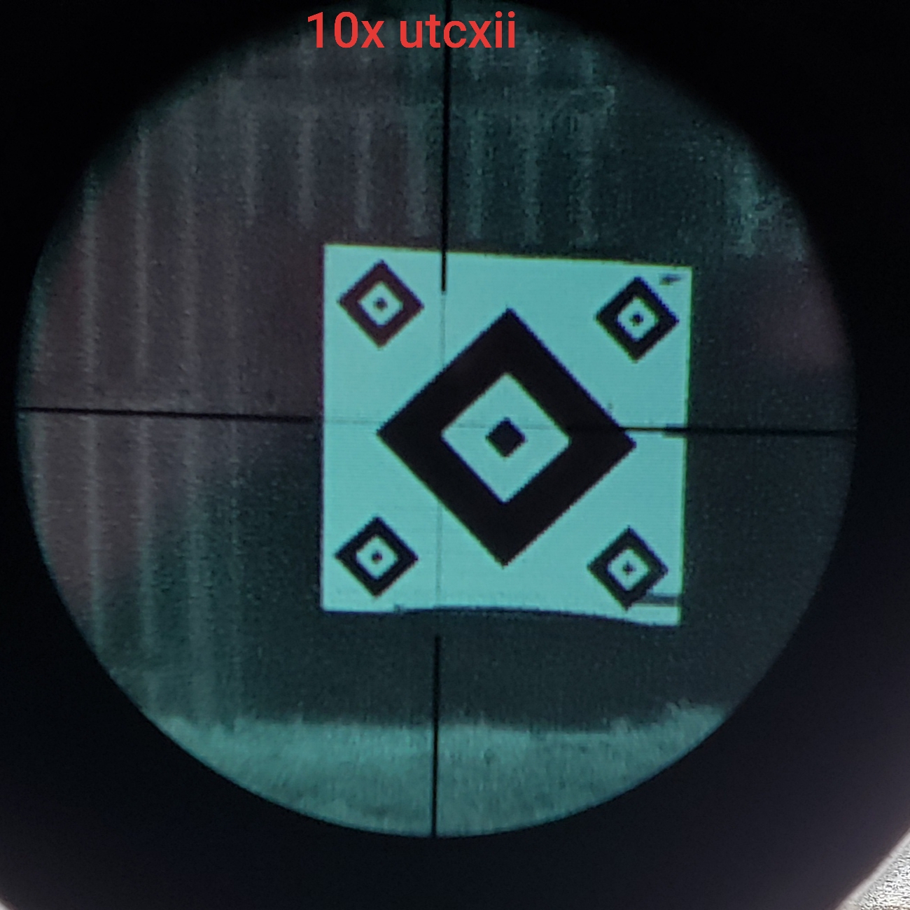

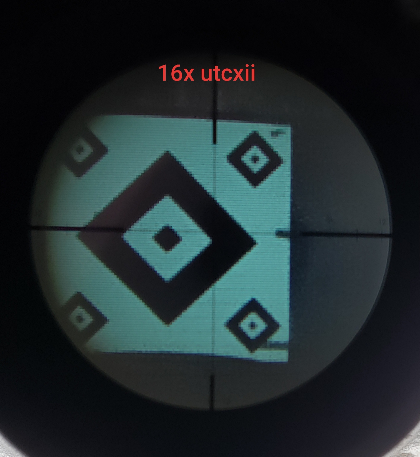

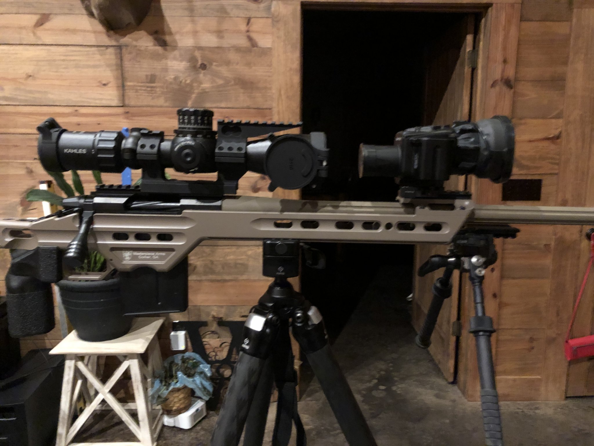

Did some testing today.
Across two platforms, one with 1.5” rings and another with 1.57” (also with 20moa cant), I observed a .1 mil shift left with the UTCxii.
Took the magnification up to 16x on a small hand warmer at 100 yards when it barely started to pixelate. Image was still very crisp.
