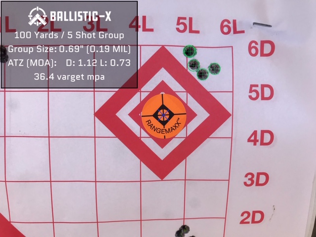

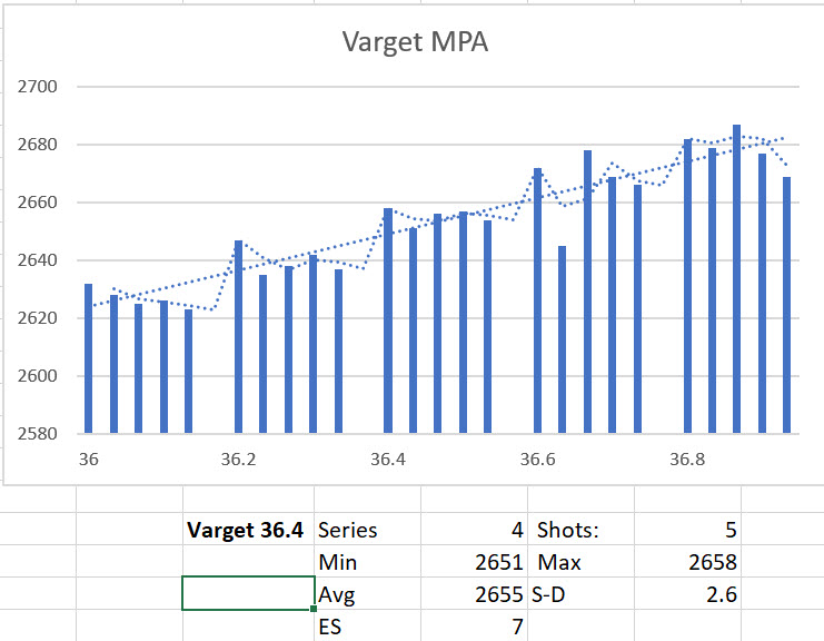

Ok so here are my test results from today. I did 5 shot loads starting at 36.0 up to 36.8 in .2gr increments.
The best numbers are groupings from the 36.4 loads. .69" was the best grouping I could do. 36.2 was .89"
Loads 36.6 and 36.8 were over 1" groups (n)
I think I'm gonna call 36.4 good for now.

This is just a suggestion, but I'd focus more on the S.D.'s than group size. I've always noticed this trend when someone tests groups, their best tends to fall somewhere just before the middle of all shots taken. It's a natural warm up, then it typically falls apart. Either you test it the same way you did but at a longer distance (300-400yds) or go with best S.D. and rest at distance. A 100 yard group can cover up a lot of error in data and skill.
