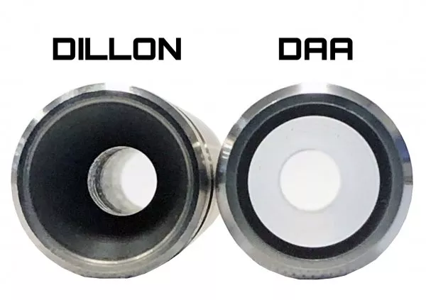

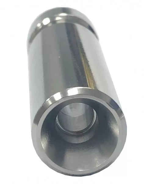

    Does it? I need to find a powder that meters well through a Dillion while being stable and has good ES/SD for precision .223 loads I dont want to waste time using Supertrickler on.
    The Double Alpha .223 powder funnel/insert for Dillon powder measures is mirror-polished inside and helps more than I thought possible for progressive-loading stick powder:
