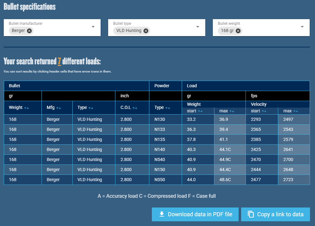

I'm looking into N140 and 150 as well at the moment. VV data shows more velocity with 175's with N150. 140 seems to be better with 155's. I'll probably shoot more 168's than anything, probably an eldm, or maybe tmk's depending on availability. I'm kind of torn on which one I want to try.

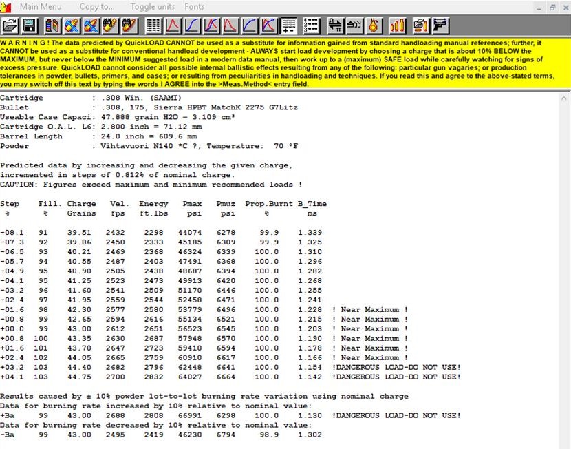

I was getting ready to try N140 in a 308 Win with the Sierra 175 SMK and am having trouble finding loading data other than VihtaVuori. The VV data is rather anemic with a max charge weight of 41.7 grains giving a velocity of 2569 fps. I looked at load data on Hodgdon, Nosler, and Sierra but none of those has N140 data. Do you know of any load data that might help me?
Below is some info from QuickLoad. Take it as ballpark info as you'll need to compare any velocity as what you get will most likely be very different (velocity here is for 24" barrel). Therefore, as usually recommended, start with low charges and work your way up.
