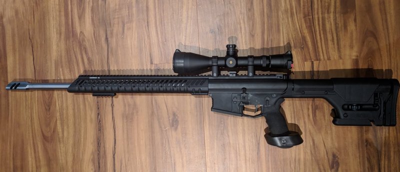

Hi all,
I'm new to this forum, not new to guns. I am a hobbyist builder, and I do own some basic tooling for my projects (lathe, mill, reamers etc). A while ago I decided to build most accurate AR 10 that I can do, and thought I'll share details so maybe some people will find it helpful.
I could have just bought a barrel from a reputable maker but I thoughtI wouldn't learn much.
So I decided to make one from scratch.. well, from a blank.
First attempt was not a success. I bought a cheap 16" blank made by Bergara, turned it into ar-10 barrel, .750 gas block at mid-length, chambered, put on a receiver. It shot ~1.5 moa on average, occasionally getting sub-moa groups. Not good enough. and I did not know how to troubleshoot it - too many variables, and some (like chamber, profile, etc) are already there and I cannot change them.
So on the second attempt, I decided to make step by step approach, testing accuracy between the steps - that way if accuracy is good in the beginning and then drops, I at least know which step is to blame.
The steps will be:
1) Barrel blank threaded and chambered, muzzle crowned, full 28" lenth, maximum thickness profile (1.200")
2) Blank cut to final length (20"), muzzle threaded 5/8x24, profiled (I'm thinking of rifle length gas system, .875 gas block, 1.000" between chamber end and tenon, .850 from gas block to the muzzle). I see no point testing accuracy after cutting to the length but before profiling - as shorter barrel of the same profile should not have any drop in accuracy
3) Drill gas port and install gas system, finally turning it from bolt action to semi-auto
My accuracy testing protocol will be 6 groups of 5 shots each from 100 yards, 175gr smk bullets, increasing Varget load from 42 to 44.5 grains, 0.5 gains step
The parts I have for this project are:
1) Shilen match blank 308, 1 in 10", 28" unturned
2) BAT machine 308 extension
3) 308 Winchester AR reamer from Pacific tool and gauge
Ultimately I'd like to achieve 0.5 moa with reloads
So far only the first step is completed - if there is interest, I will keep this thread updated as it progresses.
I do appreciate comments, feedback, suggestions (especially from folks with experience in similar projects)
Now it looks like a monster, it won't stay that way though
Assembled and ready for first accuracy testing

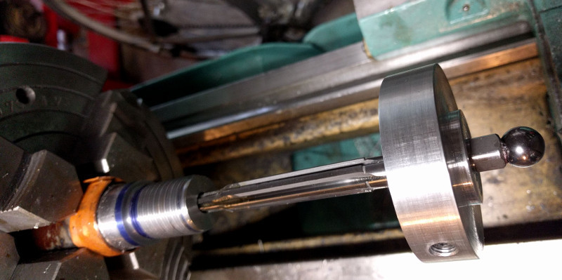

I can't find the reamer on the PTG website. Dimensions? The shortcomings that I've seen in .308 AR barrels (only my opinion) is that they seem to use 7.62x51 headspace rather than a true .308. That seems contradictory to what builders did in the past with M1As. I can't see why anybody would buy a premium barrel and want to run some kind of cheap surplus through it, if that even exists any longer.
Does GAP use the PTG reamer named for them in the GAP-10 or just bolt actions? Interested in seeing your results.
About the reamer - PTG does not sell them anymore. I'll ask them to email me drawings.
I headspaced using 308 go gauge, the chamber so far is very tight (go+0.003 shim won't close).
Now PTG has 308 match GAP reamer, whatever that may mean. Maybe it's a better one

I measured the reamer neck, it's .3459. That's close to SAAMI specs and about 0.002 more than a match chamber for a bolt rifle, but I guess it's justified considering how an AR slams rounds into the chamber.
175 smk has about 0.050 jump from the current seating depth before it touches the lands
You really don't want to have the bullets too close to lands in an AR, 0.050" jump is plenty close.
Make port only large enough to cycle reliably and lock back on empty magazine. I'd also go with a longer gas system do help deal with the larger gas volume available to cycle the BCG. Isn't a bolt rifle, is going to be a one bullet weight, limited powder choice set up but it is possible to get really great accuracy, drop dead reliable performance. You'll just have a pretty narrow range of ammo that will give you desired performance.
Chamber in a GAP-10 is not the same as chamber in GAP bolt rifle, at least not in the rifles I've measured.

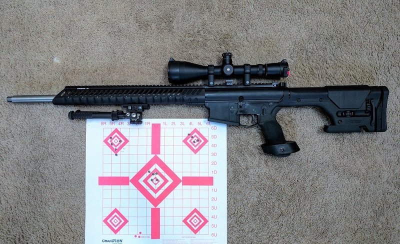

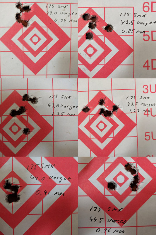

Here is first first test target, after zeroing in. 6 groups 5 shot each, about 0.7 moa on average, best group 0.41 moa, worst 1.25 moa. All with 175SMK, Varget powder in 0.5gr increments
Best group was with 44gr Varget. For over moa groups it could have been me (I didn't feel very comfortable about few of the shots due to muzzle brake blasts from fellow shooters around)
I'm not yet sure if I should be happy with that before moving to next step - before profiling and gas port drilling, I still can re-chamber. 0.41 moa group looks promising, but I will likely lose some of that with slimmer barrel profile and gas port drilled.
I also got reamer drawings from PTG - it's been made to shoot variety of ammo, including 7.62 NATO and 7.62x51 CIP. .3458 neck, .147 freebore, .3089 throat, 1-30 angle Long jump but fairly tight throat.

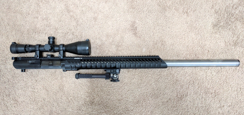

A little bit of an update here.. I had a chance to acquire a match 308 reamer - PTG had them on sale. So as an experiment, I cut about an inch from the chamber side and recut the chumber using new reamer.
The previous results were: 0.74; 0.85; 1.25; 1.23; 0.41; 0.76 moa - average 0.87moa
With new chamber, and 1 inch shorter barrel, results got a bit better - 0.86; 1.05; 1.15; 0.42; 1.58 - average 0.79 moa (i didn't shoot 44.5 gr charge group). Also, 0.42 moa group looked more like a one hole 4 shot group (about 0.17 moa as I could measure) with one flyer about 3/8" from the group center, so pretty good.
There was no reason not to like this chamber, so I decided to settle with it and move with the rest of the plan: cut and profile the barrel.
What I did:
1) cut to 22 inch
2) used rifle +2" length gas system
3) Profiled to 1.19" around the chamber for 3", then down to 1" before the gas block, small step up to 1.05" at the gas block shoulder, 0.875" gas block, down to .850" to the muzzle, 5/8x24 end threads
No gas port, no muzzle brake yet.

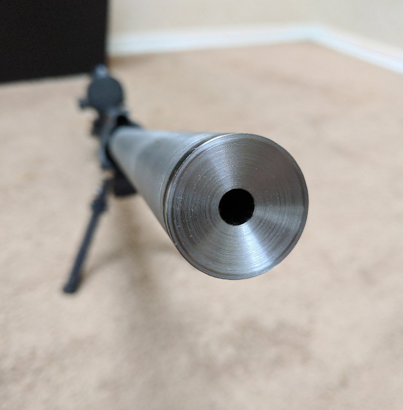

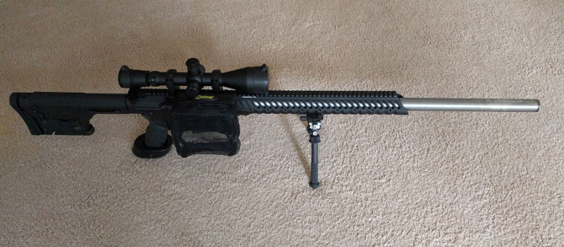

The rifle looks cool indeed. However this is where good things end now - the accuracy started to suffer quite a bit.
Test group was (again, same protocol - 175smk, 42-44.5 gr Varget, increment 0.5gr): 1.22; 1.11; 1.64; 1.98, 1.24, 1.27. Average 1.41 moa.
Very noticeable accuracy drop, in fact no more submoa groups. I don't believe it can be explained by thinner barrel - first it got 4 inch shorter (should help to make is stiffer), and besides it is not a pencil profile by any mean.
I am going to redo this test again, before drilling gas port - verify extension and barrel nut torque, re-lap the muzzle (not sure I did a good job last time after crowning)
Other than bad crowning, any idea what could went wrong at this stage?

I doubt simply profiling the barrel would induce any kind of stress you'd have to remove. I think you would have to have been using an indicator while profiling to know. The only thing I've seen is that fluting too aggressively can affect the barrel. But you did remove weight from a tuning fork and now it vibrates differently. Hard to say about the crown if you don't see any burrs but I've never seen anybody lap anything after crowning either.

As for the accuracy troubleshooting - I found one thing which was wrong with it, which definitely had an impact. The match 308 reamer I got from PTG had a narrow throat - specs were calling for .3085 _+ 0.0004, and the actual reamer measured 0.3081. Technically within specs, however 175 SMB bullets are typically .3083 in the neck area. After chambering some live round and then removing them, I found that on few rounds, the bullets was seating deeper than before chambering - so that narrow neck was pushing bullets deeper. Definitely a disaster for accuracy.
Since that was a "clearance" reamer, PTG was not very helpful - they offered to take it back for the money paid, and buy a new one for full price. Instead, I decided to open up the neck using a different approach - I took few 175 SMK bullets, put them in empty cases with some locktite, seating them right at the depth then they were supposed to touch the lands assuming reamer would be proper size, put some 800 grit paste on the bullet, threaded back of the case and put threaded rod in it, and hand drill from the other side.. so you got the idea - using the bullet as polishing mandrel on the neck. Yeah I know that's a bit of unorthodox way, but at least rounds are chambering now properly.
my last trip to the range when I was testing it was not a success (some barely sub-moa groups), but I had other problems to work on - gas port was a bit to small (gun didnt cycle properly), and muzzle brake was coming loose. Now I fixed that, and planning to make another trip to the range to re-test. Hope to give you a full update next week
I prefer to start with a blank that I don't have to turn down behind the gas block, and only minimally in front of the gas block. That said, I've turned several down over the full length, and have never seen it affect accuracy. I just finished a 6mm Fat Rat for a friend with a Bartlein barrel turned down for the whole length. He chrono'd and shot a couple groups last Friday for a match Saturday, he said it shot 2" at 500 and 3" at 700. I wasn't there, I don't know anything about the number of rounds per group, but obviously reprofiling the barrel didn't hurt the accuracy.
A loose muzzle brake, however, could easily be the problem. If you continue to have issues, I'd test with and without the brake to see if it's affecting anything.
Holy smokes, that is the thickest barrel profile I have ever seen on any man-portable gun.
How heavy is your setup??
it's not too bad, about 13.6 lb with the scope, without magazine - considering barrel is now 22 inch, .875 at gas block. M110 is be about the same weight. If you are referring to the pictures in the beginning of the thread, it was before the profiling - 30" long, about 1.18" thick. That thing was probably 20 lb or so
Last week to the range was a success. I got most consistent results, even comparing to full bull non-contoured barrel. Here is what I did:
1) Opened up gas hole a little (from 0.093 to 0.096). Still not enough for rifle +2 inch gas system on 22 inch barrel, only cycles to about 30% of the rounds. I have a 0.098 reamer, but if this won't be enough, have to go to ebay for some larger ones - probably 0.101-0.104. Anyway, not concerned much about this, will get it working eventually, just don't want to overgas so taking it slow.
2) Tied up the muzzle brake. I don't use a crush washer, instead I just shortened it's threaded back to time properly (and cut too much, ended up adding 2 layers of 0.002" foil shims)
3) Wrapped the barrel extension with some stainless foil to eliminate play in the receiver - to the point when I had to gently tap it with a mallet to go in place.
4) Changed my accuracy testing protocol - went down from 0.5 to 0.3 grain increments of varget, and also seated bullets to nominal (2.800) length.
5) Went shooting to a different range - it was quieter (no air shakes from magnum calibers around), and most importantly - their tables are more stable (looking through the scope, I could see that target sight picture due to my heartbeat has decreased). I am somewhat confident that my aiming was within 0.25 moa or better most of the time.
Here are the 5 shot group sizes at 100 yards:
43.0 gr: 1.05"
43.3 gr: 0.68"
43.6 gr: 0.98"
43.9 gr: 0.65"
44.2 gr: 0.46"
44.5 gr: 1.26"
A very pronounced node around 44 grain of varget (surprisingly that didn't change from uncontoured longer barrel). I am very happy with the results - now I'm confident with a bit more load development I can make it consistently shooting better than 0.5 moa. Not bad for just the second AR barrel I made from a blank.

2) It's impossible to change one thing at the time. Simple barrel removing for contouring requires re-torquing barrel extension and upper nut. Seems like these things have more impact on accuracy than barrel contour itself.
3) Match chambers are tricky. Too easy to make it "too tight" for the bullet, even with reamer from reputable vendor like PTG.
here is photo of the best group
