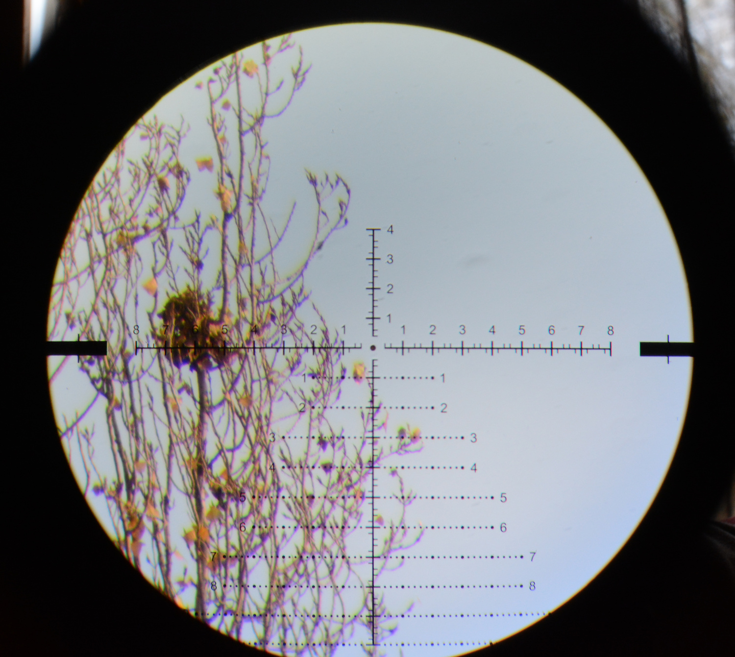

The top picture is from the Kahles K624i and the bottom one is from the Vector. It took me a while to get decent pictures of both. The best one I got from the Kahles is about 30 mins later and the roof is in shadow. But that's what I got. They both look about the same to me with my eyes. The pictures from the camera don't reflect well how they are in real life.
If you want to pay about 3K for the Kahles, good for you. As for the poor, you might want to check out the Vector 34mm Continental for less than 900.

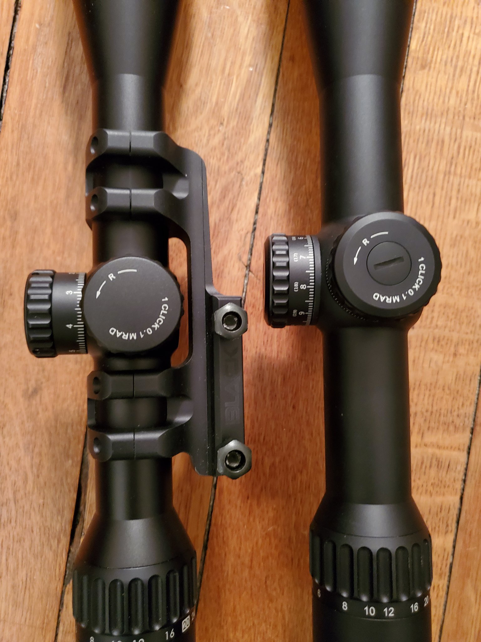

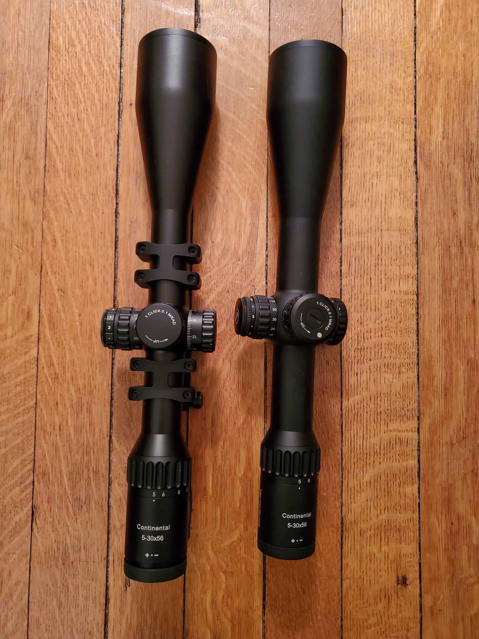

Ok, so I received the 34mm continental yesterday, and compared it against the Taurus and older 30mm continental. The glass is great, but to tell the truth, in multiple light conditions, my eyes could not see that much of a difference between the older 30mm and the new 34mm. The turrets are much nicer, the illumination is better, its FFP reticle is great, and the price at $807 on Optics planet is incredible. That being said, I am returning it, and just going to buy the older version again, and save $500 dollars towards a new MDT chassis.

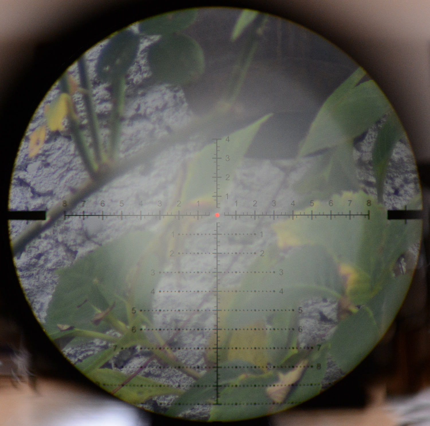

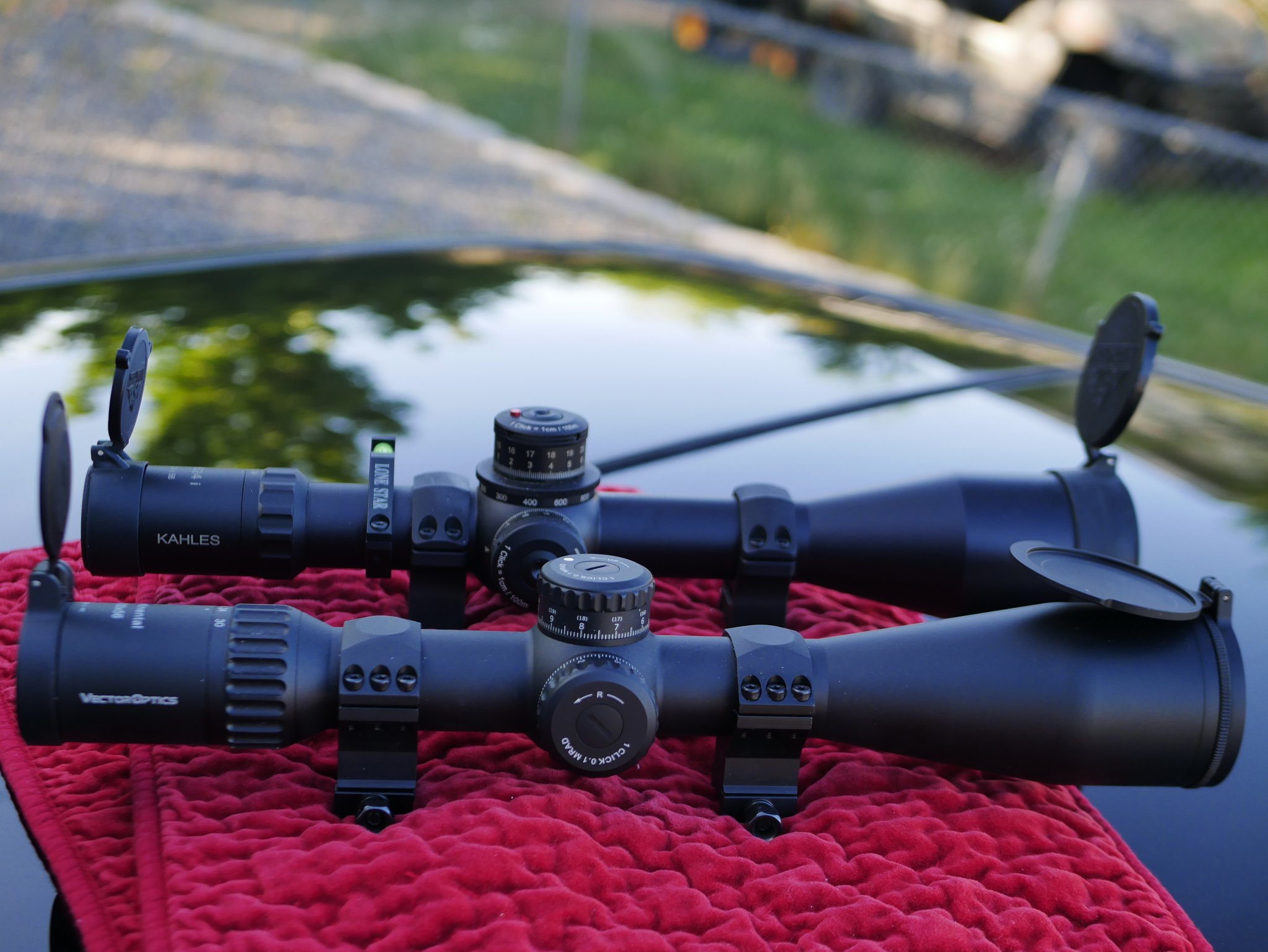

Two more comparison pics with the Sun out this time. It was rainy in NY yesterday. These compare the Primary Arms Apollo Platinum with the Vector Optics Taurus. Both FFP. One is LOW glass, the other Schott glass. They are very very very close.

I'm going with above picture in pic#27, that the blue hue(abberation) is on the vector. My taurus 5-30 was the same. It's cheap glass with chromatic aberrations
I dont see it in mine. Cannot beat it for the price. My third is on the way. (I did return the new 34mm Continental though) and bought the Platinum Primary Arms with Apollo reticle for my 6.5

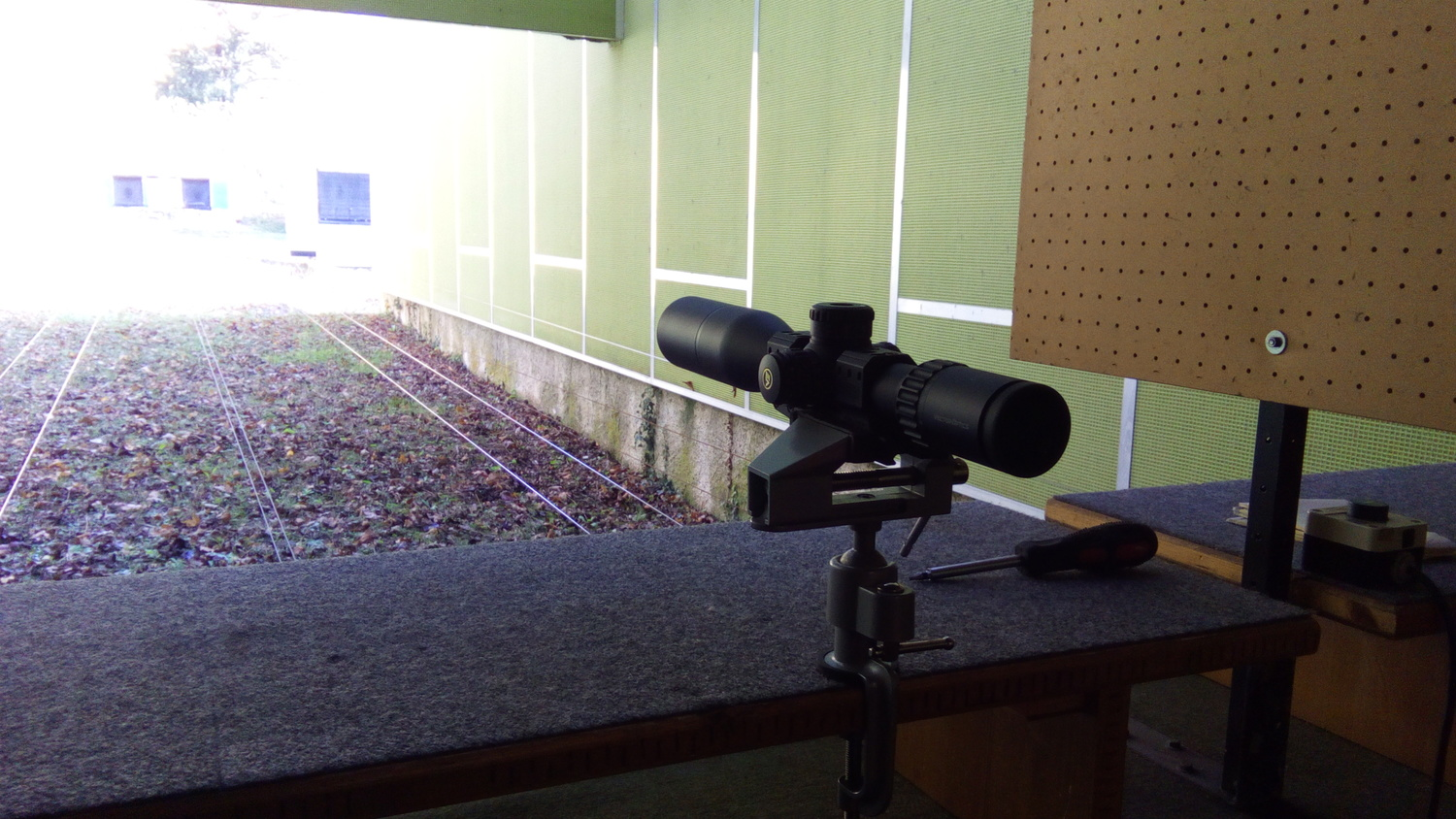

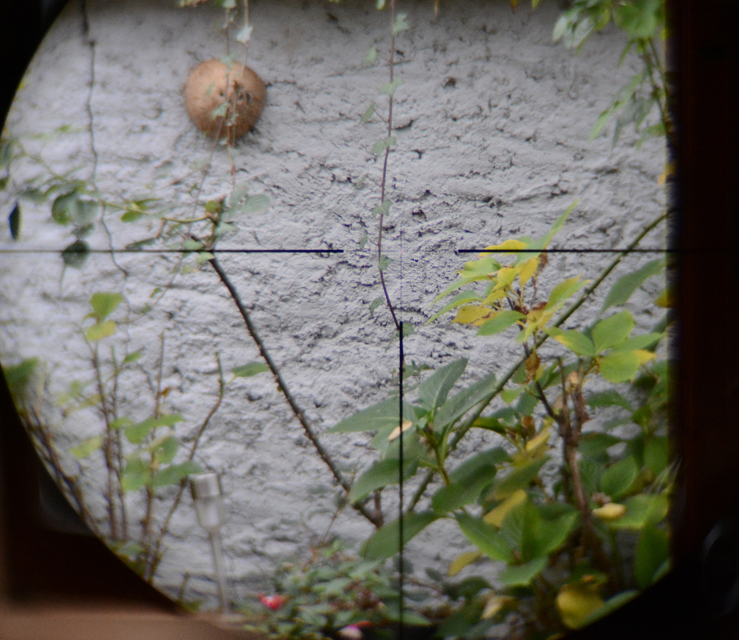

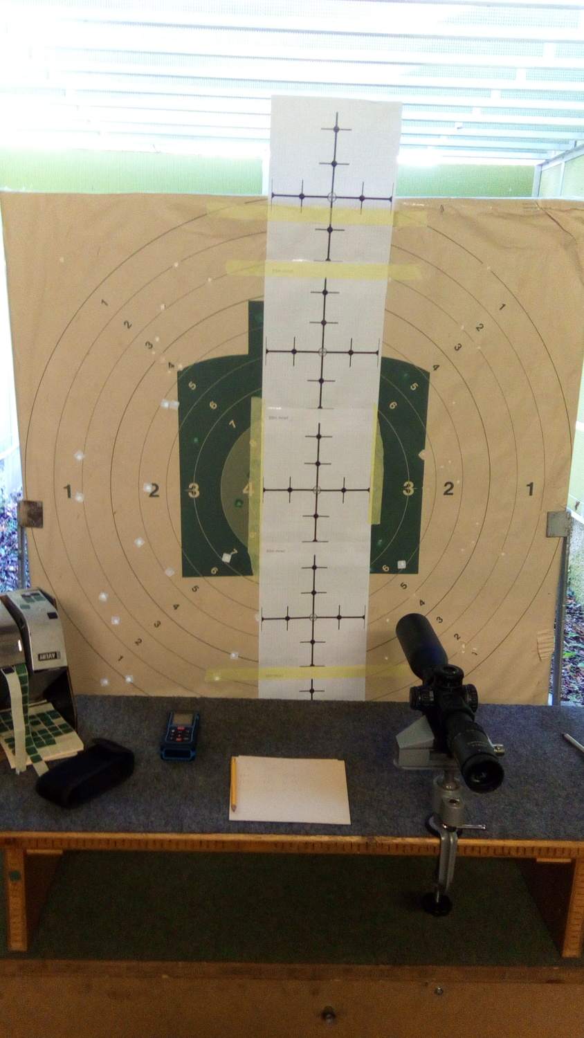

I have one of these – the Vector Continental 34 mm 3-18x50 FFP – for about a year now. I will start by saying – this is dramatically better than all I have seen from China before.
Bought it because (1) I do not have $$$ to equip all my rifles with S&B or Kahles and (2) because I like pain an suffering. On pt. (2) that was a big disappointment – the tool actually works way better than I could have expected.
Yes, they are doing it right – FFP, mil/mil, zero stop, 44 mrad of total elevation (higher zoom models don’t have that). The huge elevation range means I can fix it on a 0 MOA mount and still be able to click 99%+ distances I can reasonably reach. There are 20 mrad of available elevation (newer versions apparently can use 30 -- here goes the "long range" .22), 10 mrad per turn, turn indicator is done the Kahles K style – a small button which raises from the elevation turret.
I checked the click value, for elevation it’s 98% of the announced (204 clicks for 20 mrad), for windage it is 100%, and it is uniform across the whole adjustment range. Mechanics are precise and repeatable. Tactile clicks ok.
Did not try it on a 338, but after 1000+ rounds of 308 and 7.5x55, it did not hiccup (I continue the observations). It has successfully survived freezing temperatures and heavy rain (I wait to have both at the same time to see how it behaves).
Optics are very good. It is certainly not worth a S&B or Kahles, but for the price this glass quality is quite unseen.
The photo does not do it justice (I am a poor photographer); there are no noticeable distortions or chromatic aberrations.
The depth of field beyond 400 m, and the eyebox are comfortable. Parallax correction actually works, and works from 10 m or so, which makes it a good dry fire companion.
A criticism: on low magnifications (3-4x), the edges of the picture are going out of focus. The camera exaggerates the effect, but it is noticeable to the eye (doesn’t bother me too much, as I aim with the centre).
I don’t much like the reticle, but this is not specific to the scope at hand; it’s a problem of all them new fashioned "christmas trees" – it seems to be designed to only work well on 8x or above -- the lines are too thin. On the other hand, I would have preferred a smaller central dot, but since it is the only part which is illuminated, the compromise is ok (the illumination, btw, works as expected).
All in all – excellent value for money.
