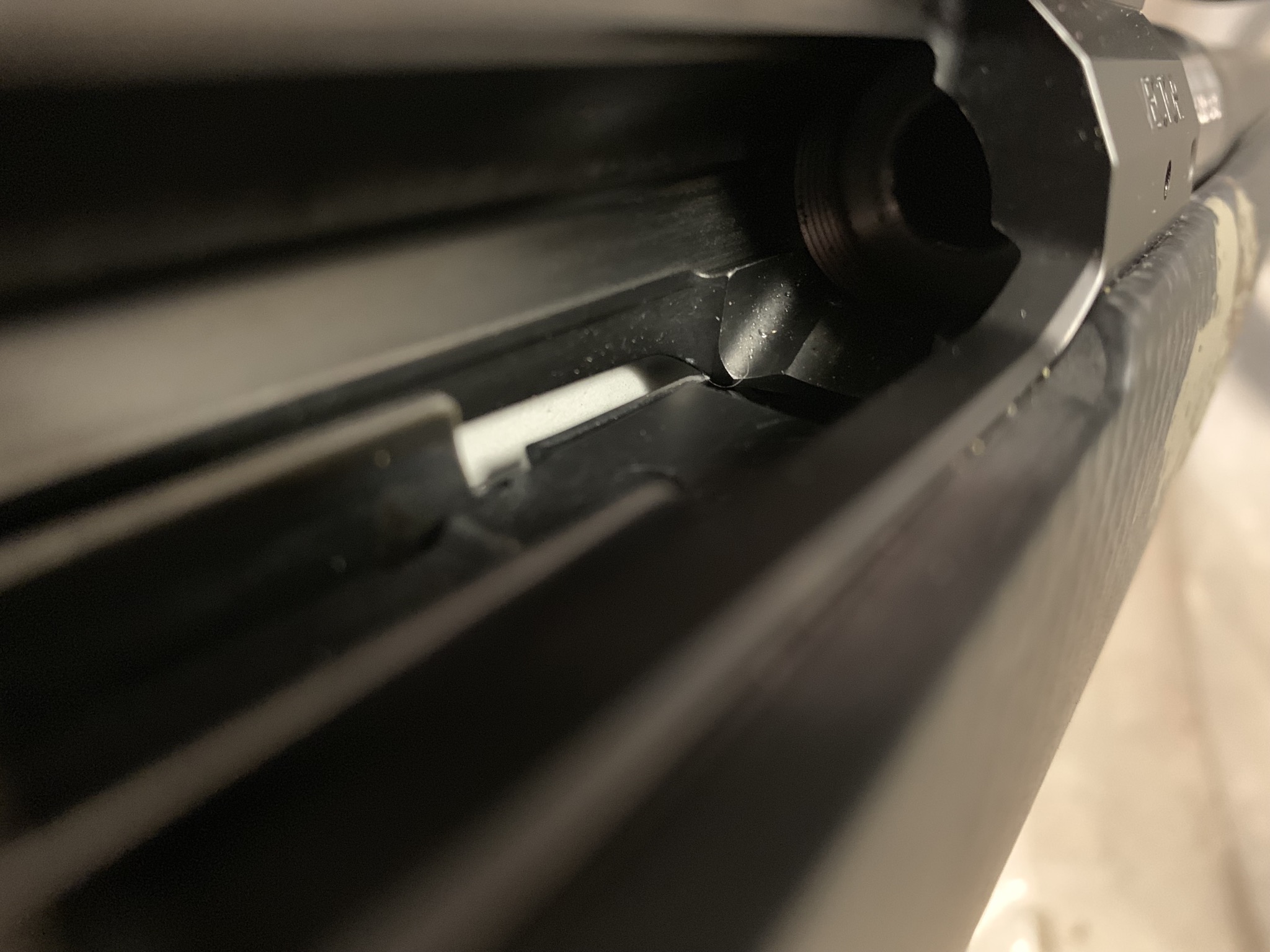

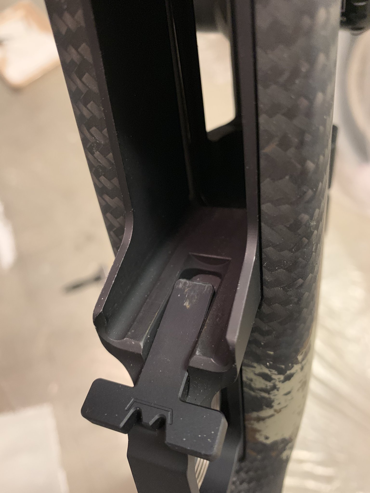

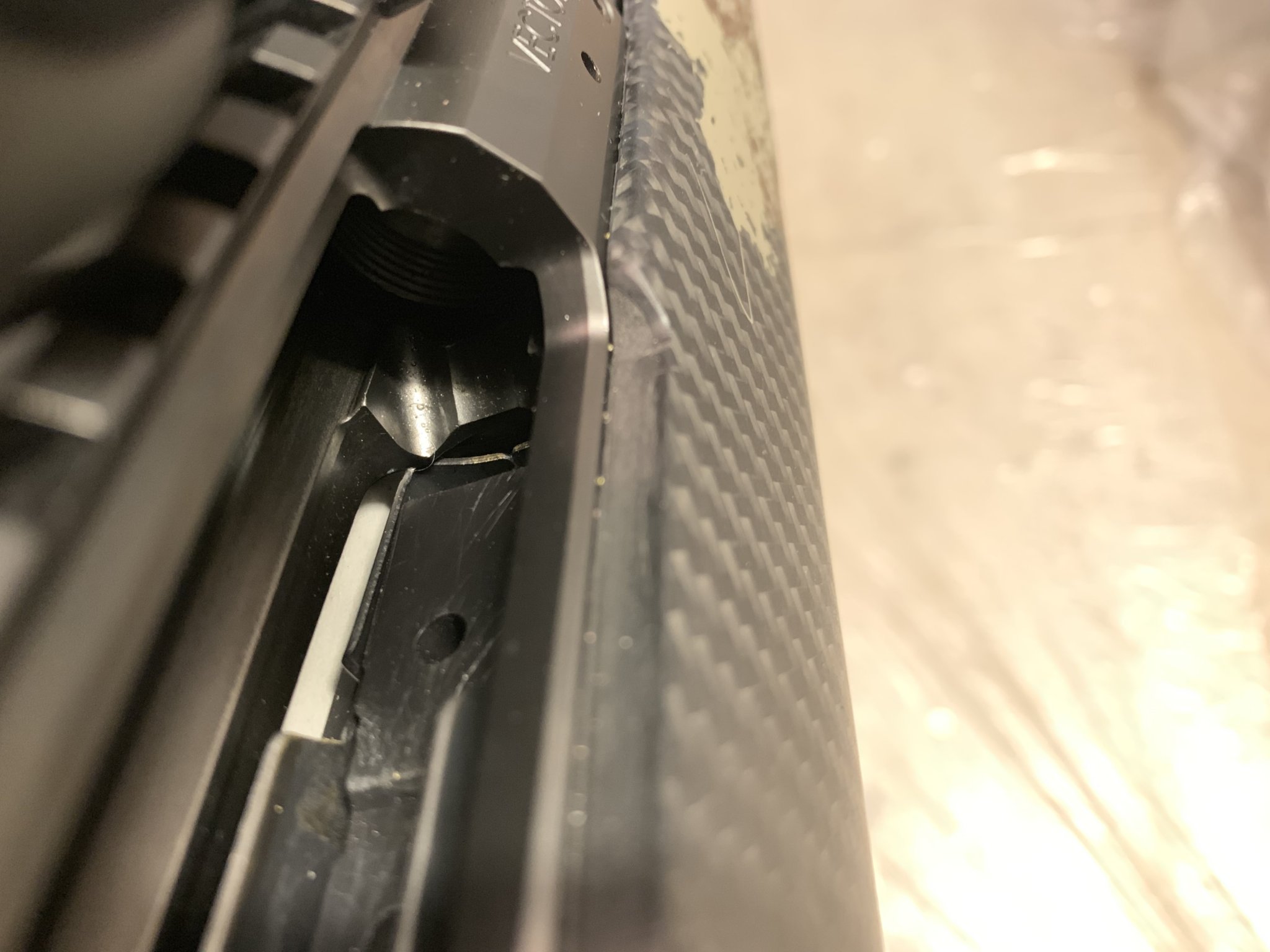

Can you rest the rifle on the mag and it still cycles? Just curious.
J Allen chassis = no cycle
Cadex = cycles
Will find out about kmw sentinel in a week or two.
Yes, resting rifle on magazine is no problem. I can push the mag into it with force and it still cycles. When forcefully pushing the mag it has more resistance but it does not jam.
Wild that with as much mods built into a j Allen for magazine seating it can’t be made to work??
Reactions: Redeye3
I haven’t messed with the tightness of the mag adjustment. So that might make it work. But I don’t think so. There’s nothing in the magwell that I can see that stops upward movement.
Is it an older j Allen? They have a YouTube video from 2018 showing a hex key adjustment behind the mag release to alter mag catch height and adjust mag depth and bolt clearance.
It’s the newer one. Problem isn’t with those adjustments, there’s nothing that keeps the mags from going up. Your manners has a lip or something that keeps the mag from going too high.
Reactions: DangerRanger
Hmm I’ll look tonight, it has Mesa M5 dbm I don’t remember A lip but not to say there isn’t one. Which would probably be great for people with these issues as it’s a cheap and available dbm option.
Update here’s the mag catch on Mesa m5 dbm
I see no other lips to retain the mag, mag doesn’t move enough to contact that upper ridge (.25” ish)
Mag contacts action at front of mag and limits upward movement
