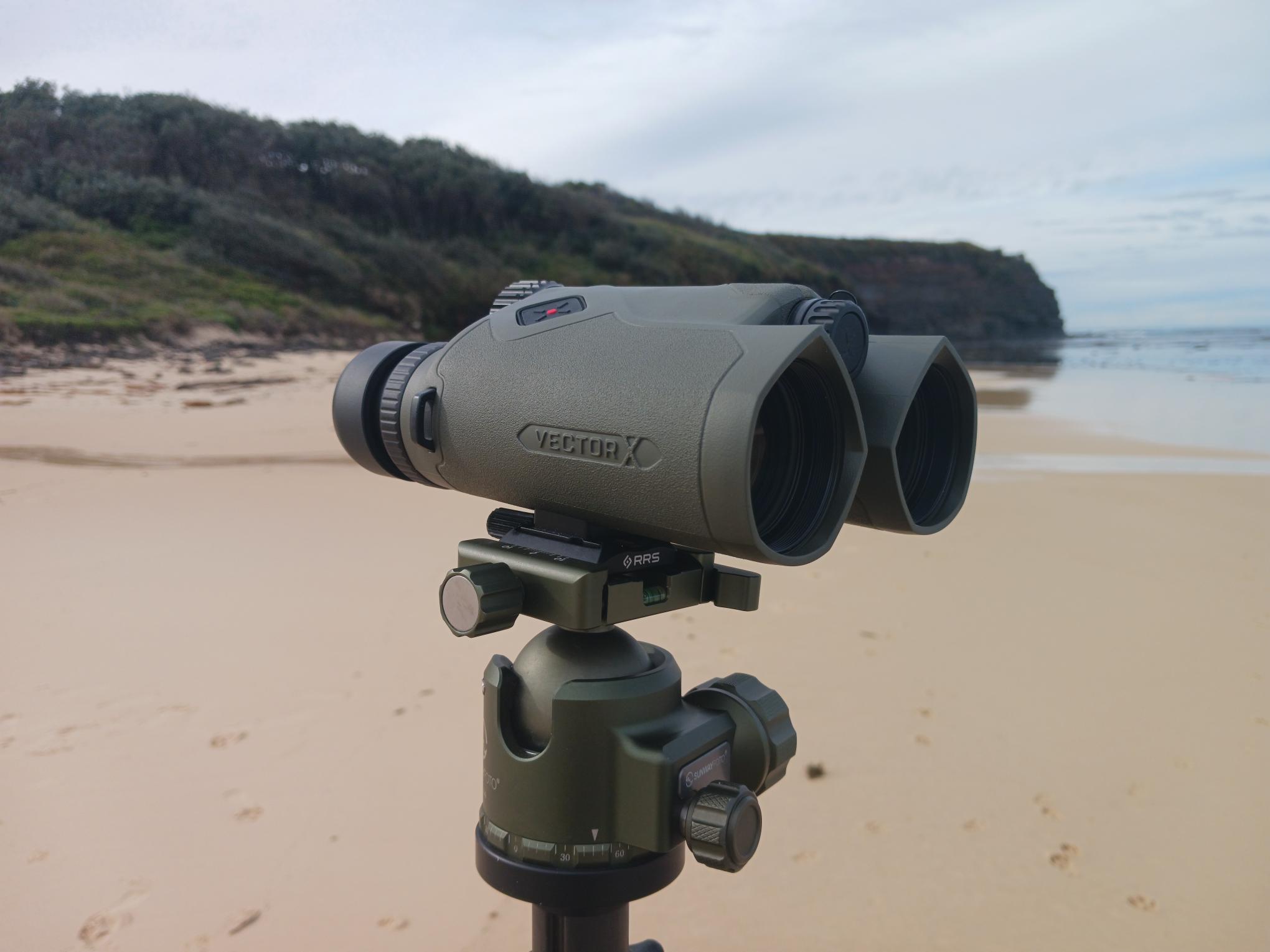

The Vector X binos come with arca mounting plates for use with a tripod out of the box. No more weird lasso type mounts.

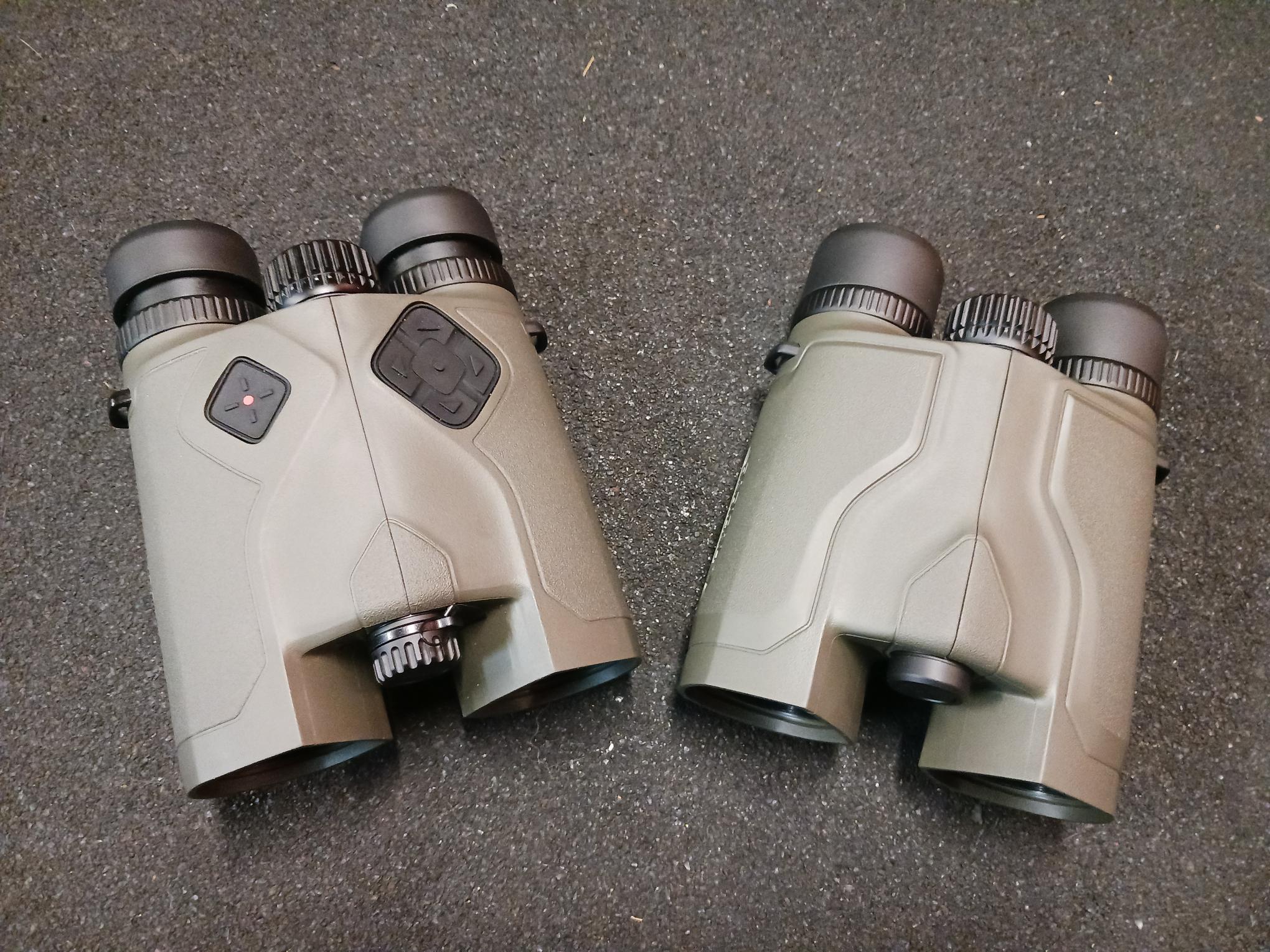

Brilliant. The Vector X dominates our Terrapin and the other brands we have. The refined aiming mark is pretty well spot on. We took the Vector X and Terrapin to the coast to get some longer sight lines. The surf was rough and there was heavy sea spray. The Terrapin X failed to cut through the spray and was able to reliably range a piece of white cardboard approx. 50cm tall and 70cm wide at 1250m. This isn’t reflective of what the Terrapin can do, just in the conditions we were in. The Vector X cut through the atmosphere with absolute ease and ranged our cardboard up to the maximum distance we could actually get to which was 1978m.
Unlike the Terrapin X, there’s both a Lase button AND a menu button WITH separate navigation buttons on the Vector X. This is our main gripe with the Terrapin. Once we lase, we have to wait a couple of seconds before we can go again. The Vector X doesn’t have this lag.

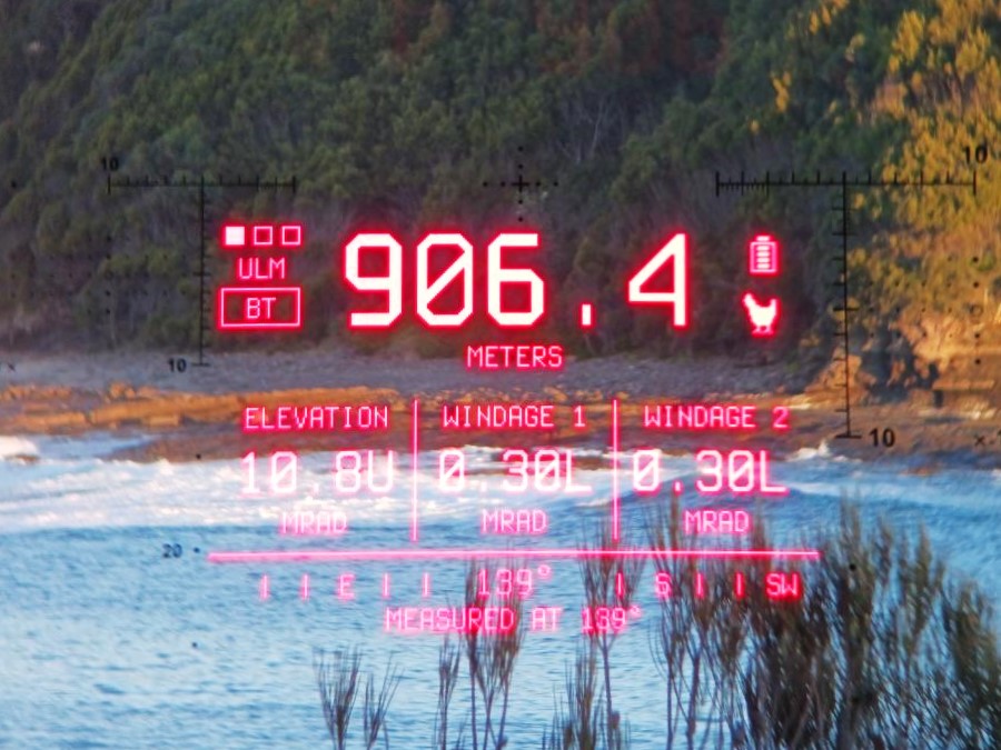

Inside the Vector X is a small HUD display. Like the reticles, it is only visible in the right tube. The HUD provides most of the information you’d find in your kestrel. Elevation hold, wind hold, and direction of fire are all displayed cleanly and are plenty large enough to read.
The HUD display is between the 2 reticles and just under the centre reticle for the LRF. This means it doesn’t impinge upon your view of the reticles, and vice versa.
The separate menu buttons and their respective scrolling buttons are exactly what you’d find on the Kestrel. You can scroll through menus and change the display to provide you with different information. These include; Environmental information, Gun profile information and profile select, range card, and then settings for the Binoculars. It’s great. It’s so easy to navigate through. Huge win here.
To view the information, you are required to look through the binos though. That’s a little inconvenient compared to the kestrel but it works. The Vector X however, doesn’t give you wind speed or direction. You need to use a separate device for wind, OR, be very confident in your wind calls if you aren’t going to bring another device with you. The wind information is manually input into the binoculars to give you a hold. If you already have a Kestrel, do you need the AB function? Probably not. Not that kestrels are heavy and bringing one with you to get wind info is a huge burden, but you’re paying for a capability you already have.

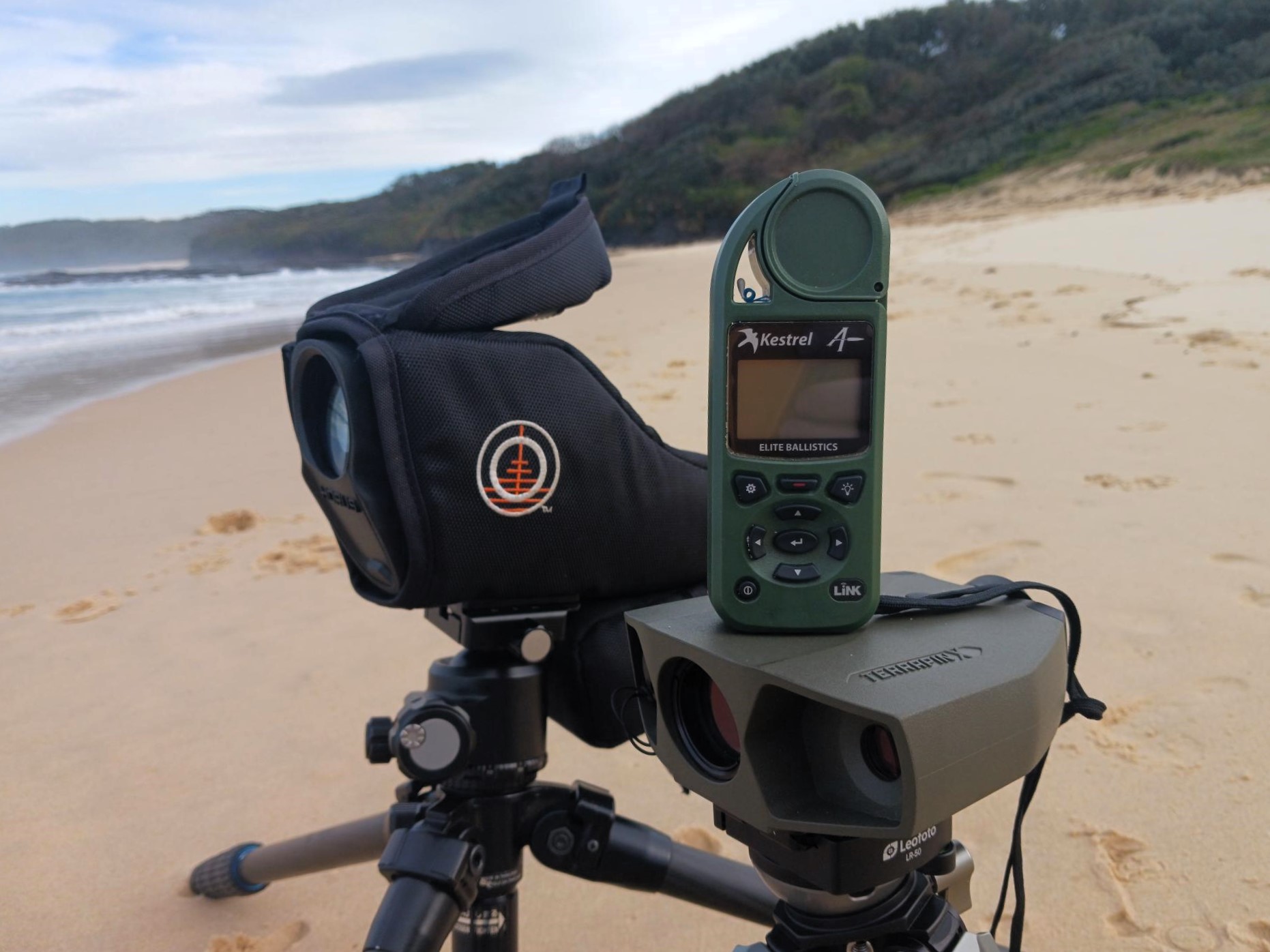

We shot out to 650y from a couple of different angles to have to change wind calls. The target was a 30cm steel plate.
We ran tests to see how long it would take for the spotter to give the shooter a wind hold and elevation hold with the Vector X vs our dedicated gear.
The Terrapin is Bluetooth linked to the Kestrel. We ranged the target with the Terrapin, which sent the data to our Kestrel and we gave the hold and wind, then jumped onto the spotter and our shooter took the shot. No dramas. Accurate wind call, accurate elevation, clear impact on target through the spotter. The majority of the time here was lost jumping between the LRF and the Spotter. Interestingly, we decided to adjust the mag range of the spotter without looking until it looked right and we thought we could see what we needed to. This was 15x. 1x off the Vector X with the range enhancers fitted. So the mag range really isn’t an issue.
Time to test the Vector X. We ranged the target, got the hold, didn’t come off glass, shooter took the shot. Results were faster than using the separate gear. But, there’s a couple of issues with the tests. First, we pre-positioned the spotter and the terrapin on target. They were ready. To lase, the Vector needs to be centred, then adjusted to see the reticle to spot the shot. Additionally, the shooters already knew the wind call from the previous string of shots.
The solution,? Get up and move and reset ALL gear as if we had just got to position. With this test, the Vector X was the clear winner. 1 device, spotter doesn’t have to move themselves or gear. Loosen a knob, align, good to go.

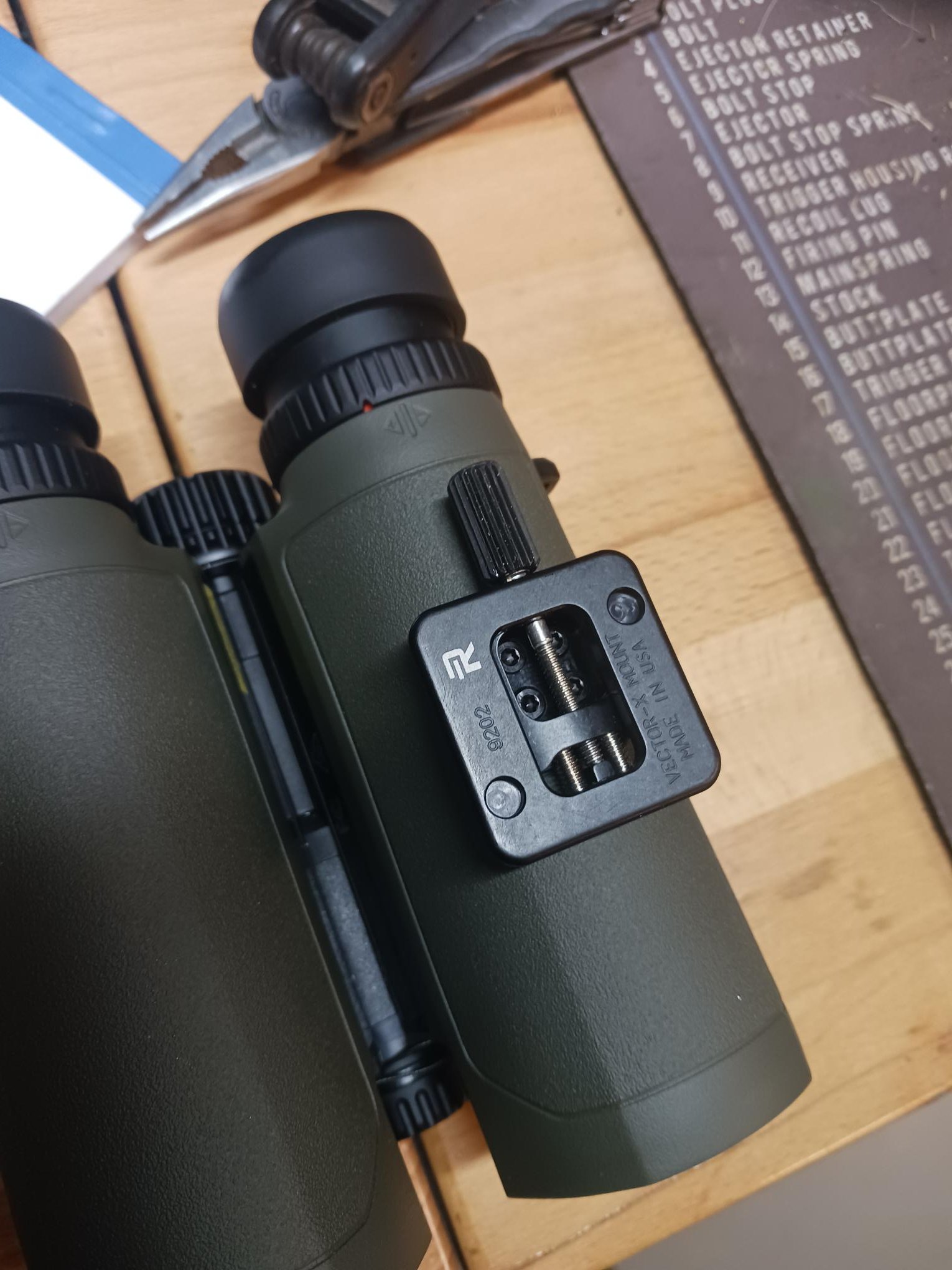

@Zigjib great review! does it infact come with its own arca mount that screws into the bottom? Or are you referring to the RRS or Area419 offering? If it does have its own, is it small and low profile? Thank you!

G'day mate,
No, the wind is manually input for both speed and direction but its SUPER simple to do. Almost exactly as you'd manually input for the Kestrel. It's really intuitive with the menu and scroll buttons. If you're confident in your wind (or if you're not and you want to bracket) it's done in a couple of seconds. Wind 1 and 2 are both displayed on the primary hud screen too so all the info is there. That's a good question about the arca plate. We were given this as a demo to get hands on and it was in the box. I'll check for you if it's after market or included but here's the size;
