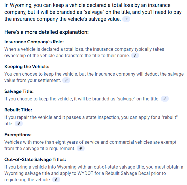

Amount to total is state dependent. Wife's jeep had major hail repair last fall. Every panel, new hood, new tail lights, and windshield, it looks almost as good as new, but great for a 5 year old car with 110k. It was probably around 70% of the value, but Wyoming is 75% of value, and used values are still pretty high.
Looks like TX is 100%
