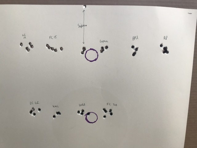

Yesterday, I tested that load shooting groups at 100 yards while helping a buddy break in a barrel.
Here were my results with various types of brass:
Brass, Average Velocity, SD
FC15 2,631 14
FC 308 2,651 9
Lapua 2,650 17
LC 14 2,646 11
LC LR 2,657 8
PPU 2,652 9
RP 2,643 6
Winchester 2,607 12
WRA 2,628 6
Some of this was surprising. Winchester having the lowest velocity was expected.
The Lapua was unsized but chamfered. All groups except FC 15 were MOA or less. FC 15 likely should have been better. I had too much glare on my scope’s front lens. Velocities were recorded with a Labradar.

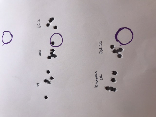

I shot the load again varying primers.
Primer Velocity SD
CCI 200 2,648 14
CCI 34 2,675 32
CCI BR2 2,646 22
Winchester LR 2,660 17
Fed 210 2,656 single digit SD but labradar didn't register all the shots
Primer selection definitely affects consistency of velocities.
