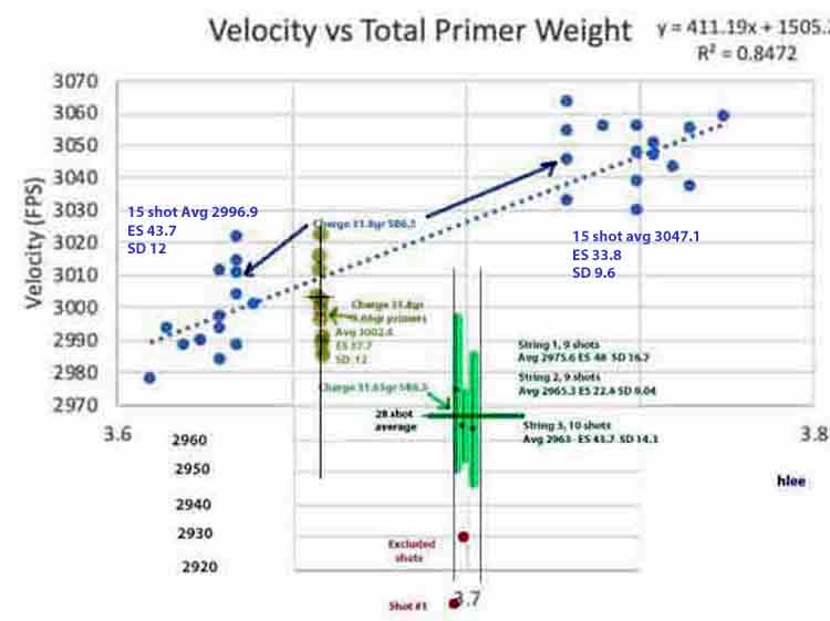

The charge that produced the data in hlee's plots was 31.8 grains of SB6.5.

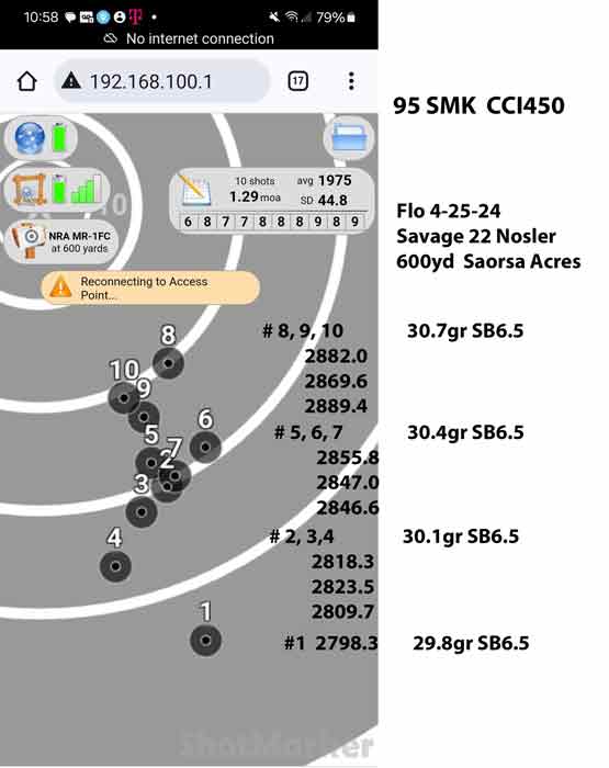

I have settled on a velocity over several range trips of just under 3000fps with the 85.5s.
Groups opened up if I went much over 3000.
I get about 12 to 15fps per tenth of powder.

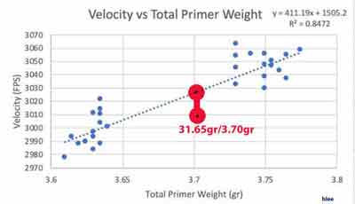

To see if the plotted data, Velocity Vs Total Primer Weight, will hold I will load 31.6gr with 3.70grain primers.

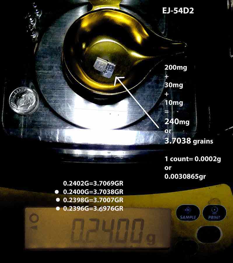

Getting ready to do some sorting (3.700 grains).
Check weights 200mg, 30mg, and 10mg. I use ASTM Class 1 and 2 weights.
Using gram mode, low range on my EJ-54D2 gives me 0.0002g resolution (0.00309grains).
0.2398g +/- a count should do it.
I might even drag out the A&D ER-182A to spot check results.

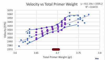

I'm going to use hlee's curves to drop charge a little to 31.60 grains (15 rounds) and 31.70 grains(15 rounds) and go up to the 3.700 grain primer bin to shoot for 3000fps +/- a little.
I've been up to 32.5 grains of SB 6.5 with the 85.5s but groups opened up. There's probably another node up there somewhere above 3100fps.

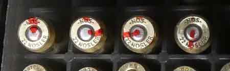

Was up late last night and thought of this.
Primer Orientation might make a difference.

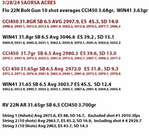

Well, off the primer sorting quest for a while, loading some for the wife.
Previous trip she shot 20 shots then quit, Sinuses.
10 with WIN41 Primers and 10 with CCI450.
Flo 3/21/24 Savage 22N
CCI 450 3.66gr 31.8gr SB6.5 85.5
10 shots
min 3002.3
avg 3018.2
max 3033.1
ES 30.9
SD 11.2
WIN41 3.66gr 31.8 SB6.5 85.5
10 shots
min 3031.3
avg 3061.0
max 3082.1
ES 50.8
SD 16.7
I have 10 more of each loaded the same night but will load some with about 1.5grains less powder.
Velocities were on the high side. That will give her 10 WIN41 with 31.8gr, 10 with 31.65gr, 10 CCI450 with the 31.8gr load and 10 with 31.65gr.
Plus a few foulers.

What is the datum point for which you are orienting the primer position off of?

Yes, the modified graph is a guess, that turned out wrong :)
I reduced the powder charge for mine (AR)
and tried a small range of charge for the wife's Bolt gun.
Got an unexpected drop in velocity with the 31.65gr charge from the 31.8gr charge.
Here are the numbers, no graphs.
Added medium primer (3.66gr) 10 shots to above image that were mingled in with the blue ones (test 2).
Maybe I can find a few primers in the 3.710 to 3.715 range and load with 31.8gr for a later trip.

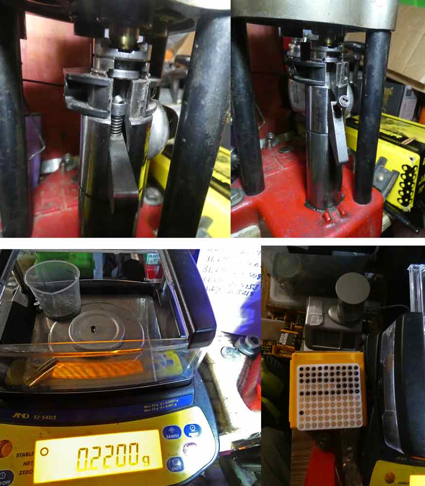

As far as losing crud from the primers, probably very little is lost. I see no clumps of crud coming out of the primers. I very carefully remove them, weigh them, and put them in the flat in order shot.
Popped a few out.
First one of string 1, the really slow shot, started out as 0.2396g, ended up 0.2194g, for a loss of 0.0202g (0.3117gr)
Garmin velocity was 2910.3fps. Something other than primer compound going on with this one.
The first one from string 2 started out as 0.2394g, ended up 0.2198g, for a loss of 0.0196g (0.3025gr)
Garmin velocity was 2952.5fps
The first one from string 3, started out at 0.2398g , ended up 0.2200g for loss of 0.0198g (0.3056gr).
Garmin velocity was 2955.4fps, First one from string 3 shot yesterday (post #69).
The other outlier, shot 4 from string 2, started out as 0.2398g, ended up 0.2198g, for a loss of 0.0200g (0.3086gr).
Garmin velocity was 2929.7fps.
The average weight loss of the 15 heavy from previous test was 0.3597 grains,
The average weight loss of the 15 light from the previous test was 0.2617 grains.
Looks like the loss in this test of 30 medium (3.70gr) will be closer to 0.3070 grains.
Will post weight loss vs velocity results for all 30 when I get around to popping the rest out.
The heavy/light test was with a charge weight of 31.8gr of SB6.5,
this last test was with a lighter charge of 31.65gr of SB6.5.
Velocities were lower, of course, but the mid weight primers also had mid weight losses.
Go figure.

I sorted Murom SRM primers for low, middle and high weight and I have a plan to test them at 1000m for vertical difference. I weight them with beam scale, so I don't know their exact weight but I only separate them in 3 different weight classes: low, middle and high.
Maybe I will post results here. But probably I won't measure muzzle velocity, because I'm selling my Labradar, I will only have targets and velocities from ShotMarker.
Reactions: Rocketvapor
Even with a beam scale, sorting low, med, and high you should still be able to detect extreme outliers in weight.
Getting those few out of your competition load might help.

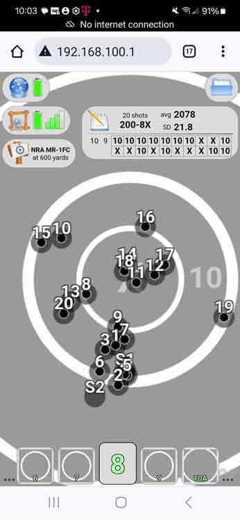

Now, back to the wife's bolt gun results.
I have to be real careful making comments that might embarrass her during a match but on her third string she had a run on 10's and asked her to STOP and evaluate her string.
She adjusted vertical, shot a few, adjusted up some more and shot the rest.
Would have blown the 200. Even then almost had a couple windage 9's.
Reactions: RegionRat
Yeah, after I went to all that trouble to sort her primers :)
She's still a little tense at prone competitions.
Third match after moving from an AR to the Bolt gun.
Saturday was an improvement from 97.5% to 98.7%.
Still out shot me though.

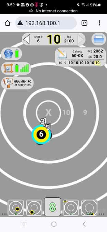

Did a abbreviated ladder Saturday @ 600yds.
Wife and her Savage 22Nosler, 95 SMK, SB6.5 and CCI450.
30.7gr is right at 100% fill seated about 15 off.
Now to fine tune the charge.
Normally shoot 85.5s @ about 2990fps.
The 95 might be better when she moves to 1000yd.
I don't think we have squeezed all we can out of the SB 6.5.
The 22 Nosler gets really low speeds (per reloading data) with many of the popular powders.
I know speed isn't final goal but until we get better I'll stay with it.
I get anal with charge weight, finger trickling to +/- one count that turns out to be about +/- one little granule.
