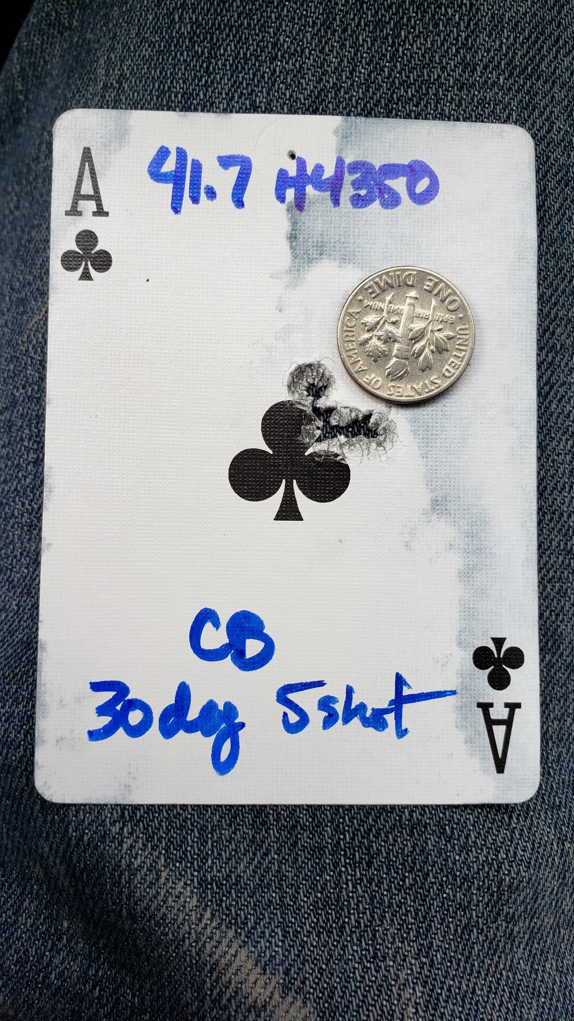

I've confirmed a load using 41.7gr H4350 using my Red lot of brass multiple times and it's been 2762 avg over 4 sessions with 10-20rounds chronoed each time using Labradar.
Yesterday a new test batch shot 2790avg which is WAYYYY faster. Then I shot a few of the prior batch and they still clocked right at 2760 right after shooting a series of faster rounds. 100% sure all have been 41.7 on the RCBS but something changed (not the barrel).
