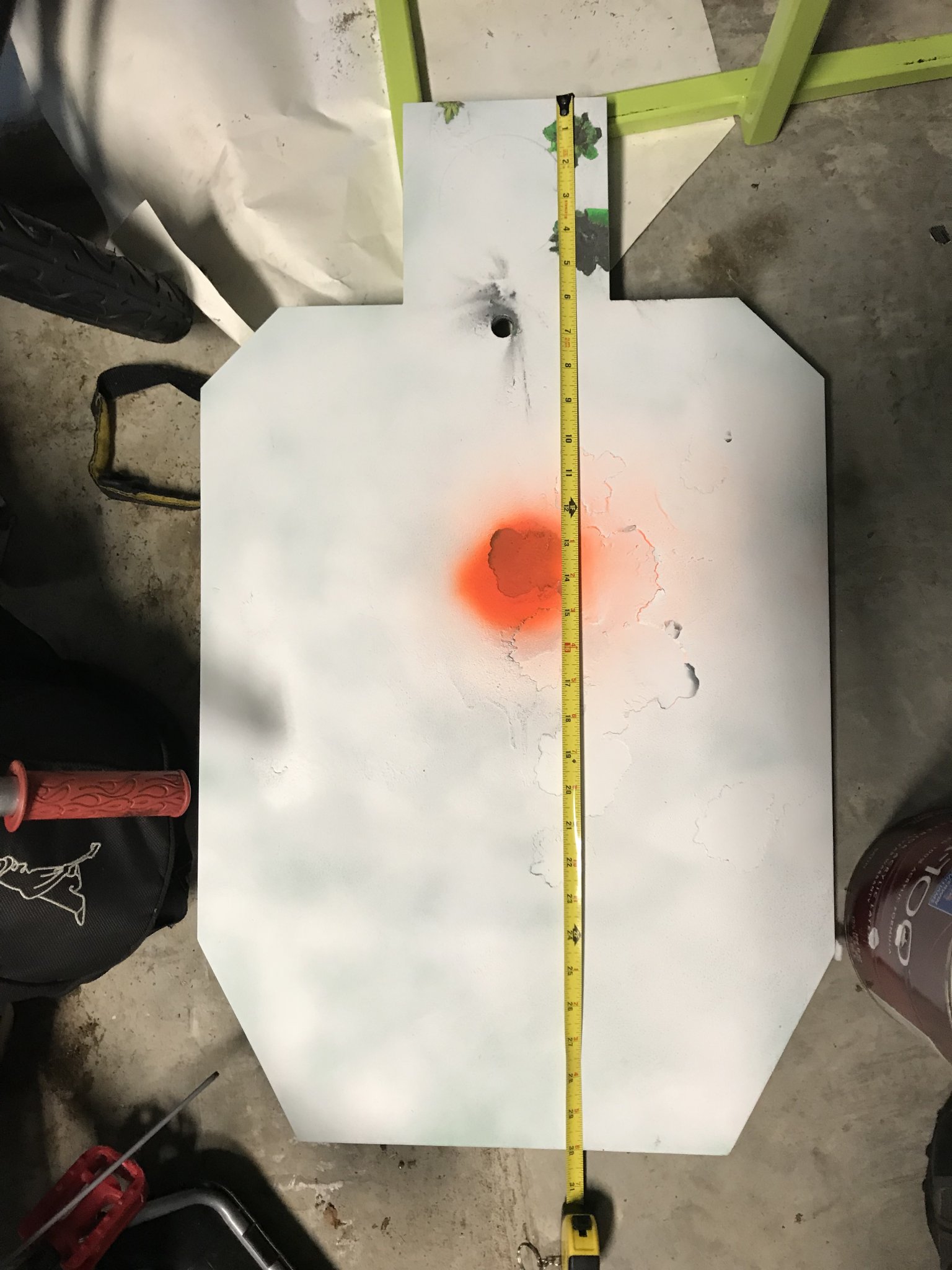

I appreciate it. I was missing high in this case, though. Trying to recall the lighting conditions, my range faces north and I was there from 7:30 to around 11. Sun to my right and rising, no cloud cover.
These were my hits at 800, aiming at the orange
In my experience shooting INTO the sun (West) in the evening, my impacts will be .3 MIL high at 900 yards. Shooting the exact same setup the next morning with sun at my back, NUTS on.
I have done this 3 different times and lost sleep over it, the sun/light WILL affect your POI or more so where you think you're aiming. My experiences have all been shooting HIGH, not low.
