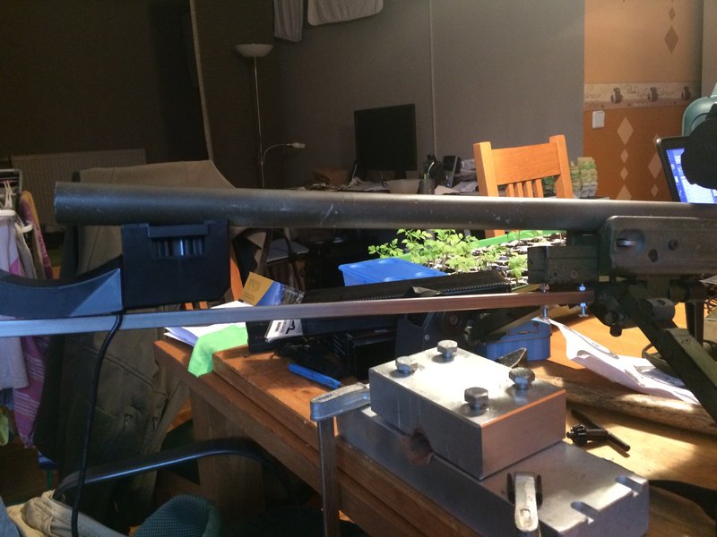

Thats from working on it basically a SS profile screwed on homemade picatinny spigot with two screws that set angle. I don't have any videos of me shooting but i would suspect that this SS profile is moving and bringing magneto out of alignment hence weird results. Spacing and alignment is OK when mounted and it also looks ok after the shot. But frankly i stopped measuring speed during load development and i focus on groups and measure only when searching for max load and after i find good loads i measure them in 10/20 shot string.
I wonder if you put a couple offsetting 45s in it so that the end of the rod came up parallel with the barrel so that you could attach it in the correct position rather than precariously balanced on the wire that comes out the back.
Pic was taken during work and when i was measuring where will i cut the rod off and drill a hole to mount magneto on the rod (used magneto factory screw to put it firmly on a rod).
Rear two screws (4 actually:) ) control angle and distance of the rod, raise behind, lower front, lower behind raise front, move first up/down move entire rod up/down. Magneto is completely level, at least 1mm below barrel at its mounting point (where rubber should be). Im thinking either rod is bending or magneto hitting barrel when i fire and "shock" hinders accurate reading.
But i've given up on tuning this as its too much of a hassle (maybe during winter) putting it on/off and i simply don't to test that much since there are many matches now and i shoot known load...
