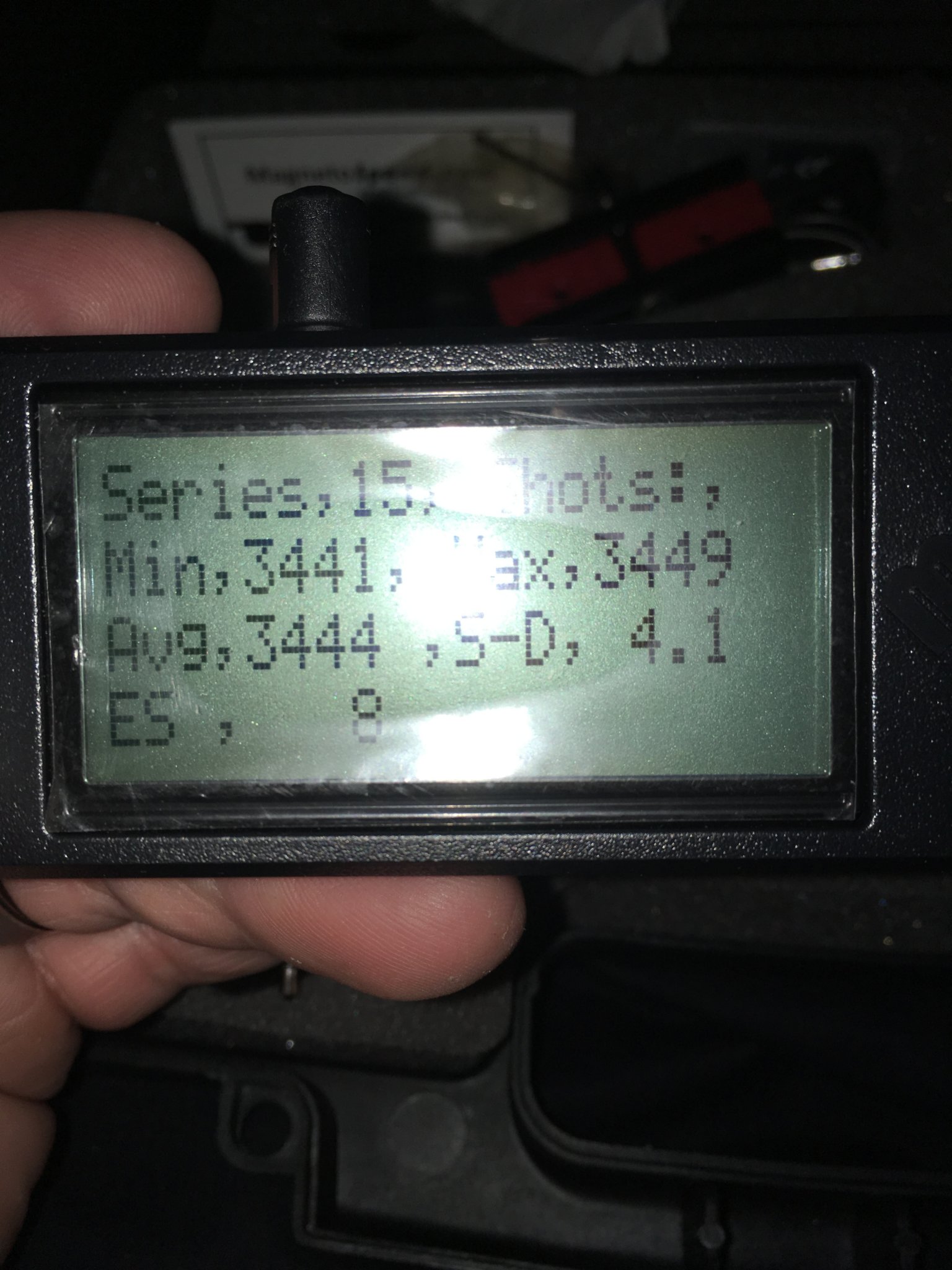

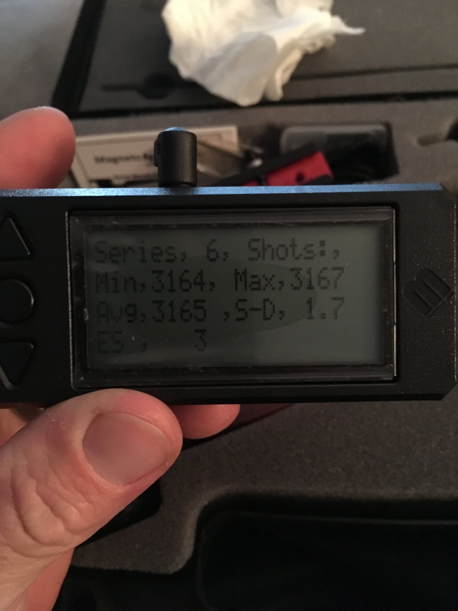

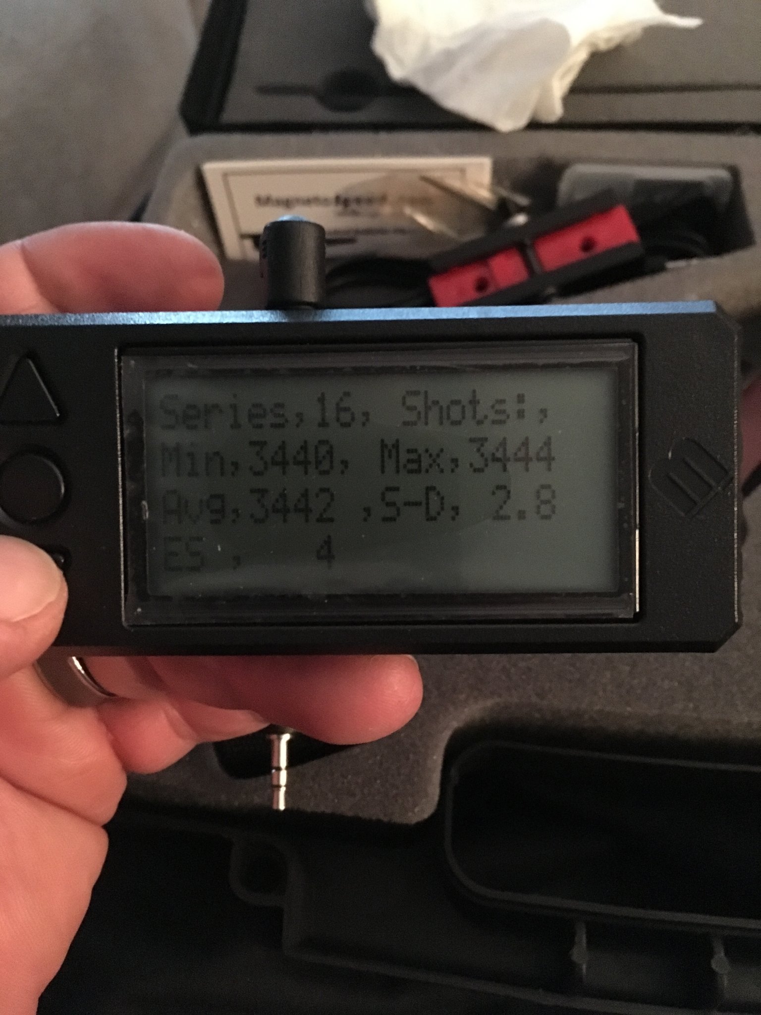

Fuck man I should tell my Labradar those ES 3-5 I am getting on my 6BR are false. And I had a hell of time yesterday "plinking" from 560-1200 yards.

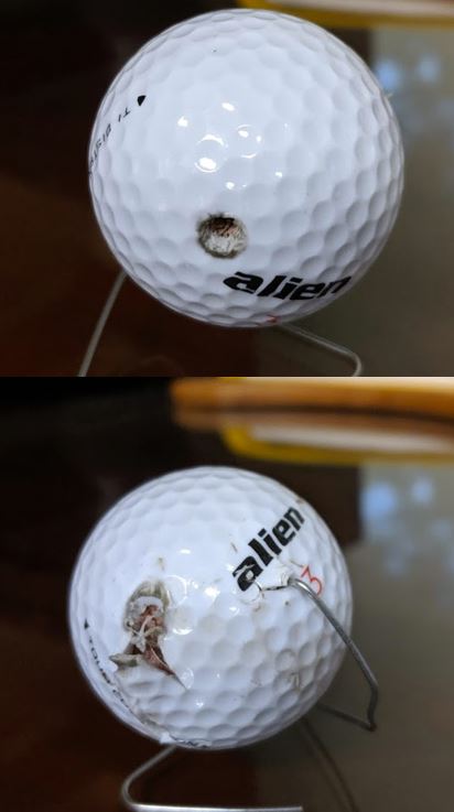

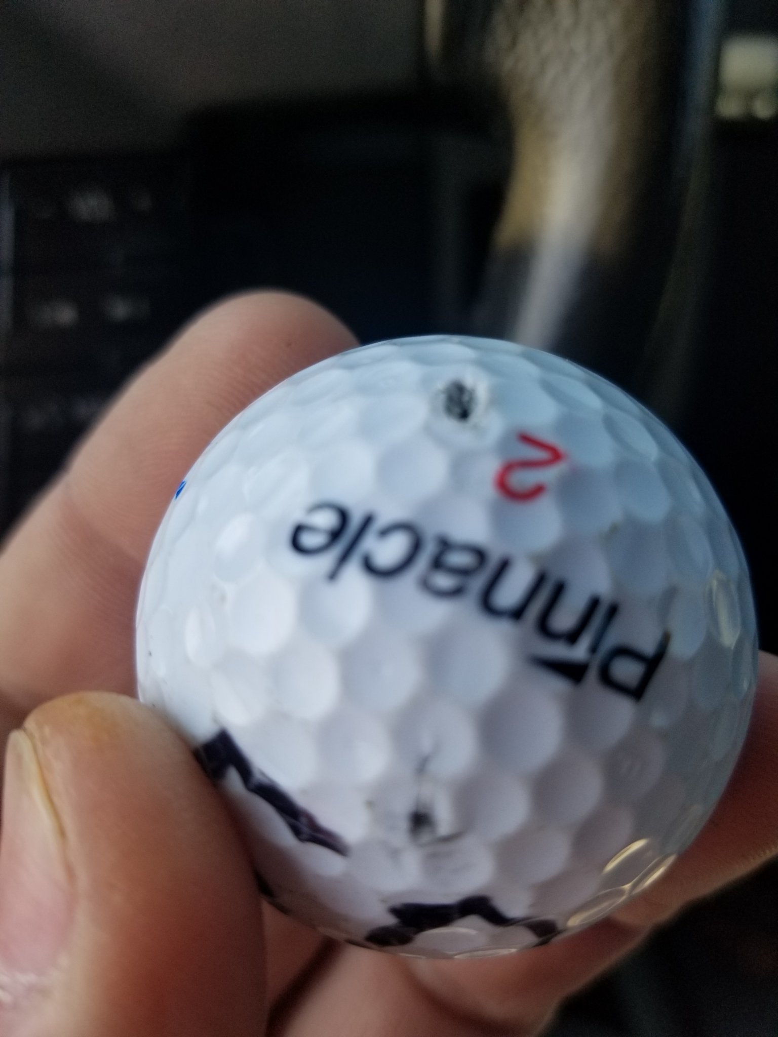

I've shot a few at 600 yards, my data sucked since I was roaming and it wouldn't upload. I took a picture of the first one I ever shot at that distance. I'm going to make a different setup so the ball hangs in front of a plate so you can spot the misses easier.
I wrap them with thin tie wire (the stuff used for motorcycle grips) then hang them in front of a blue shoot and see that is stapled to a piece of plywood. If you wrap the wire in a cross the ball does not go very far even if the wire gets hit with the ball. The suck part is when you hit the top wire before the ball.
Shot them on the ground and with tees drilled in to the top of boards. You don't always find those when the get hit.

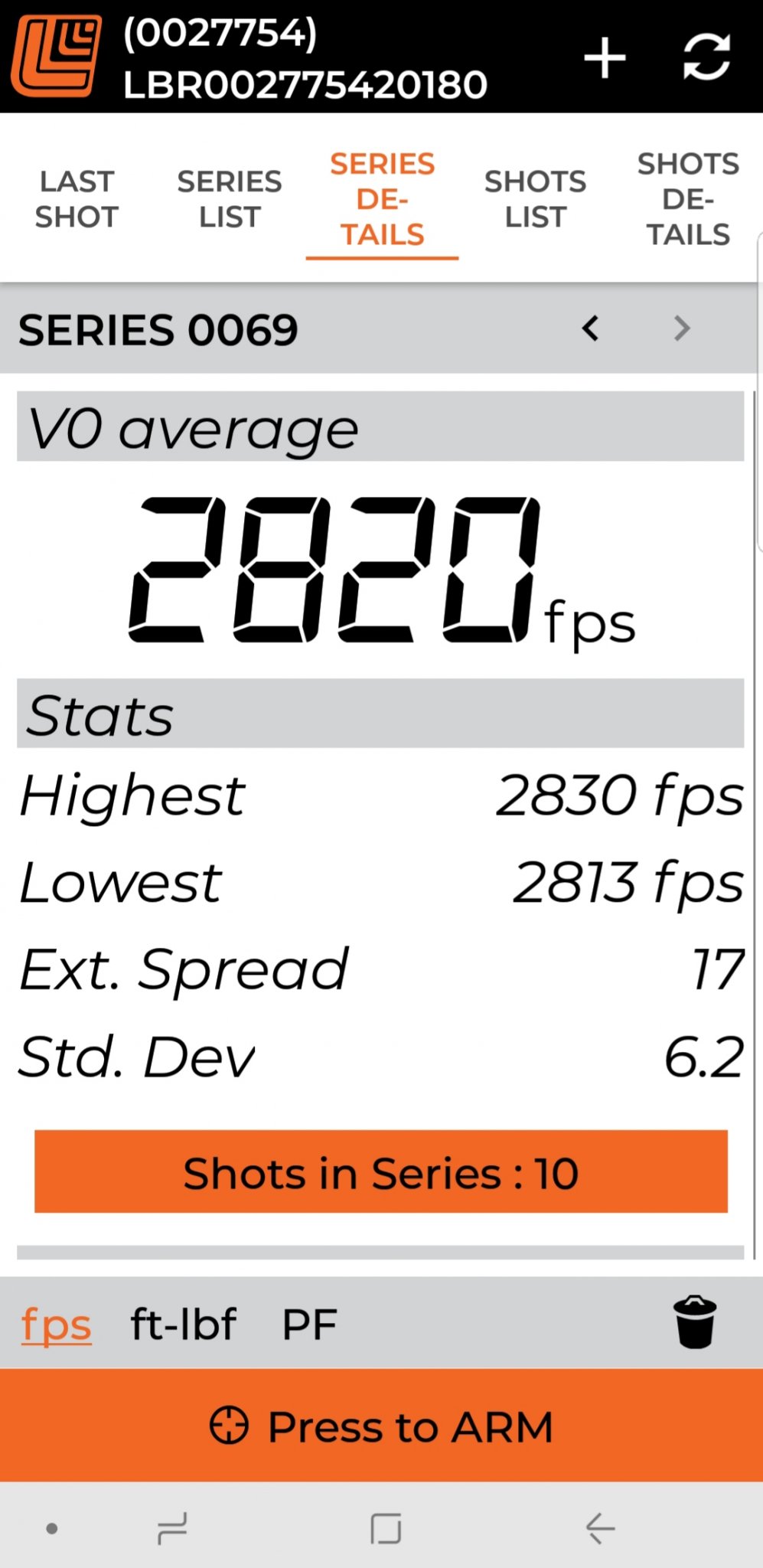

I'm not going to sit here and say the chargemaster is THE way to go but there are plenty of people able to get single digit SDs on them. In my opinion, where the autotrickler shines is being able to throw consistent accurate drops quickly, whereas the CM is capable of producing decent loads, but at the cost of much more time (ie lack of consistency, overthrows that need to be adjusted). Saying you cant get decent loads on a CM is just silly, it's more about how much time do you want to spend to get them.
If the difference between going 1 for 10 and 10 for 10 on a golf ball "in the desert" is that .02 scale accuracy, well then have at it. For the matches I'm shooting, getting my SD from a 6 to 2 is more of a feel good thing, not a practical improvement that I will see down range. And for that matter, I know a lot of guys getting around 5-6 SDs on an autotrickler. Which in my opinion is fine, because they are doing it 3 to 4 times faster than they were when they ran a chargemaster.
