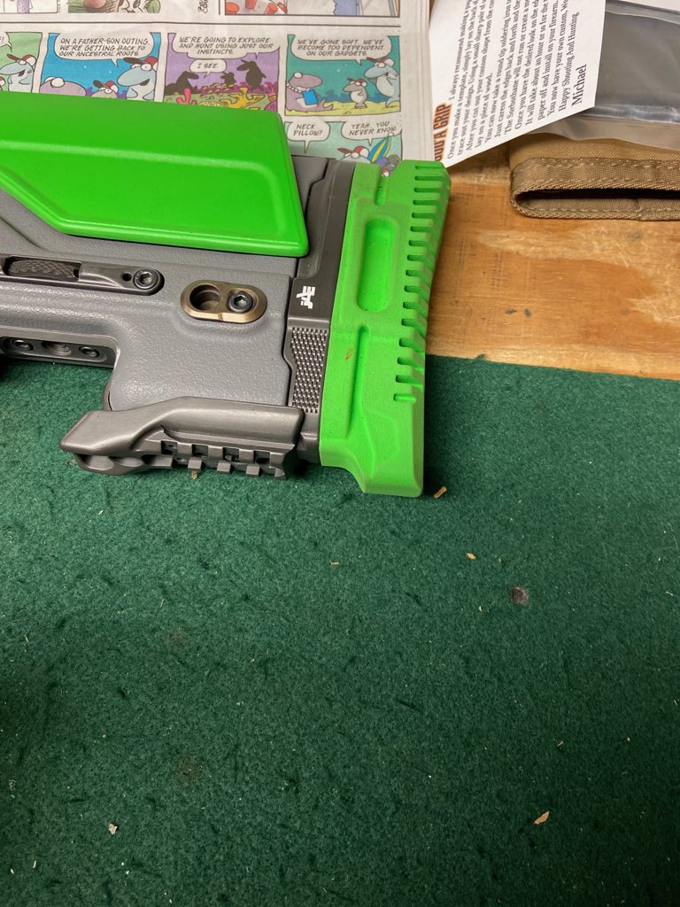

Ok, so this is how it went
This is the stock pad, right? 1 1/2" thick and not functionally optimal....that is, it ain't a great pad for recoil, IMO, and I can hardly believe that J Allen went to the expense of not only having a custom recoil pad injection molded.

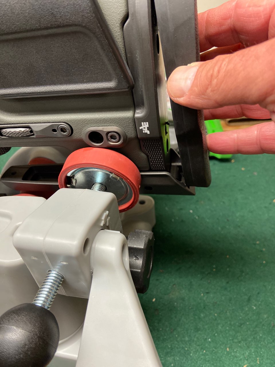

I found that the LOP was just a bit too long so I looked into having a standard recoil pad ground to fit. We went with Kick-eeze which I have on all of my shotguns and whose pads I like very much. But Pachmayr or Limbsaver would work just as well. Depends on what you prefer.

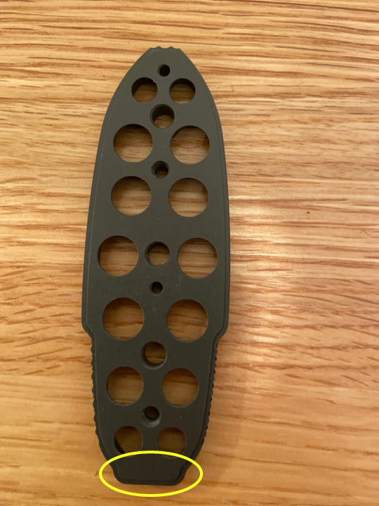

So, I had a couple of LOP spacers that came with a chassis I bought. The spacer has the exact same profile as the butt of the chassis. We used this as a template against which to grind the pad to fit. Please note the circled area at the bottom. If you still have the short PIC rail section on the bottom of the butt stock area, then you can grind a pad to exactly the profile of the butt (in my case, the spacer) and it will fit on perfectly.
However, I put a bag rider on on gun and it extends back further and interfered with the 3/4" pad we were using in the area that I circled. Looked like this (and compare to the pic above of the OG pad with the PIC rail section...you can see that the bag rider changes the clearance at the bottom of the pad). Looked like this and you can see we had a bit of interference at the bottom. So, we just trimmed that little section off of the bottom that is circled in the pic of the spacer, above.

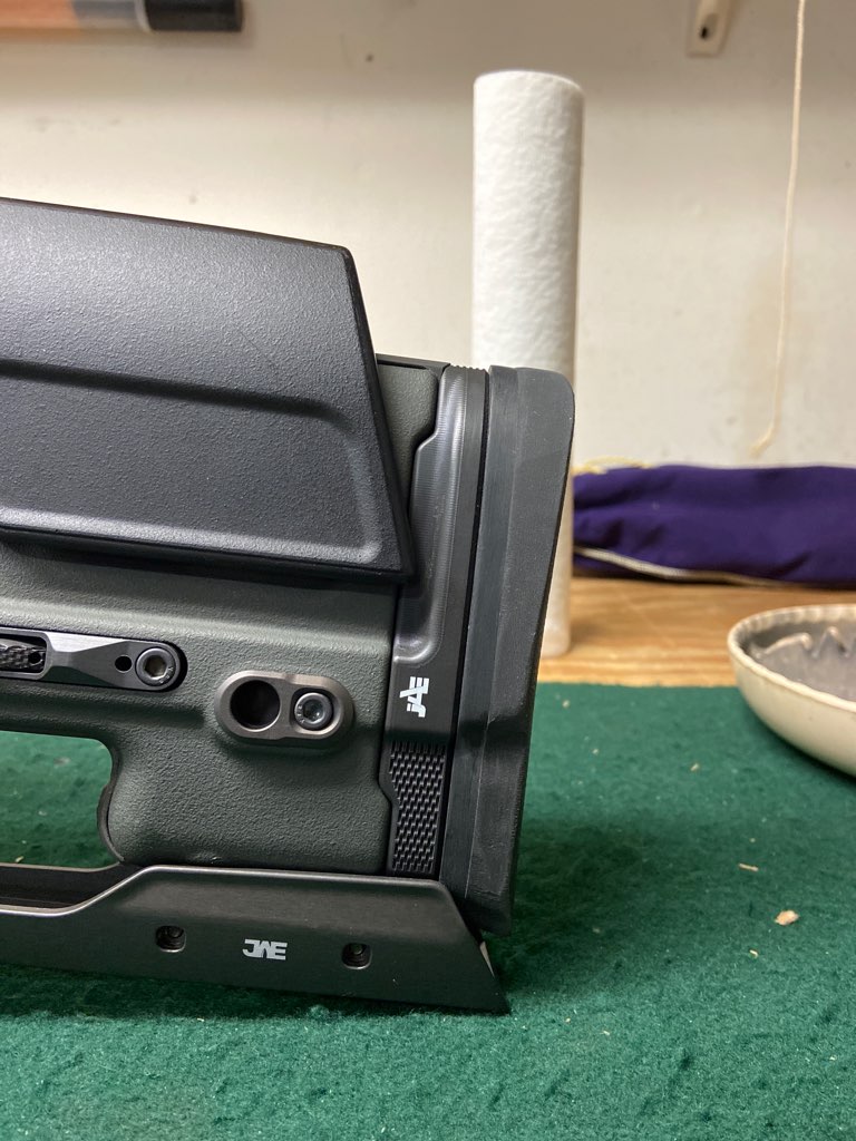

And this is the finished product. I suppose I should chide my buddy the stock smith about the fit at the very top...but considering he didn't charge me....I think I'll keep my mouth shut! hahaha
