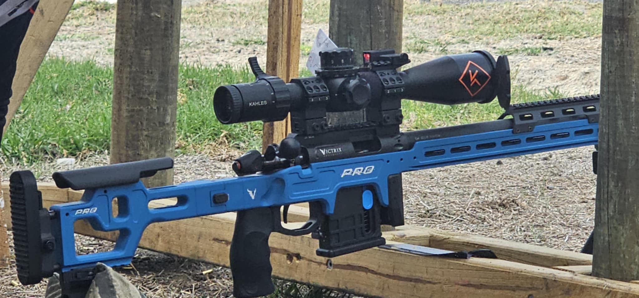

Yeah got a 26" Victrix Venus Pro. Great decision, balances great, functions reliably, not overly fussy on ammo. For an out of the box solution I'm extremely happy with it
