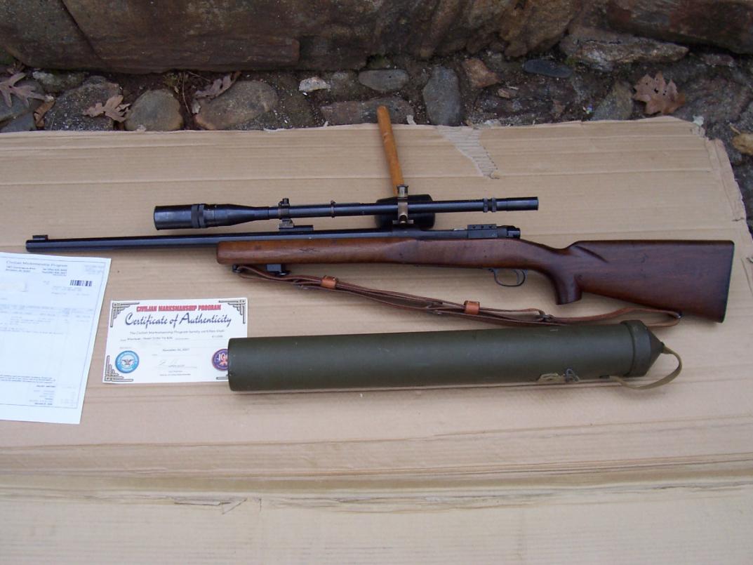

Well purchased a new toy today, can't wait to get it. I found a Pre 64 US Property Marked M70 in 308. The seller bought it years ago on a CMP auction has all the paperwork and shipping container. I've seen one of these at our Vintage Precision Rifle match at Quantico. This should be one of the USAF Security Forces Rifles mentioned in Senich's "One Round War" Will post pics as soon as I get her in.

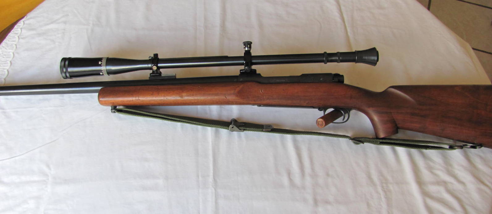

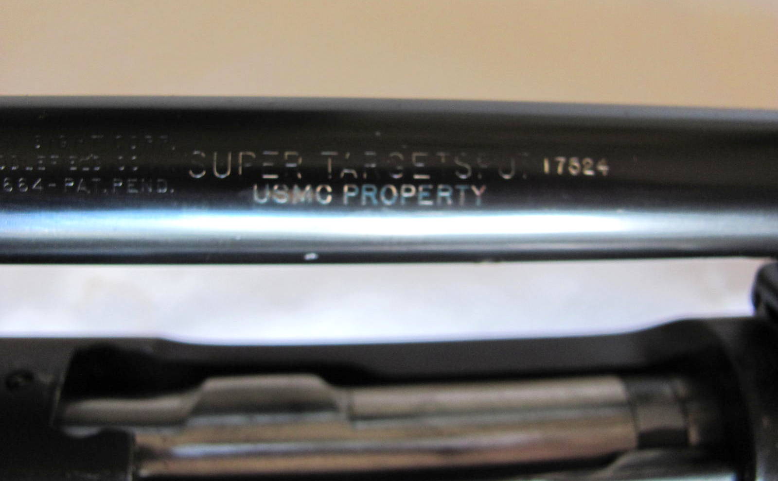

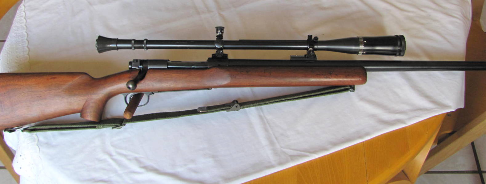

Here is my pre-64 National Match M70 in .30-06; marked "U.S. Property". Sold thru the CMP. The scope is a Lyman 20x Super Target marked "USMC Property". Have another M70 manufactured in1956, but is not US marked.
