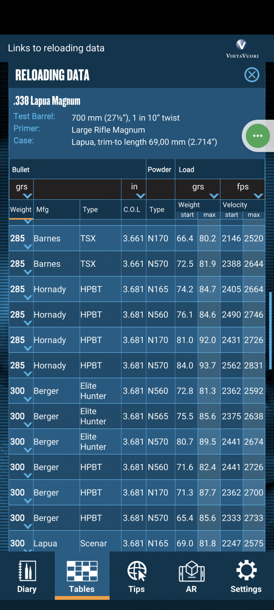

I use Gordon's Reloading Tool to help develop my loads. I believe it's free online. I doubt I'm qualified to provide a good or safe recommendation, but there are probably plenty of loads on this site that guys have worked up. If you accurately put your information in it does a good job of calculating all of those things for you. And you can sit and fine tune the different charge weights, change bullets, change powders, etc. I've been running a chronograph, and a strain gauge to measure chamber pressure, and found that the field results match up very closely to the calculations on the program. That's how I even figured out that the bulk density of the 568 didn't seem like it would work well in the first place to be honest. Also, you can go straight to Vhitavouri's website and they probably have the published load data already. Actually I'll try to attach a photo with this post. I'm running a 30" barrel as well. And the loading software above will let you put all of those specific parameters in.

The VV reloading data only shows one load with 300gr and 568, it is slow even when maxed.
