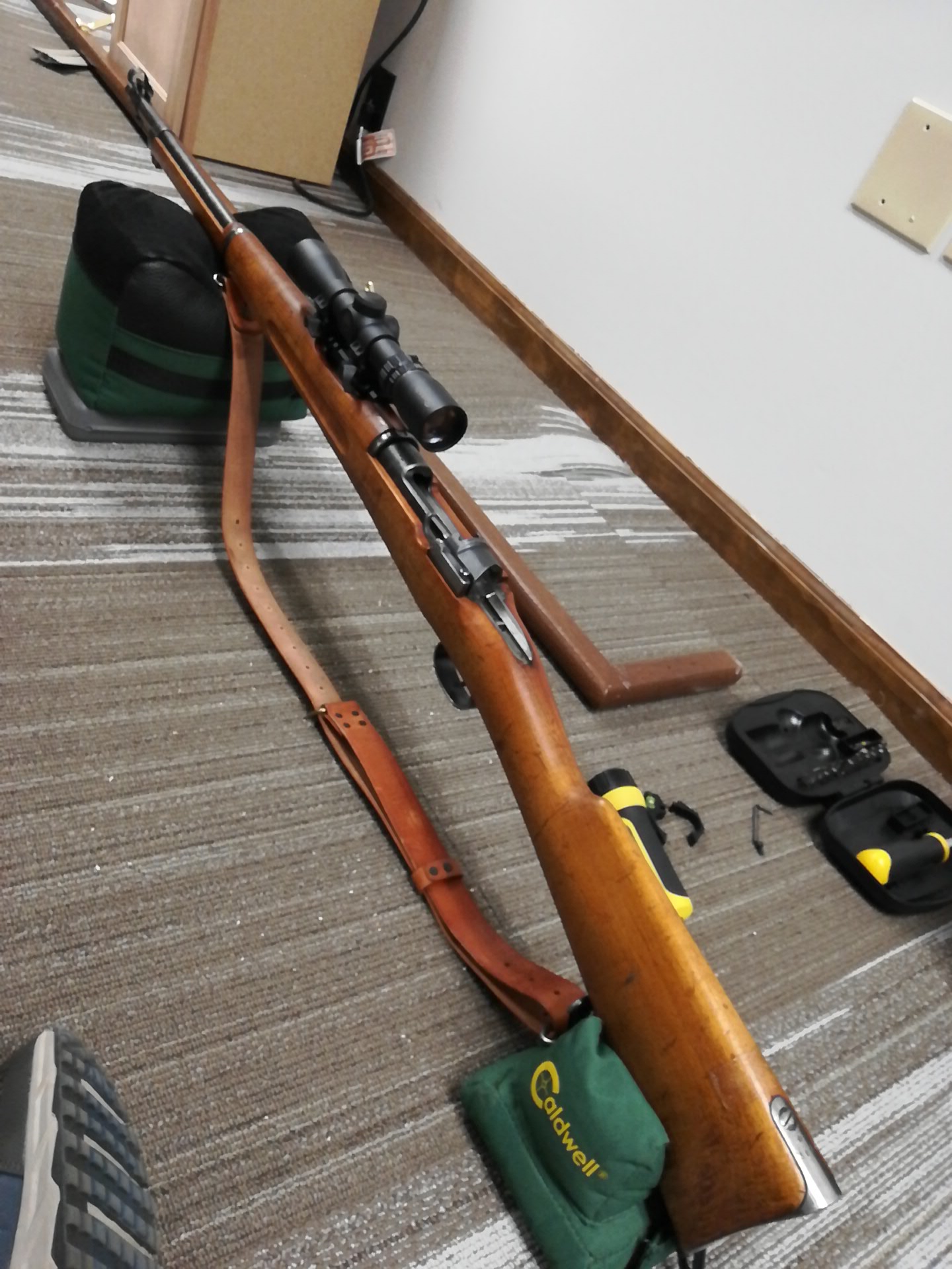

In bags like this are about as comfortable as I can get behind mine. It's still not ideal, but tons of fun to break out every now and again.
M1896, BadAce No-Drill Mount, Leupold QRW Rings, and a Burris 2-7 Scout scope.
