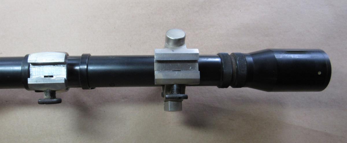

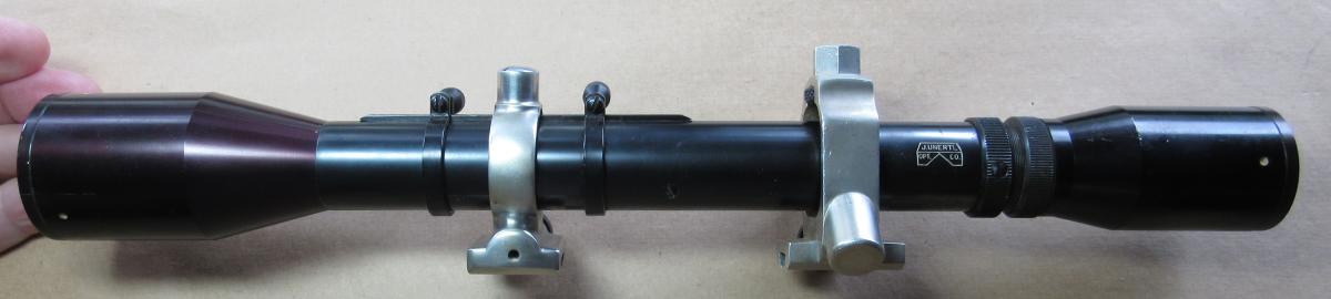

Anyone know the model of Unertl this is? Guy near me is selling it for $650 CAD ($475 USD) and I figure I might be good to put onto a JRA Springfield 1903A4 to get a little more magnification than the Hi-lux 2.5x that is on it now. Not sure what the mounts fit though....
This is a later scope. 1960’s to 70’s.
Has the field type adjustments. Name escapes me just now.
Should have very good glass. Designed to receiver mounted.
Not a traditional scope for a vintage sniper. Need to figure out how you are going to mount it. I have some bases that might work.
Nice scope, good price.

Thank you. The rifle is just a James River reproduction so nothing vintage. Was looking at one of the hi-lux USMC 8x scopes but they are hard to find in Canada and run about $1000 now if you can find one. Just want something that has more magnification and still has that period sort of look
I really wouldn't pick this up for a 1903A4 clone. The way it would mount would really cause you to have to drill the tap the barrel and modify a handguard to make it work. Then at that point it wouldn't be anything the Military did anyways.
Just to show you sort of the difference between the 2 mounting systems, here is a M1903 that is set up for a Unertl, and then the 03A4.
How much magnification are you looking for?

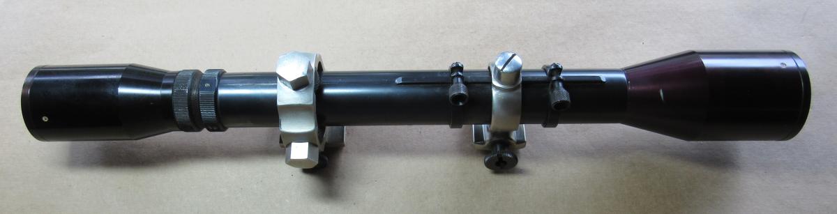

If I was looking for something to shoot on an A4 that would be a better scope, I would find a vintage scope something along these lines below. This is just a Weaver Scope. I think it's a Weaver K4 if my memory is right. They are really cheap, probably less than a $100 and the rings are not that much either.
This rifle is in the Marine Corps Museum Private Collection. They had about 6 or 7 of these A4 rifles, all with Weaver K4's.
This would be a lot less expensive than that Unertl, and would not require any modifications to your rifle. Plus with so many in the Marine Museum Collection they must have been using this style of setup for something.
It looks like a Vulture but I've never seen one in 6x or without an adjustable objective.
