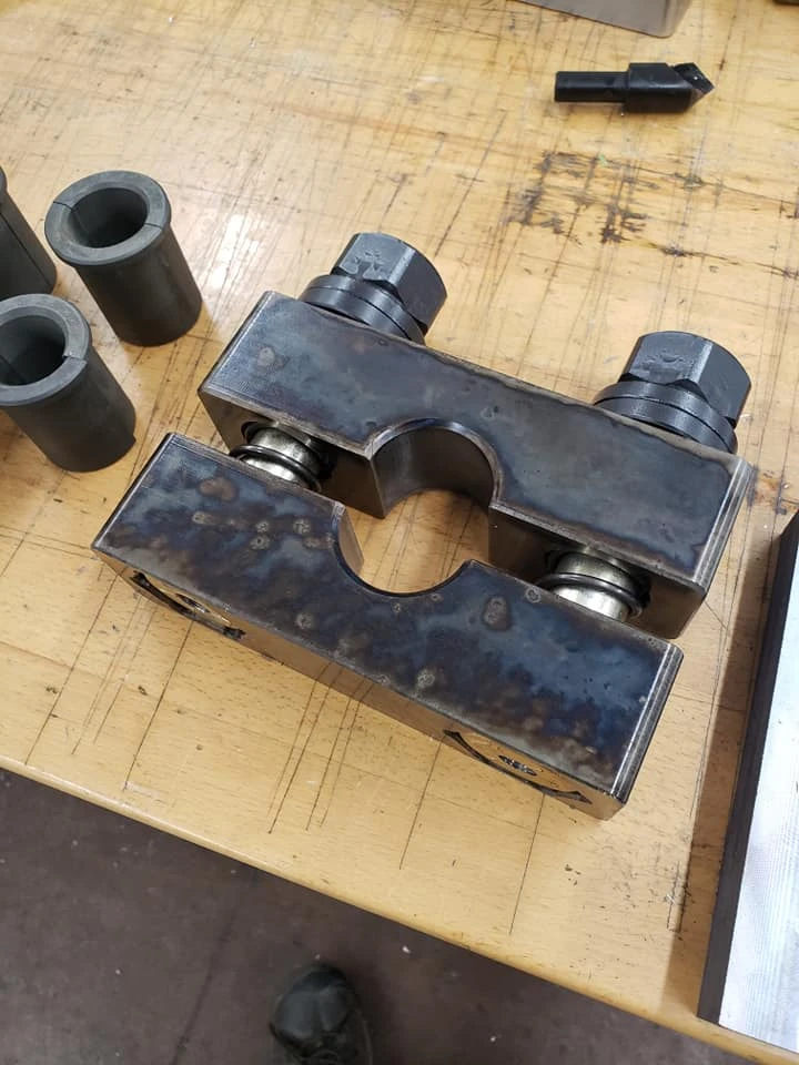

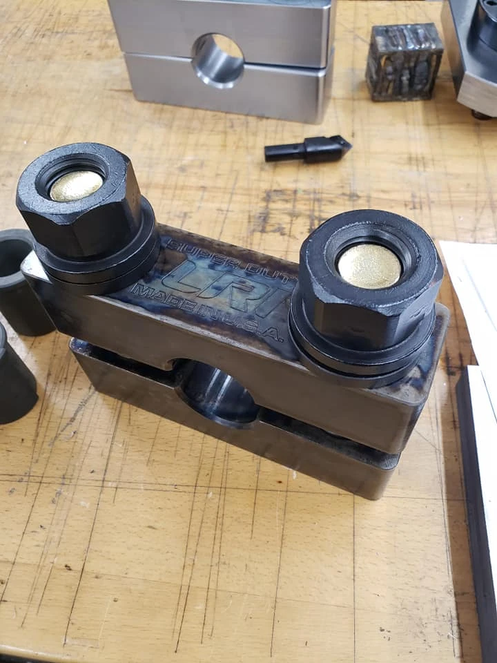

    The vice your great, great grandbrats will be using:
    I love this design. I am looking at making something similar. Would you be willing to sell the collets?
    I see brownells makes something similar, but no where near as robust and skookum as yours.
    The OD of my tikka A1 barrel is 1.125". Can't find a collet for that anywhere (unless its the same as the rem varm).

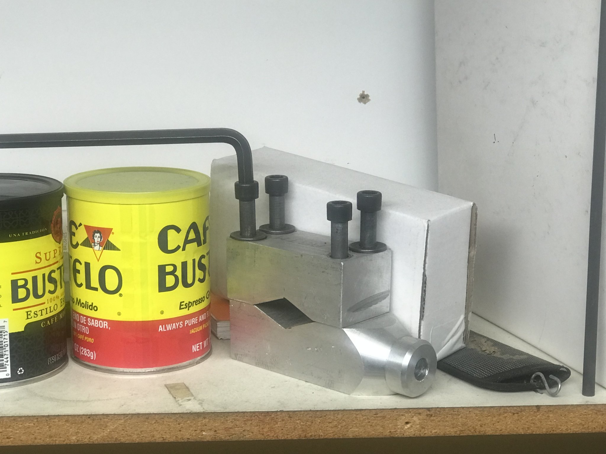

    Bought one of Marks at SAC, has worked very well. I bought quite a few of his inserts and also made my own for odd barrels (tikkas being one of them). Any good barrel vise with inserts is going to cost you $$ dont skimp and it will pay back when removing stubborn barrels.

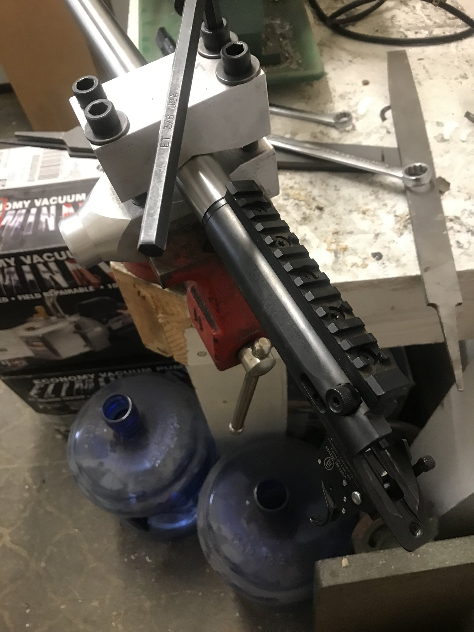

    What bushing did you use for the tikka barrel? I’m wanting to take off a ctr barrel.
    I made my own from an section of aluminum bar bored to barrel diameter at the shank. Easy enough to make, even with just a drill press. An alternative if you have a bushing that's too big, use a thick piece of lead solder to fill up space in an oversize bushing. The length of the bushing combined with the four bolts can create an enormous amount of pressure. Tikka's are known for how tight their factory barrels can be. Sometimes a sharp blow to a breaker bar works better than gradual application of breaker bar pressure. Regardless, pre-soak in Kroil - every little bit helps.

    threw my barrel in it with a bead blast finish and it left marks
    Not likely you're going to avoid the most minimal marring/cosmetic damage working with finished barrels- esp bead blast finishes because they're extremely shallow and delicate. I can put permanent "marks" on a bead blast finish with my fucking fingernail... not a fan.

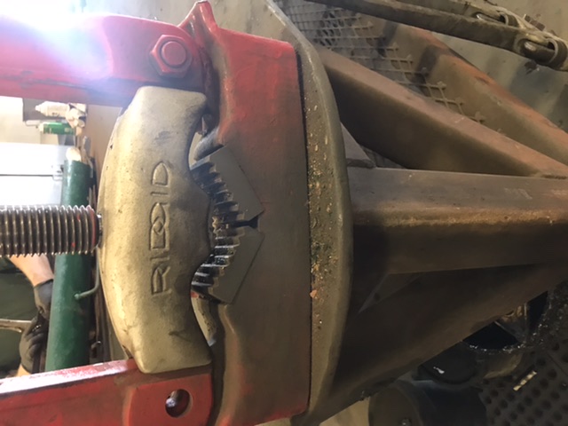

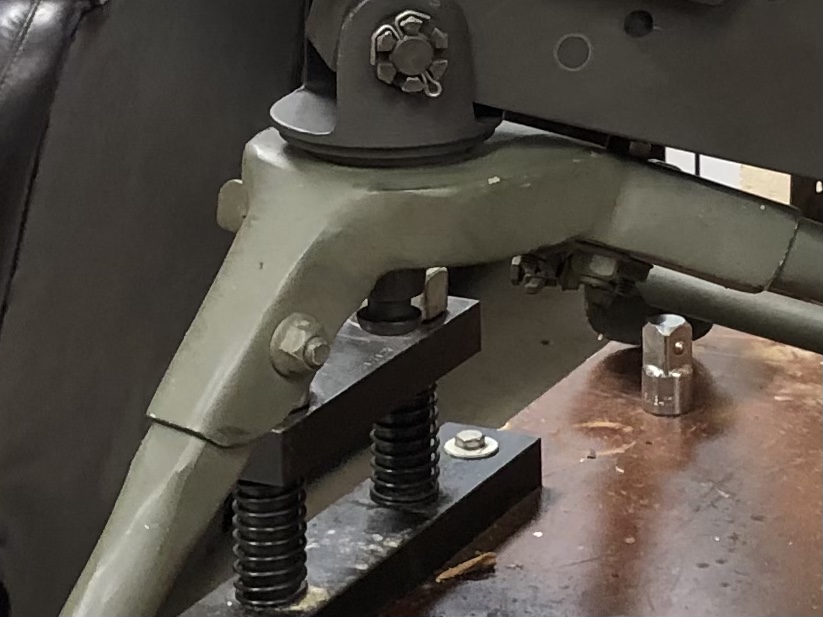

    Don't know if the Viper is up to the task with a Tikka, but...
    First one I tried couldn't get it to stop spinning, even with a tapered bushing turned on the lathe.
    Chad Dixon suggested a slurry of grit out of the sandblast cabinet (AlOx) mixed with some machine oil, it worked.
    Might be problematic though with a Viper vise, you have very limited contact with the vise jaws on the barrel compared to a tapered bushing.
    It's all about contact surface area.
