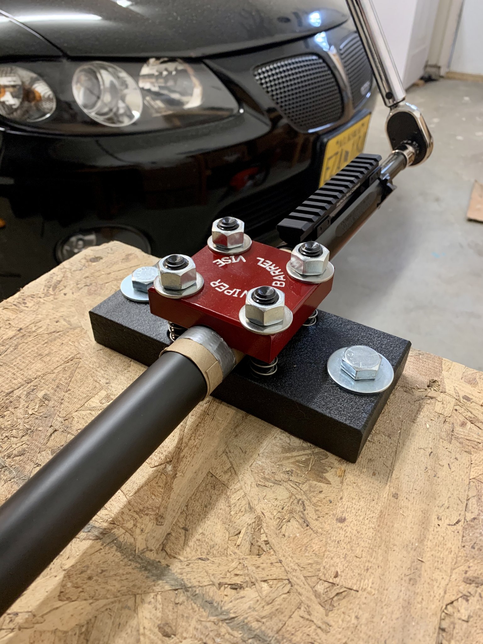

I have a 4 bolt Viper barrel vise. I have to remove and install bolt action barrels like prefits for Bighorn and others. My question is how tight do I tighten the barrel vise to the barrel? I know you don't want the barrel to spin because it'll marr the finish but is it possible to crush or make an impression on the barrel or cerakote?
I use scrap leather to wrap my barrels to keep them from getting marred and spinning. I've also read about guys here using paper towel or TP tunes. I imagine you'd only have to worry about crushing a barrel if using a CF wrapped barrel.
Call rob and ask. His number is in the video
he says wrap it in A TP tube but never mentions any torque values. I’d imagine it’s tight and then a little tighter. I just bought one but haven’t used it yet
TP tube. Snug on the vise bolts. Action to barrel torque’d to 100ft-lbs.
For better indication of slipping, I stuck a long extension style magnet on the muzzle brake flat and watched the magnet for rotation, never slipped.

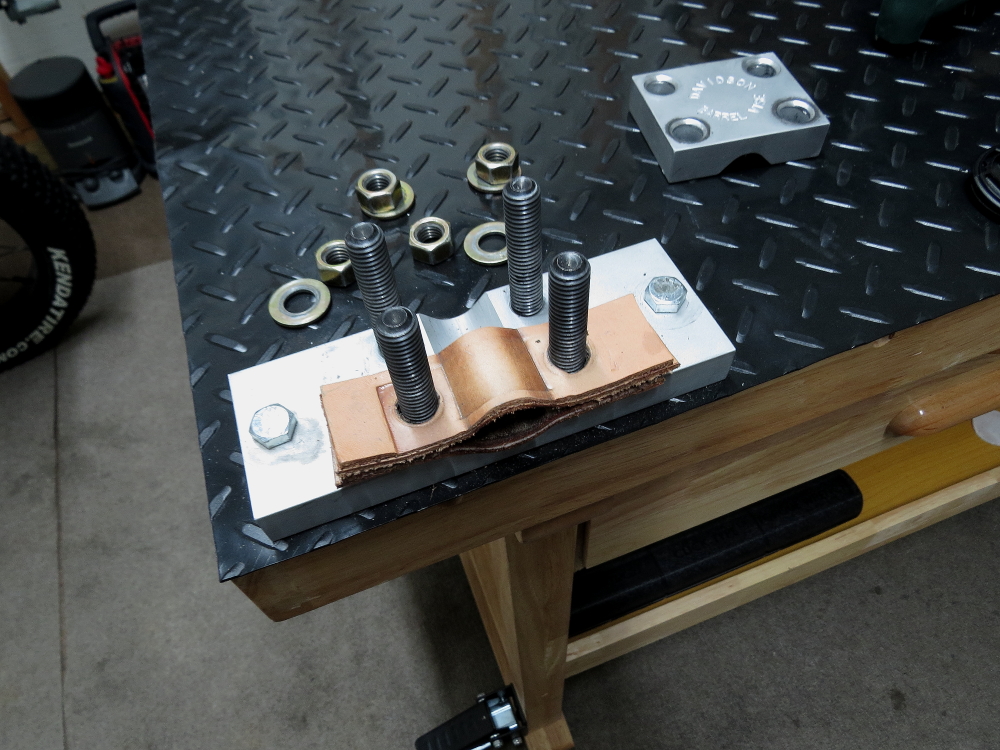

I wish I had ordered the extra .5" on the shank when I got my Carbon Six for this very reason, but so far I've made it work. I have a couple scraps of leather I cut holes in and placed on the bolts above and below the barrel. No slippage so far.
I just sandwiched two pieces of leather strap top and bottom and just use the front bolts on my CF barrel.
You're leather looks a lot better quality than mine. I might need to upgrade. I definitely torque the shank side down a lot more than the other side. Maybe I should try it without using the back bolts at all.
