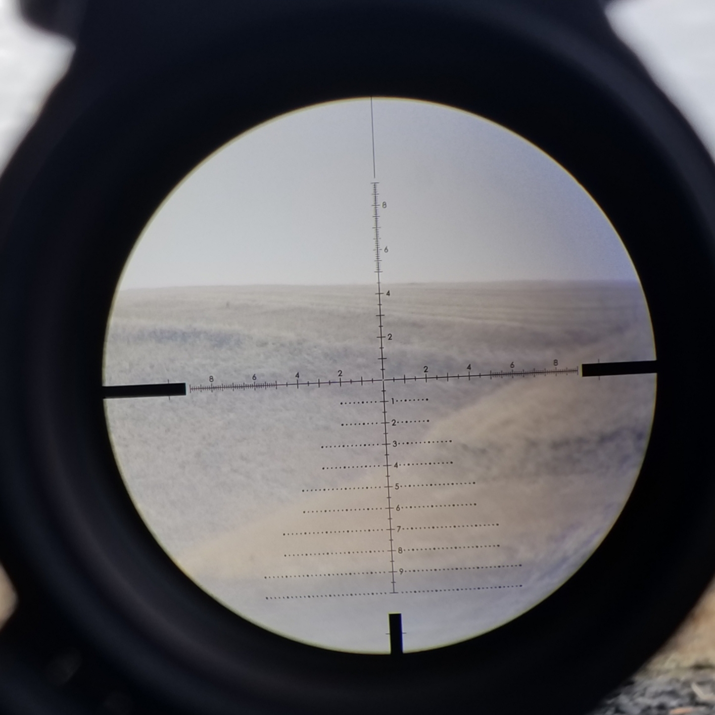

I have been narrowing in on the PST gen2 and I am pretty sure I want the higher magnification of the 5-25. I have several sfp scopes that are around 14-16x and I sometimes like to punch paper and am left wanting more. Yes, I know it is perfectly doable at 15x, but you don't see benchrest guys using anything that low for a reason. I shot with a couple of guys and they advised me that 15x is a bit of a challenge to see the 1200yd targets at the local PRS style match. My question is if I run the 5-25 scope at 15x can I even see the tree part of the reticle? I tried to watch some youtube videos and it looked doable, but that was screen sized and sitting still. Same question applies to the Athlon reticles as, they are also on the list.

In fact, most "trees" are somewhat optimized for 15x. At 25x you lose a ton of the reticle as it's outside the field of view (You won't be able to hold for 1000-1200 yards most likely at 25x), and if you try to use the tree at the fringe of the glass, you can run into optical distortions or aberrations, especially on the lower end scopes.
I almost never run any optic over 18x during a match. No problem this far out to 1100.
Also, benchrest and PRS are going to be vastly different in the application of an optic.

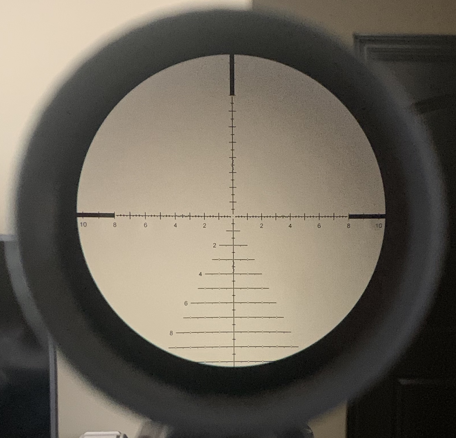

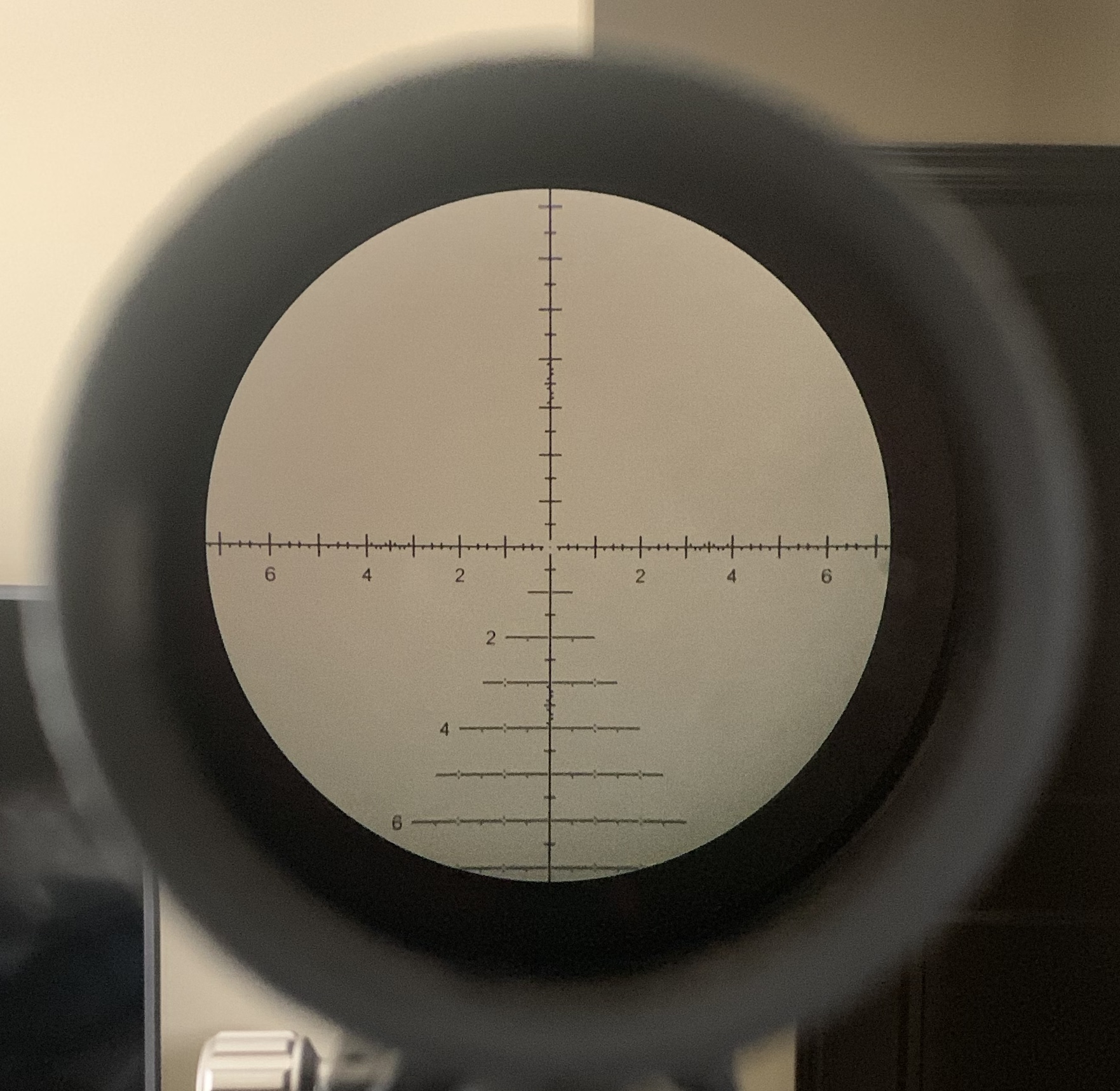

For reference, here is skmr3 reticle in a 525 at 18x and 25x

Thanks for the feedback. While I will try out F-class and probably use whatever scope I buy, I understand that it isn't well suited for the task. It that game sticks I'll get a proper high mag sfp optic. Those reticle pics are perfect. Thanks for taking the time to share them. I continue on my quest to find a 20x and up scope. Lots of tempting deals on 15x stuff, though.
