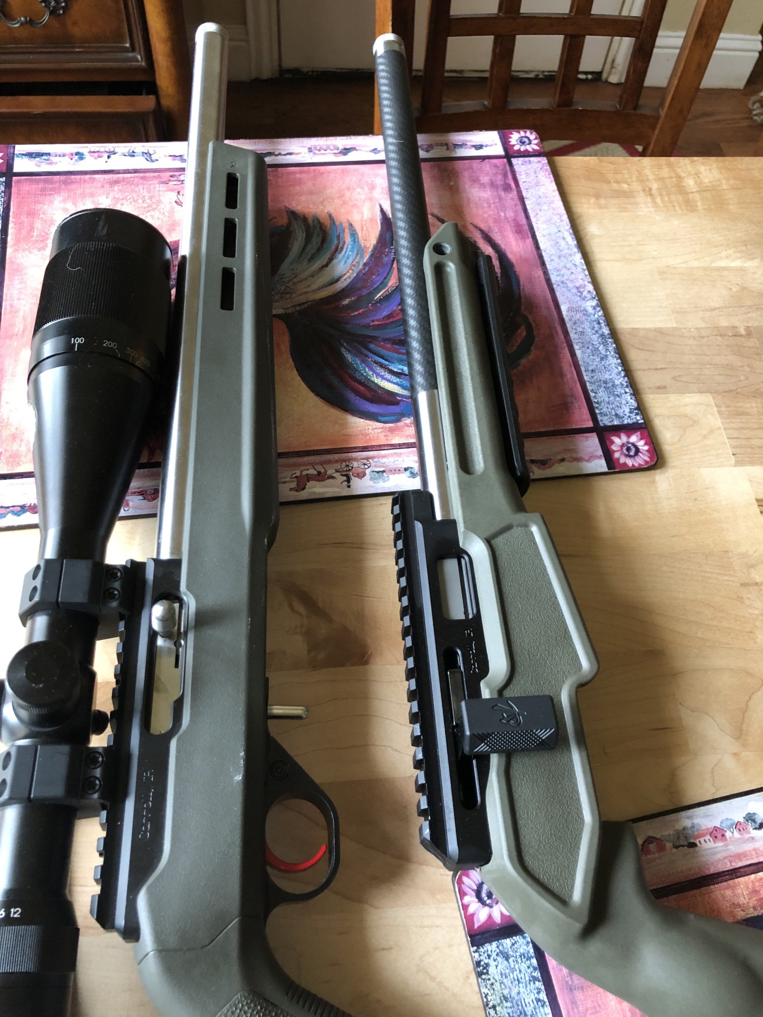

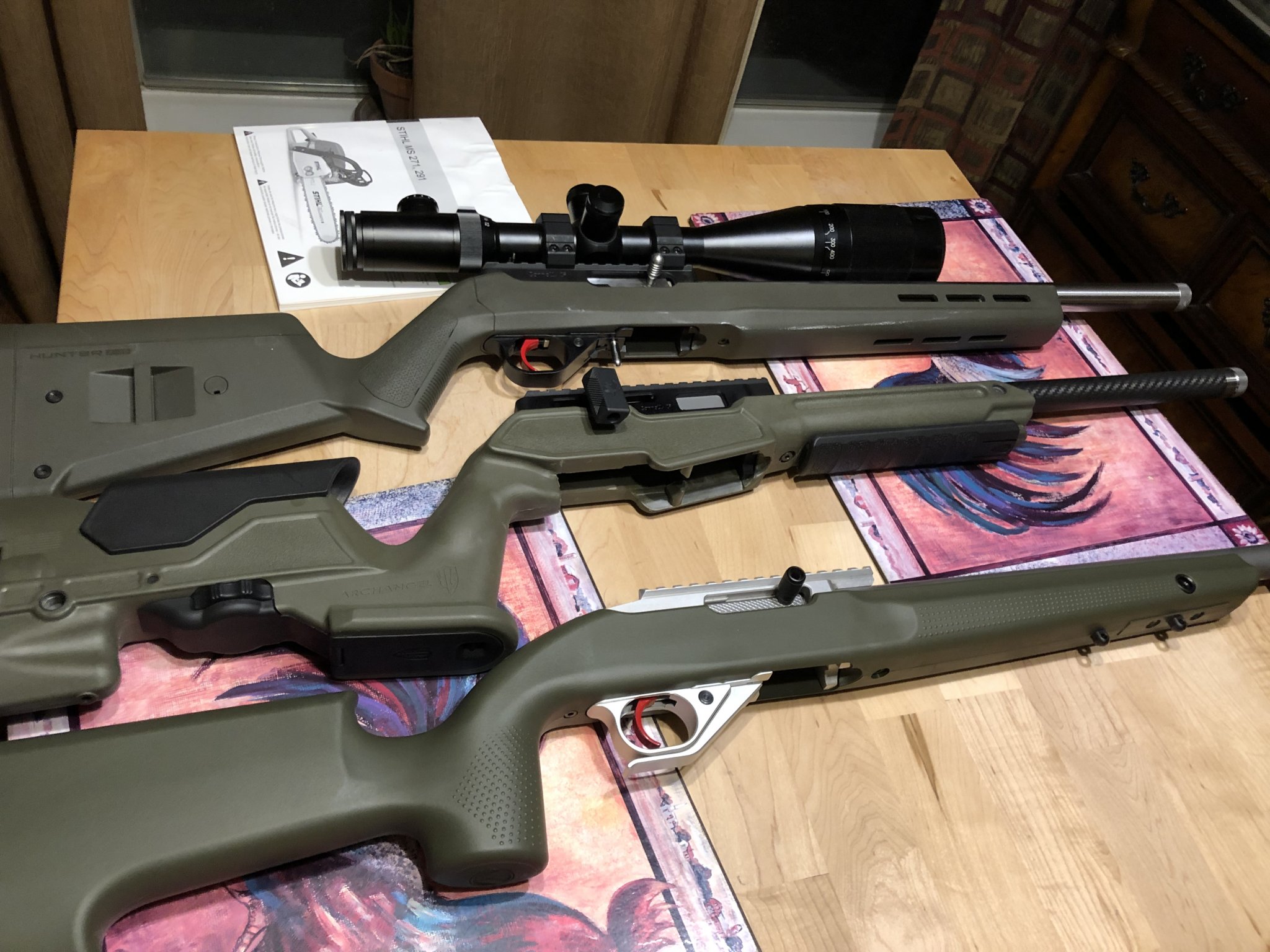

    I built a Kidd about five years ago to shoot with my dad before he died. He went downhill pretty quick so I never did get to really put it through the paces.
    The VQ 10/22 on the left is built out of the pieces remaining from his 10/22 that I got him for 60th birthday. He had replaced virtually everything with VQ parts except the shitty Ruger receiver so I just finished it off and put all of his stuff into a stainless VQ receiver and in a Magpul stock.
    I mostly built the Kidd with hopes of it competing with his rifle so I could give him some shit about his rifle wouldn’t shoot. It’s not technically a Supergrade but I think is almost the same except it doesn’t have the threaded barrel.
    The Summit is an experiment to night hunt suppressed for piglets as I have deep desire to get a couple and roast them in the ground.
    Here’s a picture of the Kidd with the VQ and Summit. I’ll do a range report with a bunch of medium grade ammo and as much high end stuff as I can stomach and do a full write up.

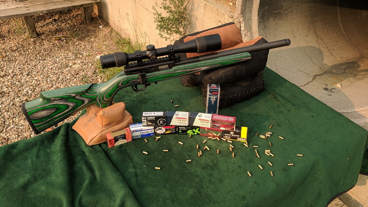

    Put 257 rounds through it with the 1st 157 being leftover various rounds from many years that had accumulated in the bottom of the range bag. Really it was a real mixture of HV, SV, thunderturds, Federal, Winchester, Eley, Sk, CCI, Aguila and what not. I was just trying to establish functional reliability of the action. The good news is the volquartsen parts and additional barrel shimming took it from about 40% reliability to 100% for feeding, ignition and extraction. I did suffer about 22 "harder than normal to feed/close bolt" with the off brands, noticeably the federal and remington crap.
    I then switched over to 100 rounds of SK+ and ALL feeding issues went away and surprise surprise, accuracy was a lot better too. The lube SK uses really made a difference for this action. Rifle is just as quiet as a bolt action with the suppressor, this is what I wanted from the beginning.
    Targets 1-5 and above sighters were scope zero and functional testing, did notice that any HV rounds pulled high left of POA. Yardage 25 from the bench with bag, winds variable 0-8 MPH out of 7-8 oclock. Targets 11-15 were all SK+ ammo. Ignore Target 18 as it was standing offhand unsupported, just wanted to see how the rifle balanced in offhand shooting.
