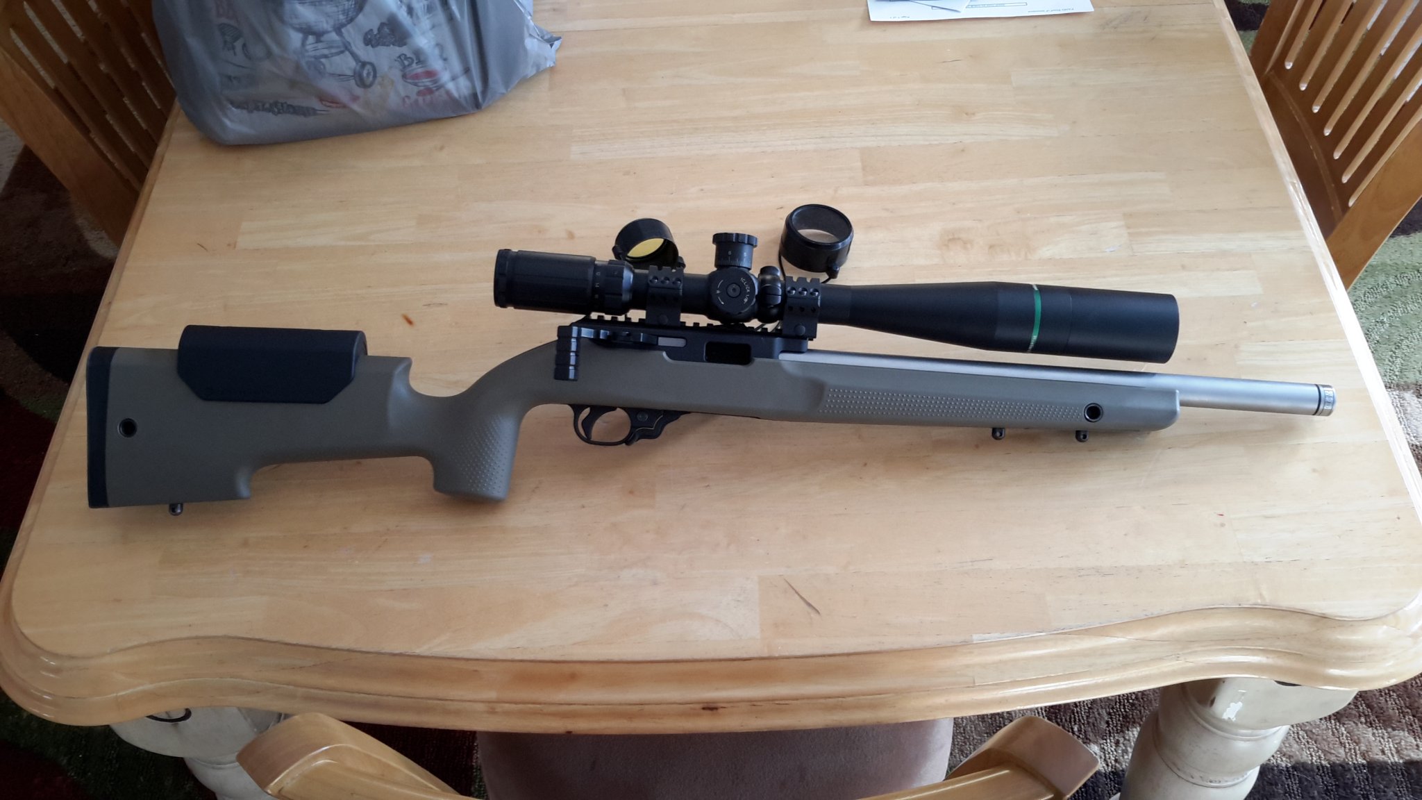

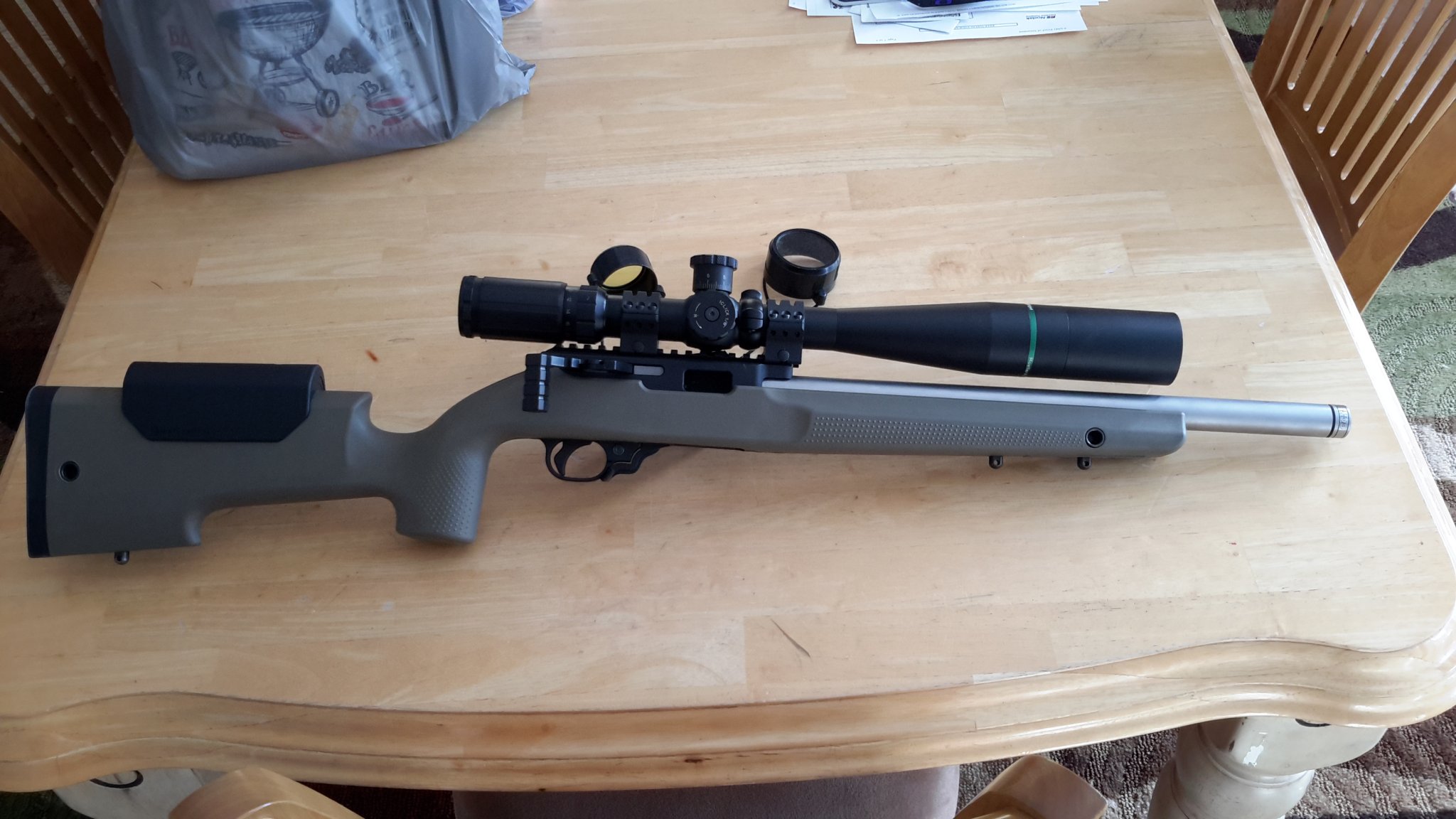

Just want to share mine, "DARE TO BE DIFFERENT". This is a RECEIVER AND BARREL THREADED TOGETHER BY PASS THE V BLOCK.This is not CPC work he work only & only 10/22 semi.I also have 1 from him on my 10/22 semi.
Back to the SUMMIT barrel is CUSTOM PACNOR BARREL 16T 3G SUPERMATCH GRADE HIGHEST GRADE FROM PACNOR and PACNOR SUPERMATCH 22LR CHAMBER also custom length,this is not pacnor PREFIT barrel they also have prefit.
***SHOOT OUT TO JAY OF PACNOR VERY NICE GUY AND STRAIGHT TO THE POINT*** am lucky i get some barrels from them before something happen to their facility. still in break in process i shoot cci standard most of the time and it shoot extremely good,AM ONLY POOR BELOW AVERAGE SHOOTER,but damn so so accurate.
