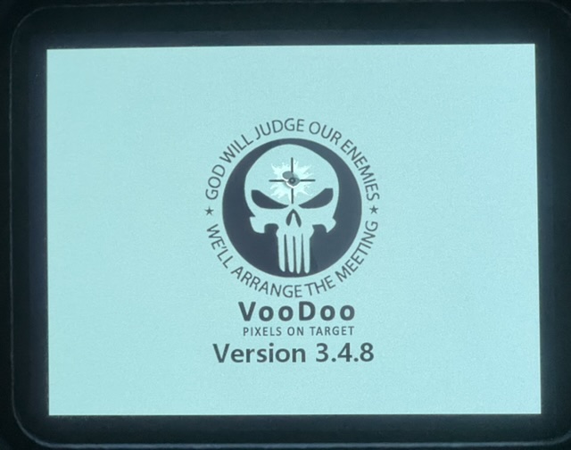

Right off the bat, Voodoo crushes the “Who has the better boot screen?” Competition.

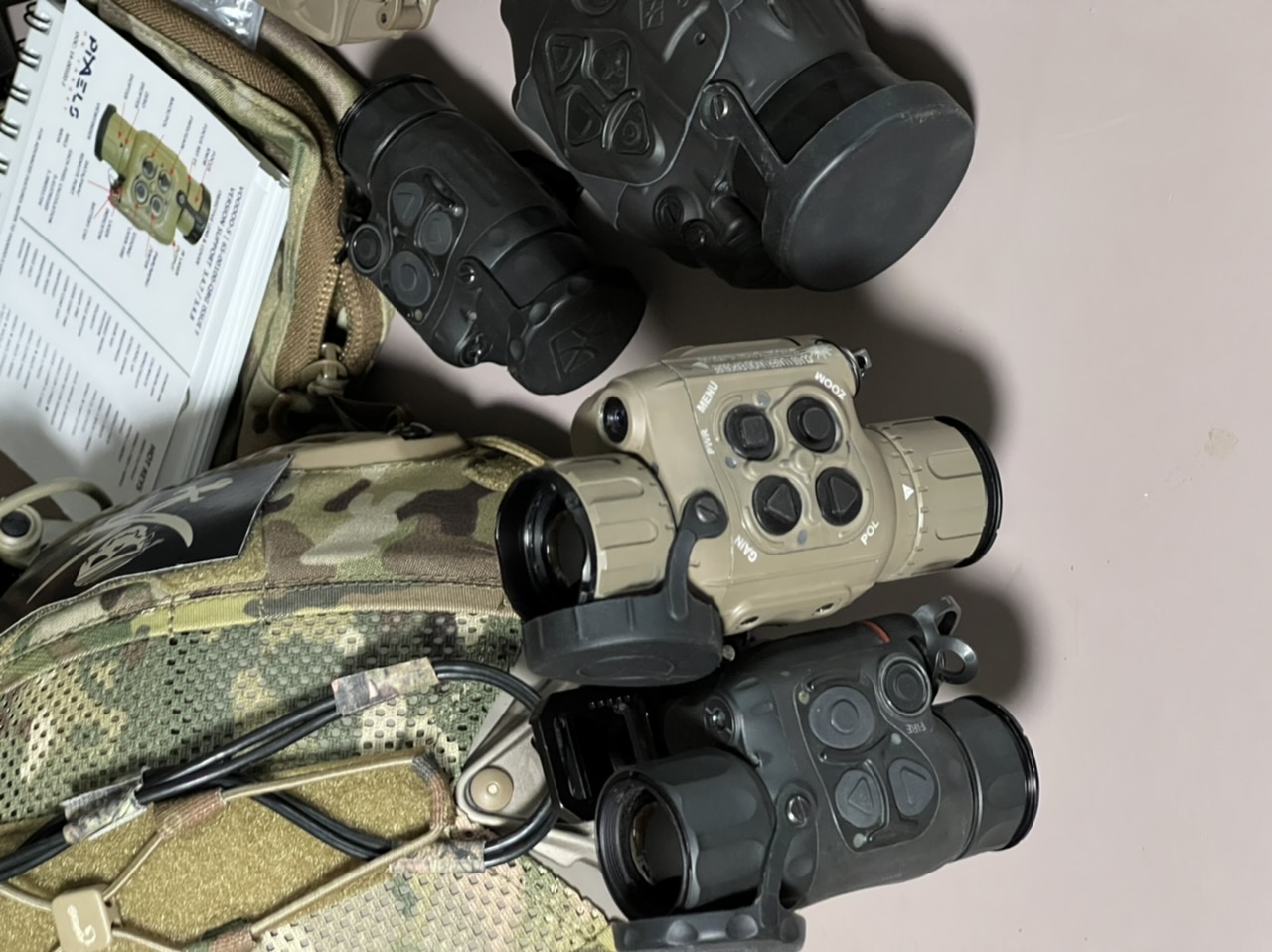

So far, the two best points of refence seem to be the UTC Xii and Yoter C. One is the gold standard and one is the budget option that everyone wants to be a communist piece of junk
ETA: there's a ton of new stuff coming out but the above is probably in enough people's hands that it helps give a good idea of actual performance

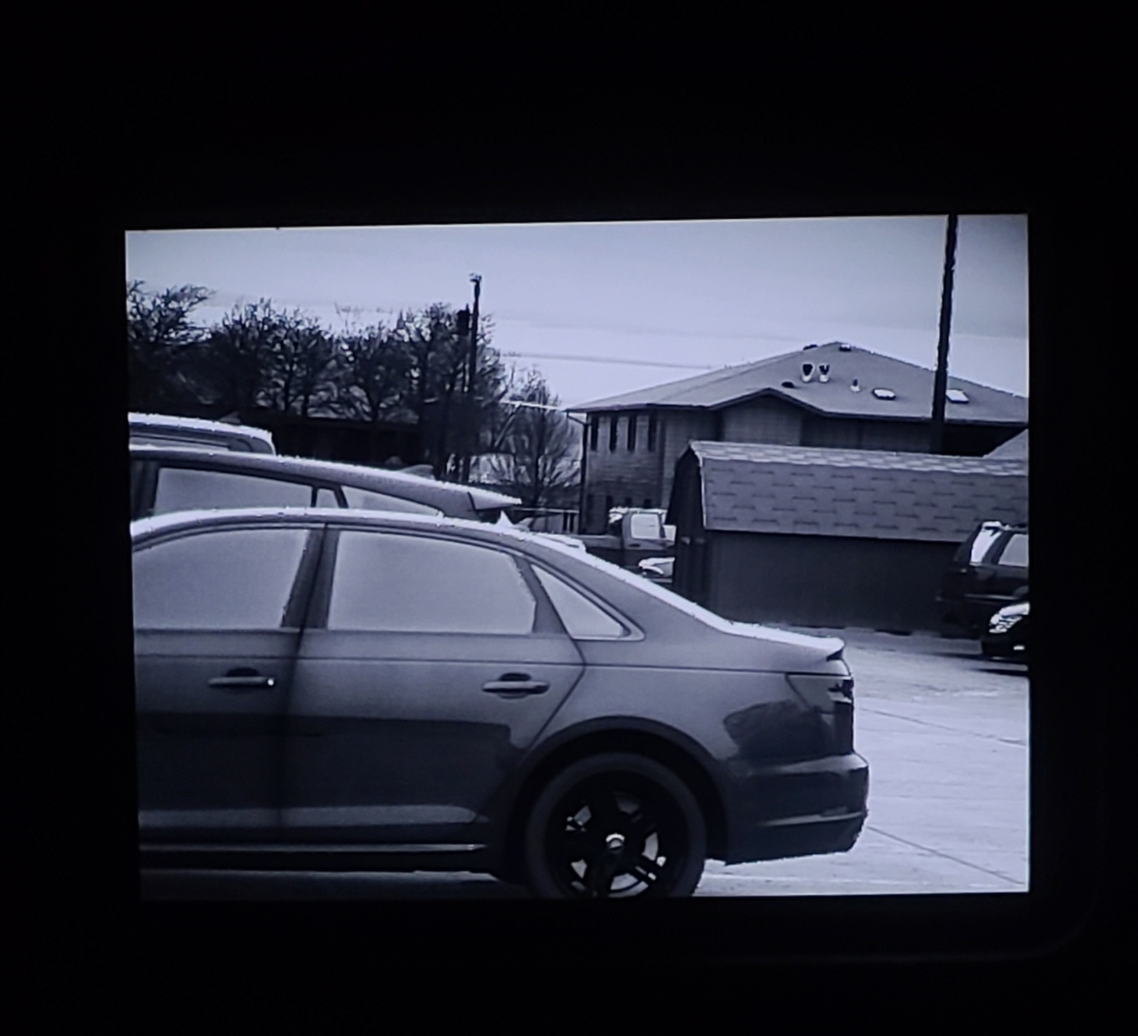

This image looks better, which is nice, but if nothing is fundamentally changed from those previous designs, this would make a fairly marginal clip on as well.
So my question, for anyone who has one of the Voodoos… is something fundamentally changed that addresses this issue well?

Small up date here, compiling images at the same distance with all optics using the same day glass and will post soon! Have that pulsar Krypton coming in early this week coming and will put that up too.
In the mean time, here's a picture through the voodoo S.
