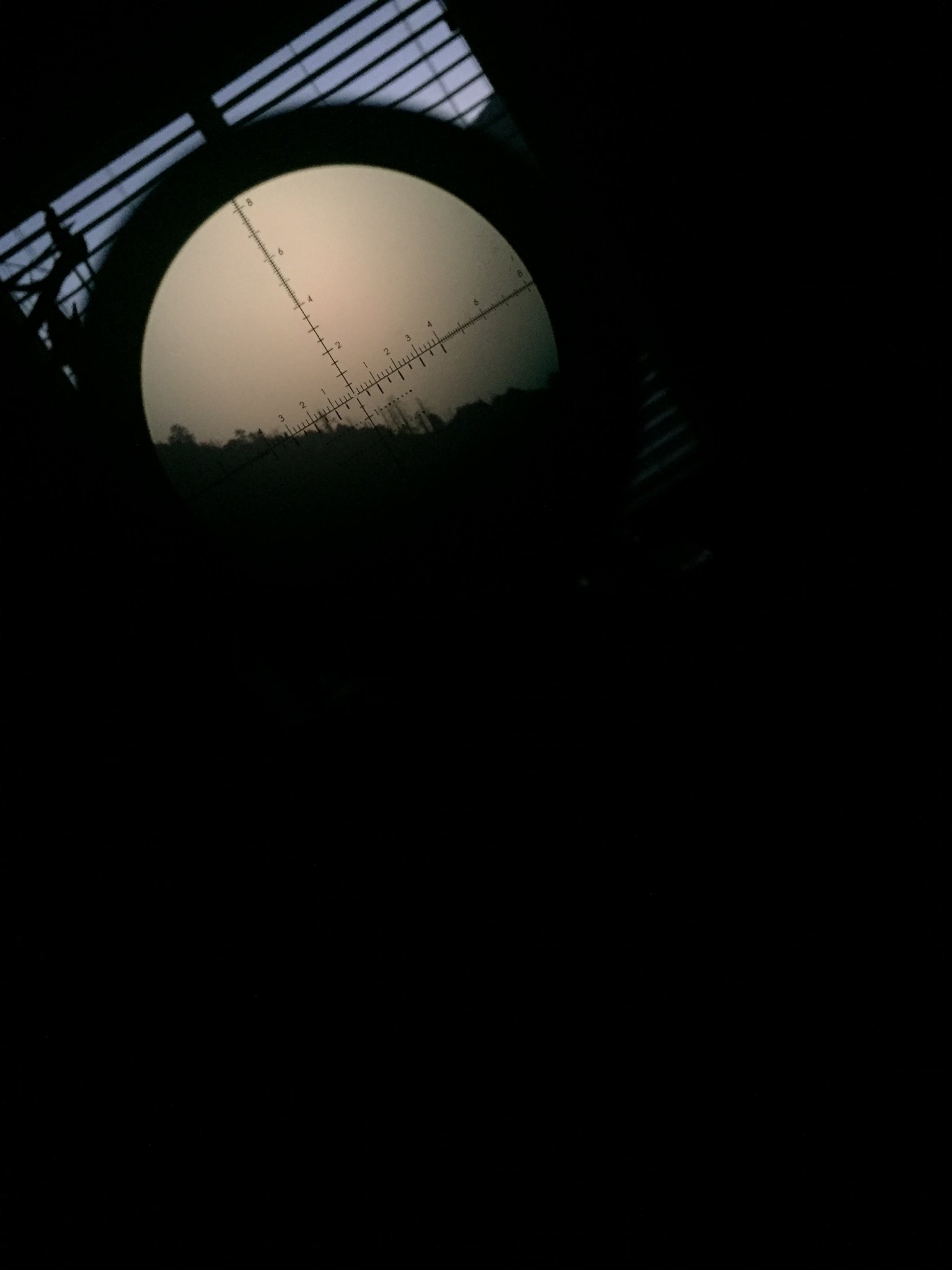

Buy with confidence, I have one thats been used for the past year for CMP 1k yard matches and its been excellent in regards to tracking and optical performance.
Optics are good my crap pic doesn’t do it justice sunset 20 min ago and I can still count the branches on this tree about 6 miles away

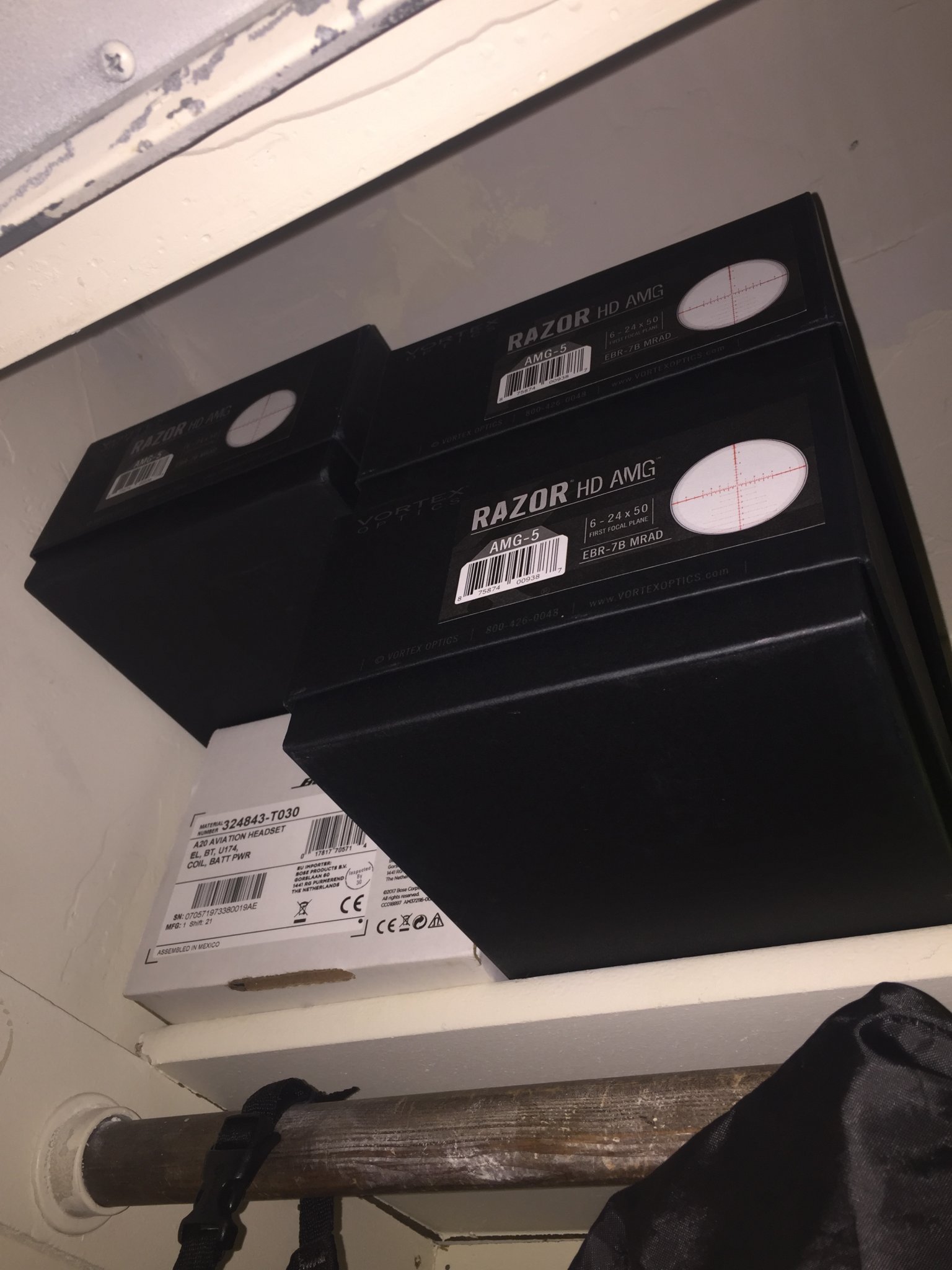

I’ve had multiple issues with parallax mainly not being able to get rid of it at 1000+ yards. I’ve had 4 warranty scopes between new ones and repaired ones, the current one I have is going back now too.

Curious what serial numbers are you in? I had a 2000 series that broke they sent me 2x 8,000 series and now I’m at a 5,000 series replacement, made me scratch my head.
First one with the erector issue was a 5000 series. It didn't have the parallax error until they "fixed" it. I don't know what the one with the click was. I never even mounted it. Just sent it back. The current one is a 7000 series. I checked the parallax yesterday on some trees and a building that were over a mile, after this thread reminding me. The glass in this scope is GOOD. I just hope everything continues to hold up and I don't have mechanical issues.
