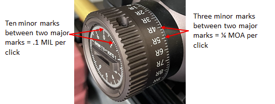

Back to the main topic, does OP still actually think there's 5 lines per number on the main windage knob? 🤔
No they are not geez....buy some reading glasses...
Look again. Or maybe you need glasses. The turrets are marked in MOA. The only part not is the windage micro adjustment from what I can see. Better pictures would help. Did you even use it? A simple box test would have told what you need to know. You might want to review some of your post, you come off as a whinny bitch that does not know very much about this sport.

Alright, smart ass.....on BOTH the outer elevation and windage turret, there are three incremental marks in-between the major printed number marks....for 1/4 MOA.
The inner turret on the windage is mil with .1 MIL per click with 9 minor intermediate marks between major printed number marks. Yes, there is a half MIL slightly larger line half way between major printed number marks. That's at .5 MIL
The elevation fine turret; you posted the same pic twice, and neither shows the elevation fine turret well enough for me to be sure, but it appears that there are three minor marks between printed number major marks for 1/4 MOA per minor mark.
As far as I can tell, the only issue with your scope is that the inner windage turret is marked in MIL and it should be marked in MOA.
But, maybe those new glasses will show me WTF you are seeing five marks between printed numbers. Or maybe you will learn how to fucking read MOA and MIL turrets.
