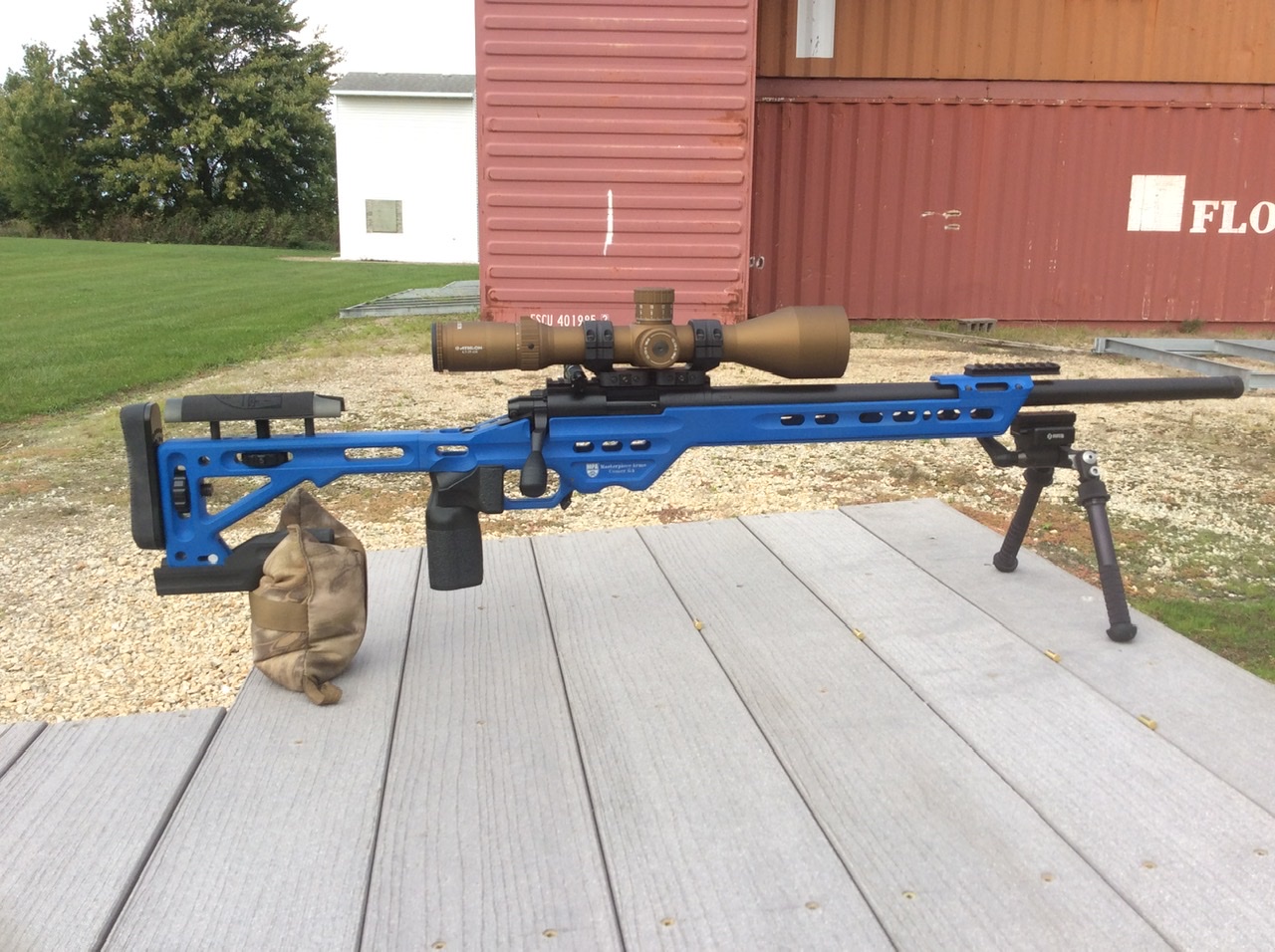

I have a Masterpiece Arms MPA BA 6.5 CM being built and have been researching the mount and scope. This rifle will be a for range use / distance competition / maybe a little stationary hunting but it weighs a lot and I have other stuff for hunting. I want to get out to 1200 yards with this.
Budget for scope and rings is around $2500. Must be FFP and mil / mil as that is what I am used to.
I am leaning towards Vortex Razor Gen II MRAD 4.5 - 27 x 56 with the EBR- 7 C Reticle.
Leaning towards the Spuhr ISMS 1 piece 34 mm mount.
Is the Spuhr 1 piece mount worth the increased price over Seekins rings? The MPA rifle will have 20 MOA on the rail. Should I get the Spuhr mount with 20 MOA or 44 MOA? So 40 MOA or 64 MOA total?
Any changes to the scope and mount recommended? Thanks!

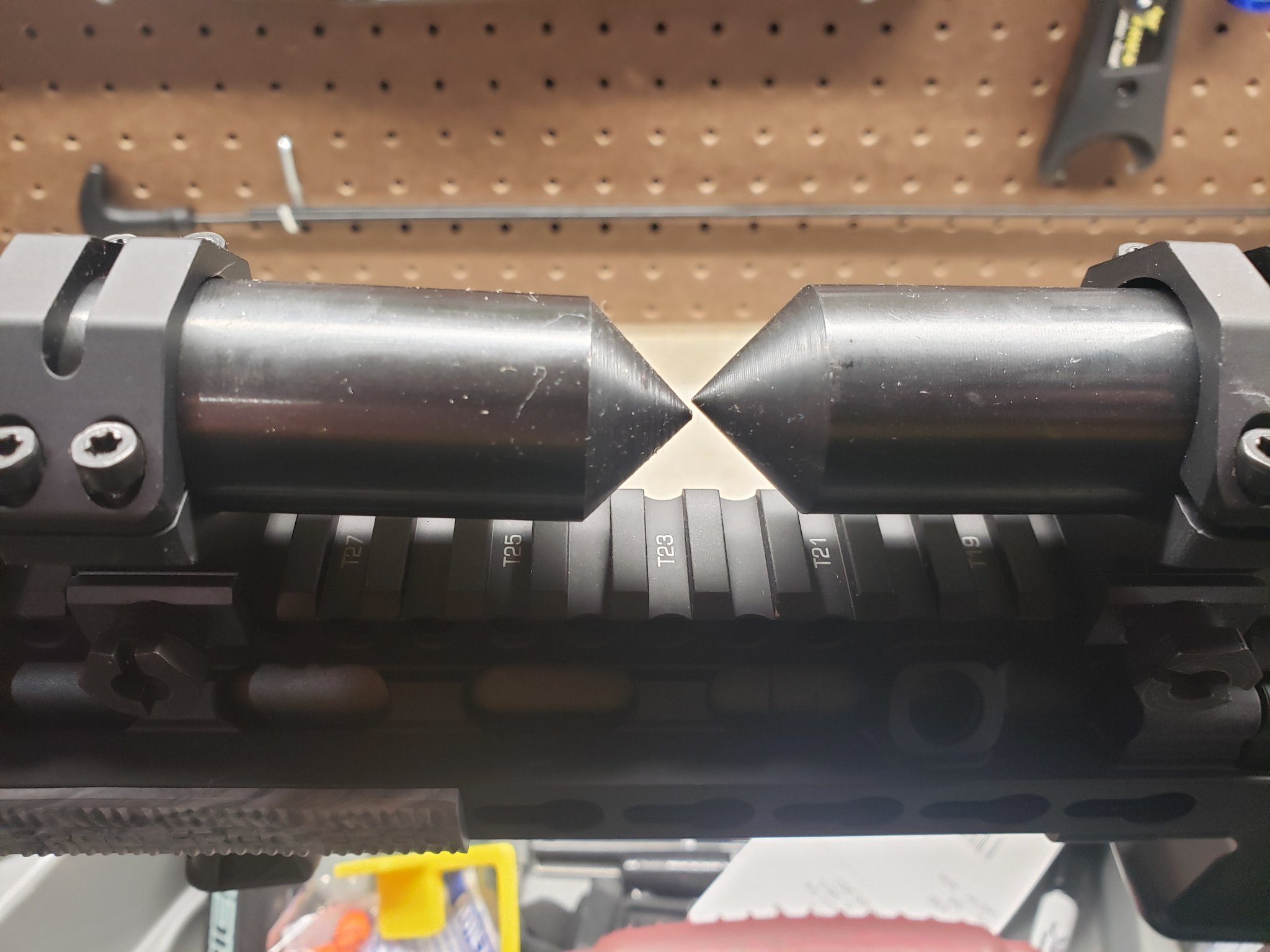

How does a unimount fix rail tolerance issues with one side higher vs the other on the picatinny?
A unimount doesn't fix tolerances from the picatinny rail. It just helps prevent "spreading" the differences or tolerance variances into your scope. We call it tolerance stackup. For example a picatinny's flatness tolerance is .005" so that means 1 out of your 2 rings could sit .005" higher or lower than the other. This .005" doesn't account for the ring's machining tolerances either. Since an optic is a precision instrument I don't want to spread the tolerance variance into the optic's tube.
If separate rings are a must I always recommend lapping or at the minimum check concentricity.
Picture below is an exaggerated scenario. Pretend my 2 piece rings are identical but my picatinny rail's tolerances are on the opposite ends of their tolerance range (mil-std-1913).
To add to this discussion depending on scope height a unimount is not possible. I think Badger Ordnance sells the lowest unimounts available. I purchased Seekins PMR low rings and had to lap them.
