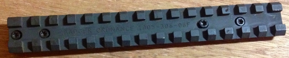

EDIT: Please verify - My rail has 306-06 stamped on it. I'm assuming that Badger stamps their zero cant rail as 306-06F and doesn't stamp all their rails with the same model number?
EDIT2: Finally found a picture of a zero cant rail.
