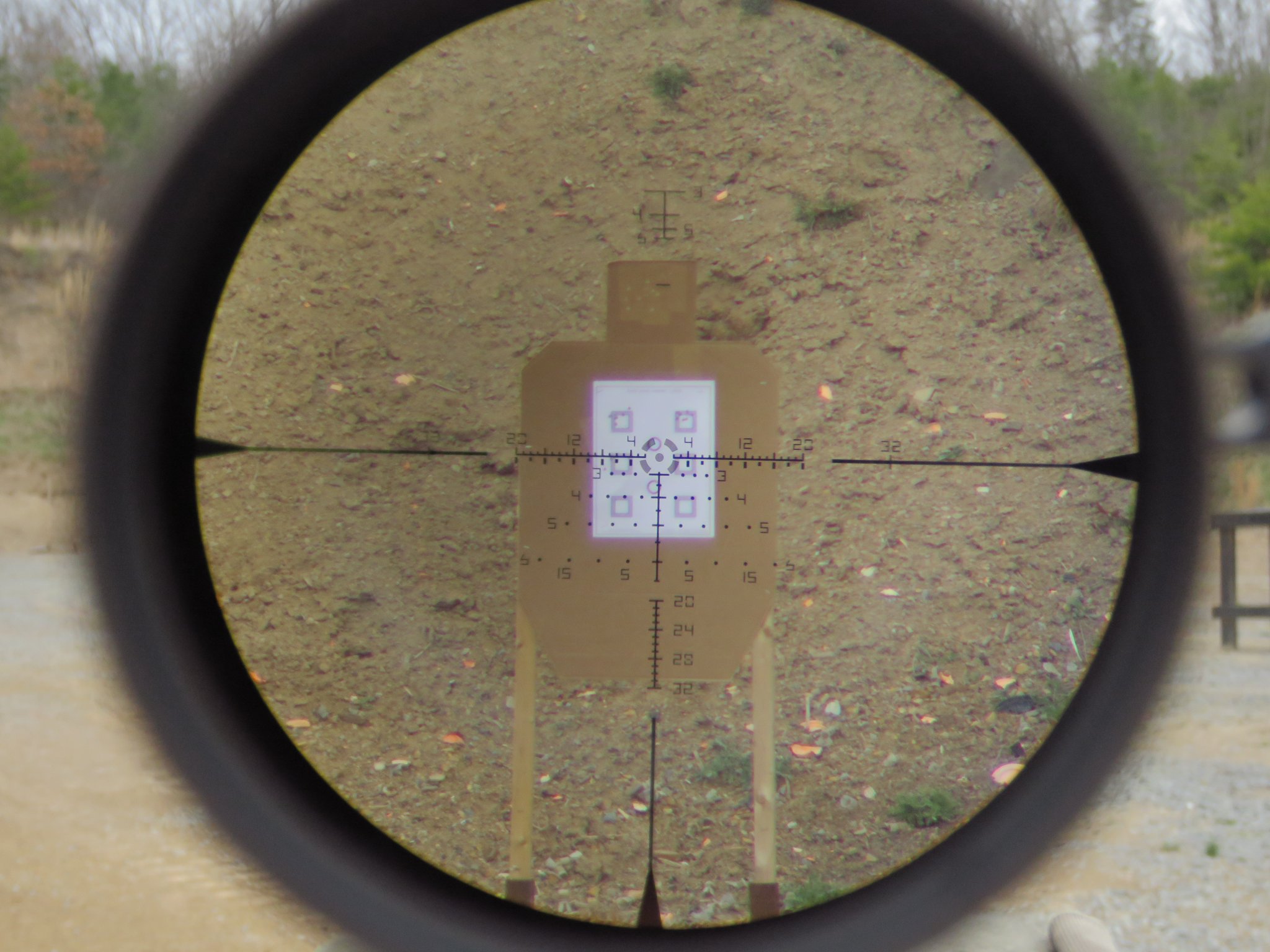

I'm extremely excited to see the reticle on this. Anybody know if they got one in the showroom yet?
This would make a great scope for a DMR type build and if the reticle is crazy think it should be good out to 800 yds on decent size targets.
The center would be SOO much more useful if they used a chevron instead of a dot. I wish someone made a reticle like Primary Arms, but with mil subtensions not BDC.

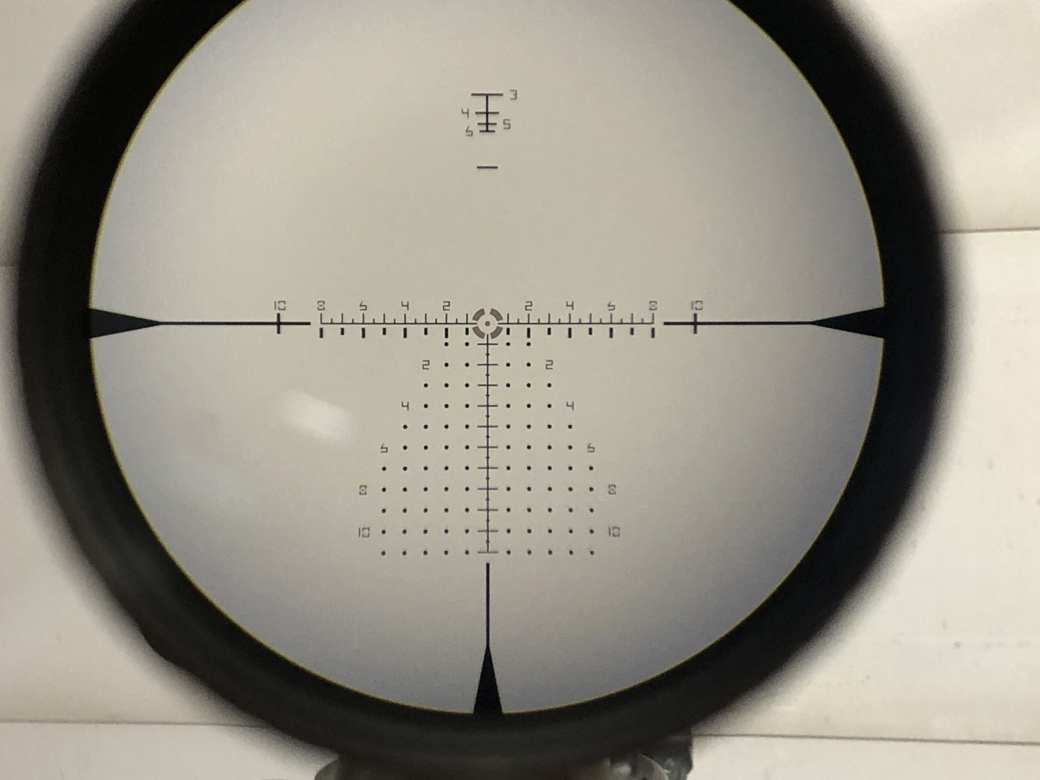

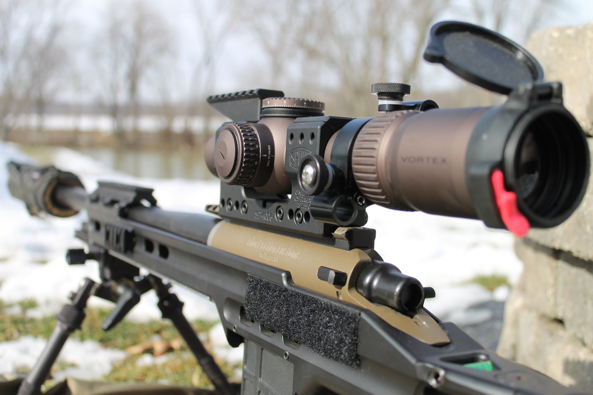

Anyone have thoughts on the mount they are planning on using with their 1-10x?
I'm planning on getting the Scalarworks Leap over the Geissele mount as it's lighter, auto leveling and completely snag free.
I do like the color and the return to zero may be more precise on the Geissele, as it was tested with a laser further than the Scalarworks.
Reactions: IanHusaberg
I mounted mine into a 34mm Aadmount.
Both Scalarworks and Geissele seem to be made to the mil-std-1913 spec (where the mount squeezes the rail from the sides with four datum surfaces), rather than NATO (three datum surfaces where the mount is pulled down onto the top of the rail when you tighten the screws). In principle, both work just fine if everythign is in spec, but I had better luck overall with the Stanag standard that defines the datum surfaces in a smarter way.
Here is a good description of the difference: https://www.thomasmechanicaldesign.com/the-mitch-blog/picatinny-and-nato-rails-gdt
I have seen Scalar Works mounts, but I have not had a chance to test one. They look pretty and have a bunch of clever features, but they still seem to adhere to 1913 framework
I have a 30mm Geissele mount here and, honestly, I like it quite a bit. I have the new Delta Stryker 1-6x24 in it and the combination works very nicely and comes back to zero pretty well.
Aadmount is still a little slicker and given that I am not planning to be removing it any time soon or with any regualrity, I like the flush T25 screws. If I do need to remove it, it comes back to zero exceptionally well.

anyone planning on putting their R3 on a bolt gun or something other than an AR? I'm really curious what Vortex is going to bring out this year - the R2 offerings, while still very viable are showing their age imo. something to compete with the NF 7-35 would be great.
Pretty nice package all-in-all. They really did get alot packed into that package all while keeping the weight relatively low. The 1x is pretty good, albeit not quite as good as the 1-6. The 10 power is good, but the eye box is pretty small, but that should be expected. We're currently taking preorders as well and I anticipate these things to be pretty hot for awhile. I still need a little more time behind it, but first impressions are good.
I just completed a short write up for a publication but I'm hoping to do a more in depth review for another soon. That being said here are a couple thoughts of mine on this scope.
1. It's pretty awesome for a recce, SPR, or DMR type of rifle.
2. The one that I have is the MOA version with the BDC reticle but I actually dig it. If I tune the zero at 50 yards to equal a true zero between 200-225 depending on the cartridge I can get the hold overs to line up pretty good, generally within 1/2 MOA or better. So far I've run the numbers and so far I can make this reticle work with 77gr OTM, 75 BTHP, 55gr FMJ, etc...most common 5.56 basically. This is the magnification on 10X.
3. The segmented reticle and center dot are actually pretty cool because they're partially see through so it won't obscure the target behind if you need more precision. That being said the dot is only 1 MOA but it's still cool nonetheless.
4. Down on 1X I'm as quick with it as I am with a red dot. FOV is good, I don't have any experience with the 1-6 so I can't compare it honestly. I don't think it will hold you back though. This picture is on 1X with the illumination on 6 or 7, can't remember, the target is about 5-7 yards away.
5. Illumination...so none of the settings are really NV or low light settings. Setting 1 is almost too bright at night until I started to think about this in the context of being used on a HD rifle or possibly a duty gun where it's likely you'll have a white light. If you're on setting 1 and you hit something with a white light there's a low probability that you'll wash out the dot and potentially lose your aiming point. If you're going to use this optic with a clip on NV set up then you're probably not going to be using the illumination anyway. In normal day light conditions the 7 setting is probably the optimal one, that's what I kept it on most of the time but in bright day light you may need to up it to 8. The 11 setting might be for shooting into the sun? I dunno...
6. Tracking was spot on, I tested it up to 30 MOA and back to zero with no issues. Overall, the fit and finish feels great, no complaints there.
