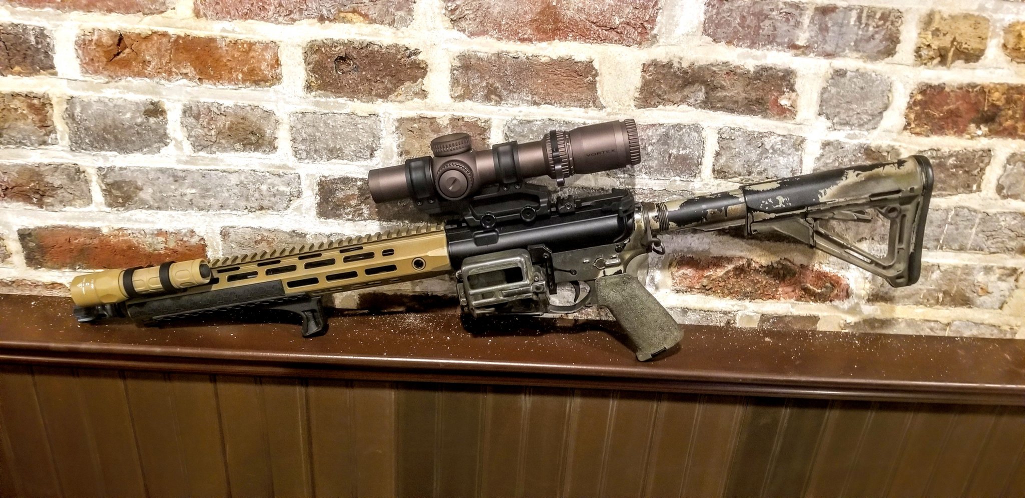

My 13.8” build with the Vortex RG3 1-10 (top pic). I’m going to run it next week and see how I like it. If it shakes out I may switch some optics around...
The RG3 was on my 14.5” 7.62 (2nd picture below)as I thought it was well suited for that rifle. It does work very well for it. After using it out to 800 yards yesterday, I noticed the center dot covers a great deal of the AR500 Silhouette. Still useable. So depending how it shakes out, I may move my MK8 H27D to my shorter 7.62 and get a MK5 for Green 7.62. If not, it’ll go back or I’ll buy another RG3.
feels good on the 5.56 though...
