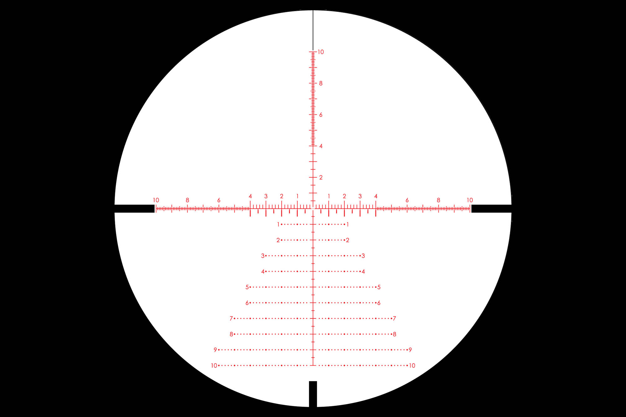

I'm actually looking at the 2D reticle.. it's a closed center. Thank you for pointing out the difference in thickness though. I thought it was more but couldn't really tell from the pictures.
This is the EBR-2D:
Reactions: Steel head
Where does it list the reticle dimensions? I just saw the pic. Just wondering what the line thickness are for it compared to the other two.
Just assuming it's using the same thickness as the EBR-2C.. guess I can shoot an email to Vortex and see what they say though. The picture is pretty low res and I can't really tell if they are super thick or not.
If the same as the 2C then you won't see a difference between the two. I have 2C and 7C scopes and both are plenty fine enough for precision.
This is the EBR-2D:
All you really get is .2 hash marks.
Holding halfway on .5’ and favoring one way or another is a breeze.
Both have .1 marks which I like for ranging.
So that’s a wash.
Thickness is a non issue as it’s so close.
Dot or crosshair?
A minor difference.
7115045
Reactions: marc.
