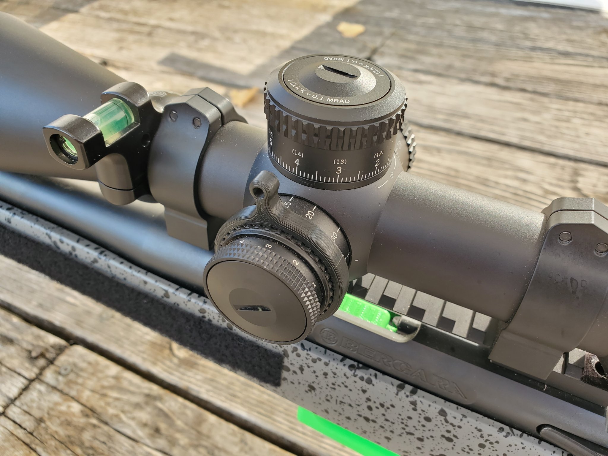

Picked up one of these scopes barely used in the PX this past week. A confession from a self-described scope snob (first time I've owned this tier of scope before). I'll admit, the turrets are pretty mushy (relatively speaking), but they align 100% with the hash marks on both E&W. A quick eyeball through the glass, and I'll admit I am pleasantly surprised for a $595 value scope.

OK Folks, I got the new SE 5-25 and have been doing a few tests with it. First I compared it to my old Athlon Helos BTR for glass quality. Hmmm, No Comparison! The SE was much brighter, better edge to edge clarity and had absolutely no image distortion I could find. The Helos by comparison showed quite a bit of image distortion as I panned the scope. I did notice some chromatic aberration but had to pick out some sever contrasting object to make it happen and only at high 20+ mag. Next, the truth stick, as T-Rex says. Reticle matched perfectly and turrets tracked to reticle out to 10 mils. Lastly, out to the range. At 100 yards, reticle still matched perfectly and was able to confirm shot placements to 6.5 mils elevation and to 4 mils windage.
I have not been able to confirm tracking accuracy to the limits of the adjustments, but so far seems to be spot on. Also, parallax is also good to go. It is not hyper precise but really close, like 110 indicated for 100 yards range. The only minor issue noted, as others have found, that when turrets adjusted about 1/2 way around they are about 1/3 of a click off and then line right back up upon a full rotation. Kinda weird, but if that's the only drawback, call me ecstatic. And got it for $609 on sale at SportOptics.
Reactions: Frankr
I just got mine and they are off exactly like yours (MIL version here too). They line up perfectly at 0, but start gradually misaligning as you turn and when you get to 4, 5, 6 they get further off until at 6 the line is right in the middle, and then at 7, 8, 9 they start to get closer to matching up. Same thing on the windage.
Guys, should I return it? I'm new to this, but it seems like not knowing if I'm at 6 mils or 6.1 mils would be a problem at longer ranges.
Mine is about 1/3 click off at 1/2 rotation and spot on at 0.
So looks like I got a dud. Got my strike eagle 2 days ago. Mounted/torqued it on my 22lr trainer. The mag ring felt really loose and easy to turn. It actually moves forward and back slightly (not turning, actual play forward and back). I got down behind the rifle and noticed that when I am 25x and back off the magnification slowly, the reticle actually jumps vertically. Took it right back off and packaged it back up to send back.

Quick question: the scopes with the misaligned turrets, are the actual adjustments off or just the turret hash marks? Mine has turrets that come out of alignment after around 2 or 3 mils of adjustment, and I'm debating if I want to unmount it or just shoot it and see what happens. With an infant my time to get to the range has disappeared for the time being.
I think that the turret markings are machined wrong, but I know a guy on here had new caps sent to him and it still didn't work. I would call Vortex and tell them you have the issue and they will fix it. The one I got back from Vortex is good to go. Its a known problem with this scope.
