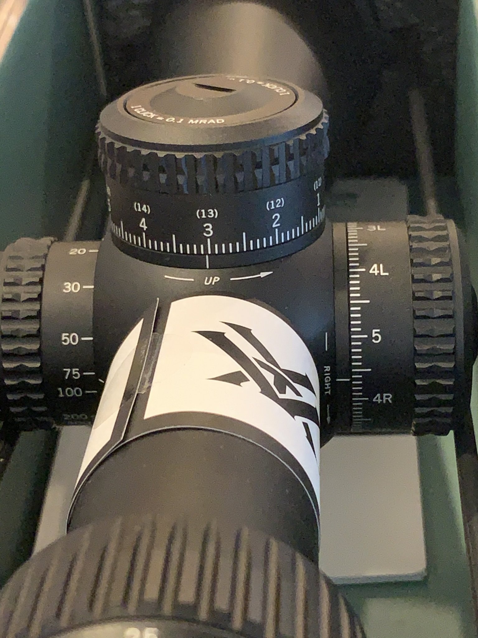

    So I bought a Strike Eagle 5-25x56 last week. Mounted(adm mount), leveled and torqued(Fix it sticks) the scope. Got down behind the rifle and adjusted the eye piece. Then came the issue... when I am at full 25x and I slightly rotate the throw lever, the reticle jumps. Its hard to explain but I can move the throw lever and I can easily see the reticle jump to the side(very little). This only happens around max 25x power.
    So obviously I call Vortex and they send me a new one. Just got it today and set it up again. This scope does the same thing. Does anyone have a Strike Eagle that they can test this out and let me know if I just got 2 duds or this is something that I would have to love with? I gotta send this one back anyways as the elevation clicks don't match up around 5-6mrad and then even back out.
    Also I know this is a Budget scope and I have many upper tier scopes. Just thought I could use this one for my 22lr trainer as it has a bunch of good reviews. I appreciate if anyone can confirm for me. Thanks
    Double duds just confirmed... so I did some more digging on threads and found that its a somewhat known issue in even higher end optics. People have reported the image/reticle shift on nightforce, s&b, kahles. And everyone reported no poi issues. So I was like "hey its a cheap optic and if it shoots I will just live with it". But the 2nd one they sent me has the elevation lineup issue, where it falls in between hatch marks from 4-6mrad. That i will not accept.
    So I pulled the 1st one out and sure enough this one does it too. Its weird because on both scopes its only the elevation that has this issue. The windage always lines up. And since this is going on my 22lr trainer, I don't want a scope I can't rely on.
    Oh and to be clear I am not bashing Vortex. I own 2 razor gen2, razor spotter and razor rangefinder. I love their stuff but the strike eagle...not so much. Its disappointing cuz everything else about the scope (glass, reticle, eyebox, etc) is pretty damn good for the price.

    For reference i found a detailed explanation regarding this issue. So I guess as long as i can find a strike eagle that matches up elevation hatch marks, I will be fine.
    #18
    Re: Reticle jump on FFP scopes?
    I spent time today discussing my issue with some scope manufacturers. I learned a few things that made me feel better, so I'll pass them along;
    1. FFP erector tubes position the reticle at the far end (furthest from the eye). Between the reticle and your eye are two adjustable lenses that move back and forth when the magnification ring is turned
    2. The fit tolerance between these two moving lenses and the erector tube is the root cause. The expensive scope manufacturers go as far as hand-fitting each lens, the other guys allow a bit more assembly tolerance.
    3. If one of these two lens is too sloppy in the erector tube, the reticle and target image will bounce or shift as I've described above.
    4. In <span style="text-decoration: underline">FFP scopes only</span>, both the reticle and target image shift at the same time and in the same plane. As a result, there will be no shift in POI or POA.
    5. Almost all FFP scopes exhibit some level of this bounce or shift.
    6. If you have this problem in a SFP scope, it does matter. SFP scopes place the reticle at the other end of the erector tube (closest to the eye). This design difference creates the potential for POA and POI changes.

    So I spoke with Vortex and they are going to hand inspect (1) and get it out to me by Friday. So hopefully I will be good after that. This is the main reason I really like dealing with them. I have always had stellar customer service and they take care of their customers.
    As long as the hatch marks line up I will be very happy with it. Like many have said, the glass and eye box is definitely impressive for the cost of the scope.
    Will do. I am sure Vortex will somehow find a good one, lol. There are numerous guys on here that have one, so I dont think it is a flaw in the scope. The guy did admit though that they have seen this issue with some of the strike eagles.

    Not the same issue but I just opened up one of my Strike Eagle’s that has been sitting in its box and the turret marking are terrible on this one that I have. Worse I’ve ever seen. Other issues present in this one too. Got a label from Vortex and sending back.
    I noticed this issue on a couple of the new Arken scopes. It took a bit of thought before I realized it’s really just an annoyance as the reticle is not actually shifting away from the target. Everything is moving (or appears to be moving in the ocular) together. One of those things that at first glance appears to be a nightmare but in reality is that it just looks bad. I got no POI shift. In Arken’s case, the diopter is has a touch of play when it’s screwed out to fit my vision. Once it’s set it’s not an issue. Just looks freaky if you grab it and give it a bit of sideways torque.
    Yeah I had never seen that in any of my optics before, so I was concerned. But after doing some more research it doesn't bother me that much since the entire image(with reticle) is what is shifting slightly.
    Now the marks not lining up is a no go though. I will update tomorrow as my "hand inspected" one will be here.

    Yep, I had the same issue with the elevation markings not lining up bewtween 3 and 6 mils. They sent me a new turret knob, did not change anything, so they took it in and got it back to me within a week and half. CS was great, I'll give em that, but I wish i didnt have to use it. But it seems like this issue is widespread with the strike eagle. It's a chinese mass produced optic, so I'm not surprised, and they take care of it, sooo. Not too mad. I compared mine next to the PST gen II and honestly I could not tell any difference in glass. I'm still glad I picked this up. Just send it back until you get a solid one. lol
    I got my 2nd replacement from Vortex yesterday. Took it out and both turrets match up perfectly. Parallax on all 3 of these are extremely stiff, but totally usable and will probably loosen up over time. I am gonna zero it this weekend, but seems I finally have a good one.
    So the Strike Eagle seems to be a really good scope for the money, IF you get a good quality one. I am still glad I picked up this optic.

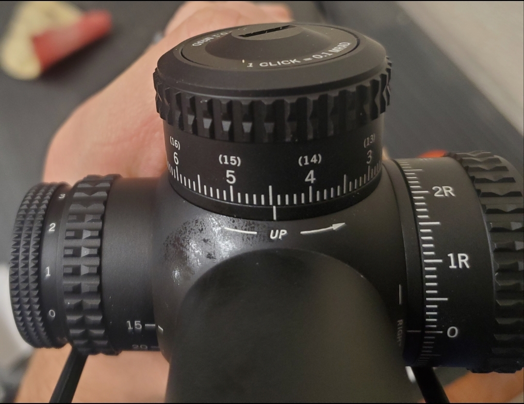

    Just pulled mine out of the box and dialed to 5 mrad...same issue with the turret not lining up. Thanks for this thread, saved me mounting it first and wasting a bunch of time.
    No problem. Hopefully Vortex addresses it and fixes this known issue. Even though it's a budget scope, this shouldn't be acceptable. And I had Vortex confirm they know about this issue.

    Happy to report my copy, purchased 12/2020 from a restock notification at Euro Optic, does not have the jumping reticle issue when zooming in/out. However, the hash marks on the elevation turret do not line up going beyond .8 mils.
    When you call Vortex, request them to visually confirm the marks line up on the one they are sending you. If not you could get another dud like I did the 2nd time around.
    Just wanted to pass along that Vortex took care of my issue with the turret markings. They sent me new elevation and windage knobs and they line up throughout now. Very happy with how fast they got the parts to me (5 days with a holiday in the middle) and the service rep was awesome. Can’t wait to get it mounted up.

    I just mounted a new Strike Eagle 5-25 mrad. Mounted on my 22, same as the OP. I don’t see any image shift at 25x going up or down in magnification. Tried small adjustments back and forth, 22-25x, 25x-22x but I don’t see any problems.
    Also ran the turrets pretty hard in each direction and looked for places they don’t line up. Several times I had a turret halfway between hash marks. But then I noticed if I wiggled the turret a little it would settle back on the right spot. These are not crisp turrets. Kind of squishy. So theres wiggle room on mine where I can push a turret to either side of the hash mark and it will stay there if I don’t move it back. I’ll have to do a box test to see if this affects anything that matters when shooting.
