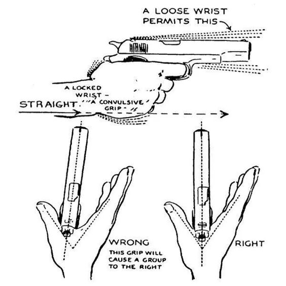

    I was never talking about canting the pistol. I was talking about gripping it in a way that points the muzzle off from the line of your forearm.
    The bottom half of this picture shows what I'm describing. That, plus likely poor trigger technique, is my guess as to what's going on.
